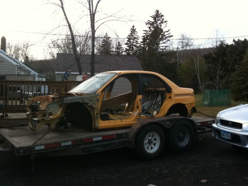

and .5L less displacement.... Quite a few hours put in and countless dollars and THE TAXI lives on in my RS. Got a few kinks to work out (throwing a TGV stuck open code) and a few other things but its alive! The Taxi being hauled away

Actually he did see it, matt is my best friend. He helped me swap a bunch of stuff from taxi to my new one. We knew lots of stuff was messed up. But good to see it lives on
