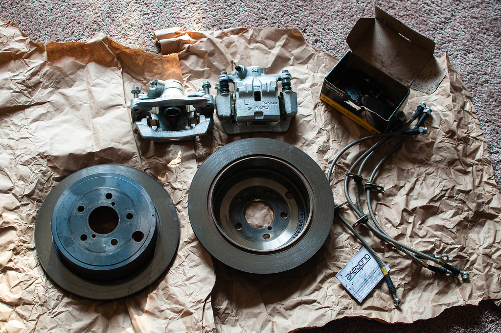

  16. fancyfootwork15
    211
    Had some goodies show up today. All of these have under 3,200 miles on them according to the seller. Got them pretty much free too!
    Anyone want to give me a hand?
    New Brakes by Fancyftwork15, on Flickr
    Jerf likes this.
  17. boone1186
    boone1186 Active Member
  18. fancyfootwork15
    211
    Anytime really. I just need to make sure I have all the parts! Either just backing plates left or the entire assembly.
    Jerf likes this.
  19. boone1186
    Well I'm always up for helping. Let me know.
    fancyfootwork15 likes this.
