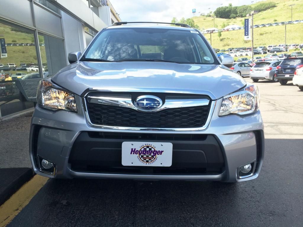

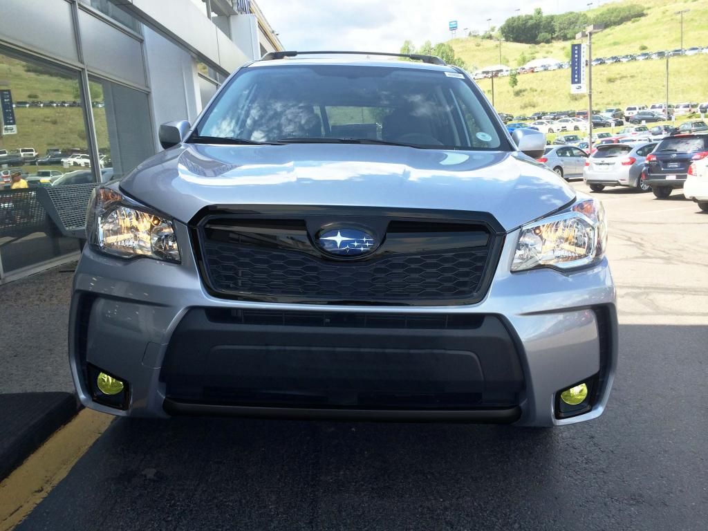

    Got rid of my WRX for something with more room and ended up with a 15 XT in Ice Silver. A few small things completed with a few more planned.
    Hello all-
    2015 Forester XT Premium- Ice Silver
    As it sits right now: NEW Stock

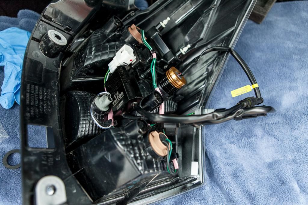

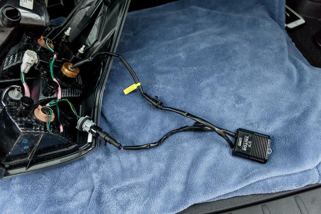

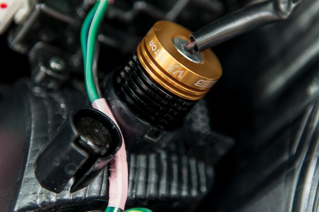

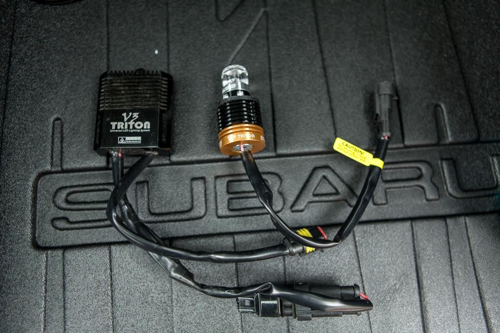

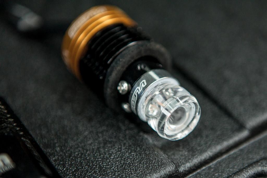

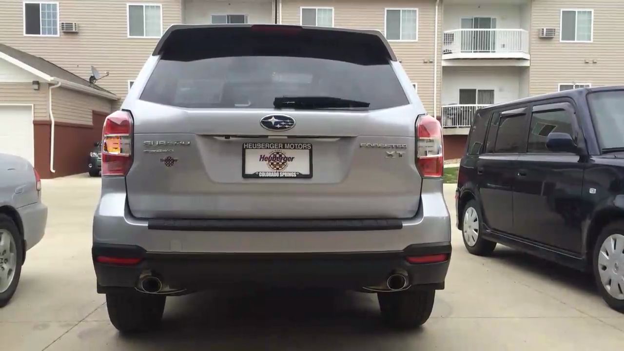

    VLED Triton v3 Rear Turn Signals: Hands down the best LED system to plug'n play for LED's. Build quality is second to none and they are versatile and can be converted to fit many different sized sockets!
    Got around to installing these this afternoon. I didn't get the fronts done as I assumed they had the same bulb as my WRX. New adapters are on their way to get the fronts done next.
    Install was super easy. Only nervous part was wondering how I was going to mount the ballast as my WRX had a huge opening down behind the bumper cover, not so much with the Forester.
    VLED Setup
    LED Bulb
    Ballast and bulb wired up
    Bulb in the socket
    Ballast Mounted with heavy duty velcro
    VIDEO: Sorry I don't know how to insert Vids here and have them play here.
    LEFT Stock bulb + RIGHT vLED
    Both LED
    Close up

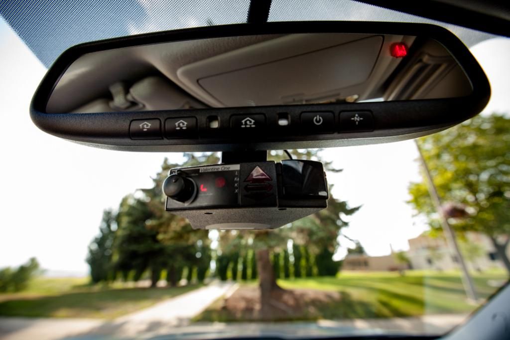

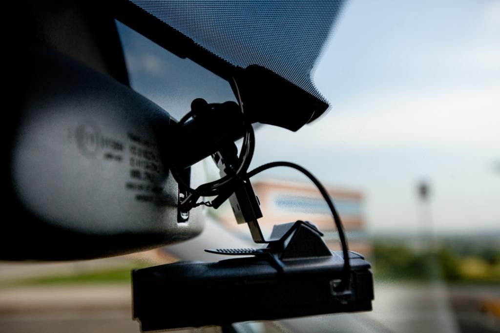

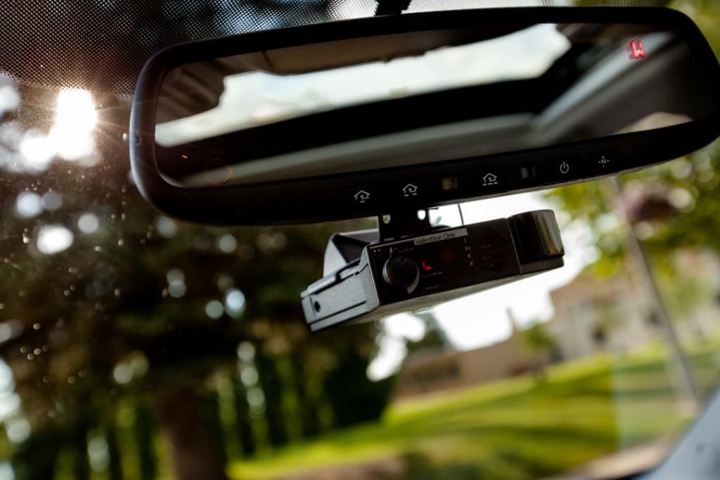

    Valentine 1 Blend Mount + Mirror Tap Installed

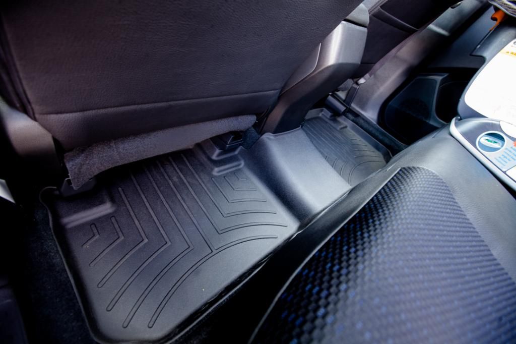

    Weathertech Digital Fit
    These fit snug, much more so than in my wifes 09 and my WRX.

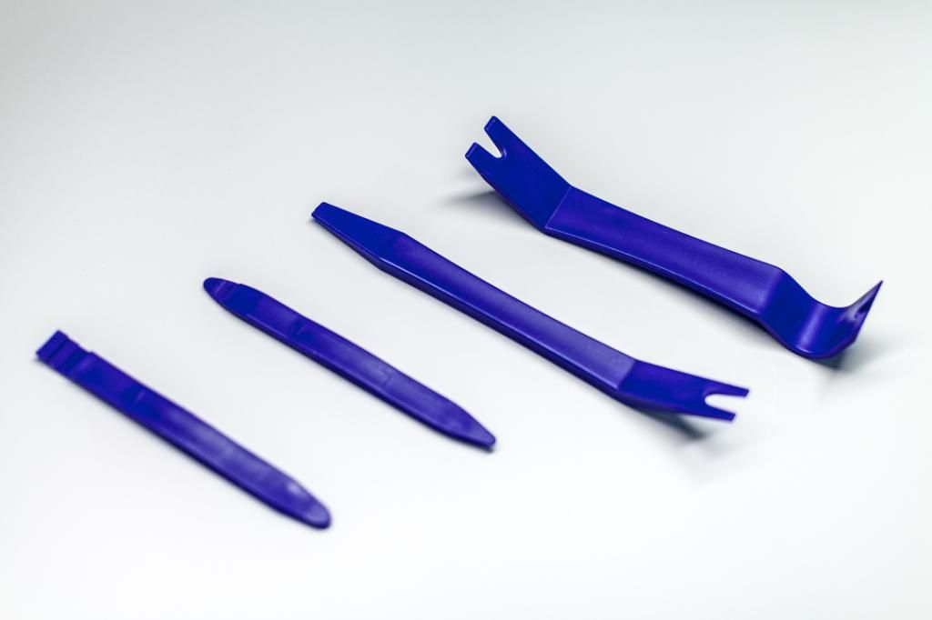

    Trim Tools

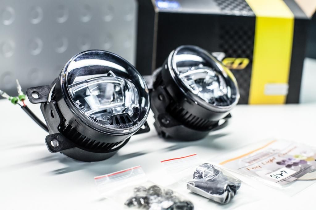

    Morimoto XB LED Fogs (Type S)

    Tools
    Hair Dryer
    12" x 12" piece of vinyl (I used half for each fog surround so each on took a 6"x12")
    Plastic Trim Prybars
    Sharp exacto knife
    Removing trim pieces from bumper
    a. I used a thin plastic pry bar and pried on the top (prying down) of the fog surround until it popped (very light pressure) then the bottom (prying up) and it popped out very easy.
    b. Take your time and work the plastic clips on the back side to separate the chrome trim piece.

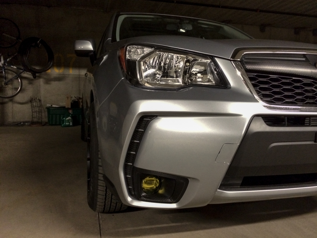

    48

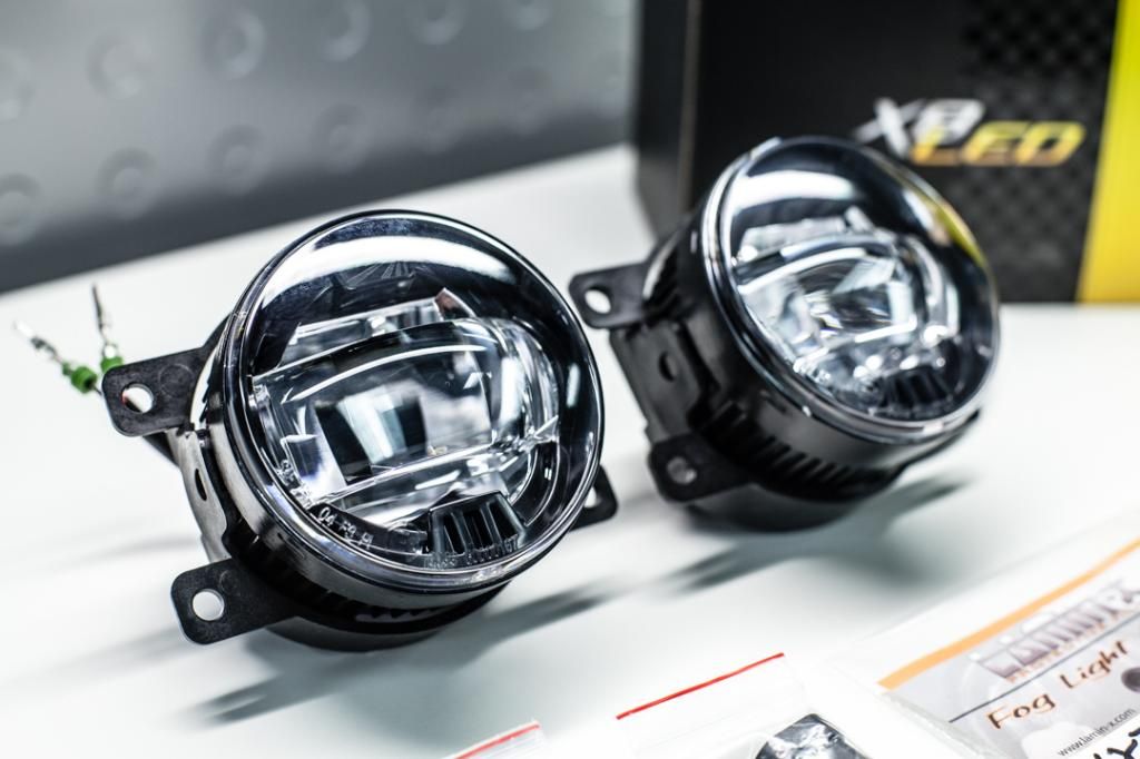

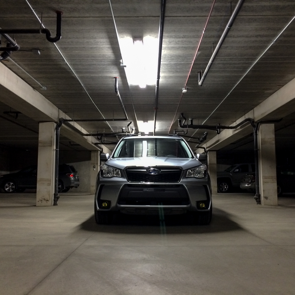

    MORIMOTO XB LED FOG LIGHTS WITH LAMIN X FILM
    These things fit perfect!
    Output wise, they are pretty close to OEM, just a different look. They definitely don't look as bright as the subispeed HID's however these fit the housing much better than those it seems as no gasket is needed to seal the housing.
    Overall very happy with them!
    Tools
    10MM Socket
    Phillips
    Very short or 90 Phillips
    Flat head/Trim clip removers
    A Blank Wall for aiming
    Once the fog surrounds are out (see above) it is time to pop out the oem fogs
    1. I undid 5 Clips on the bottom
    (3) holding the front splash guard
    (2) larger ones connecting it to the bumper
    (1) 10mm or Phillps Screw
    *Sorry no pics it was really dark in my garage. It's pretty self explanatory once you get under there
    2. There are only to things holding the fog light into the housing. A bottom 10mm and a top plastic phillips clip
    3. They are really easy to aim, you can tell where the light output is on the horizon, I had to aim mine down a bit from how they came.
    Fog light housing
    Top Right is the back side of the plastic phillips clip and lower right is the 10mm screw
    Left side is only held in by slits in the housing, no screws needed.
    Fit
    Fog Surround back in
    Stock Front End
    Finished front end [​IMG]
    Output: EXACT same camera settings in both shots
    Stock
    XB LED
    Nhibbs likes this.

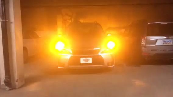

    Triton V3 VLED Front Turn Signals
    A ton of room to work from above compared to my WRX!
    These are wicked bright, same as the rear turn signals.

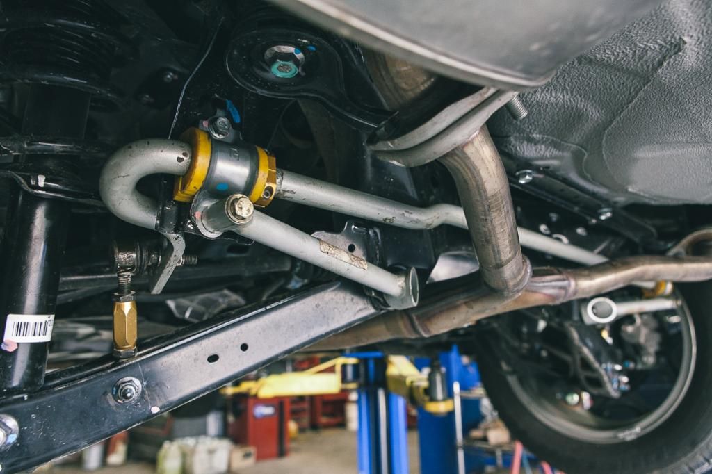

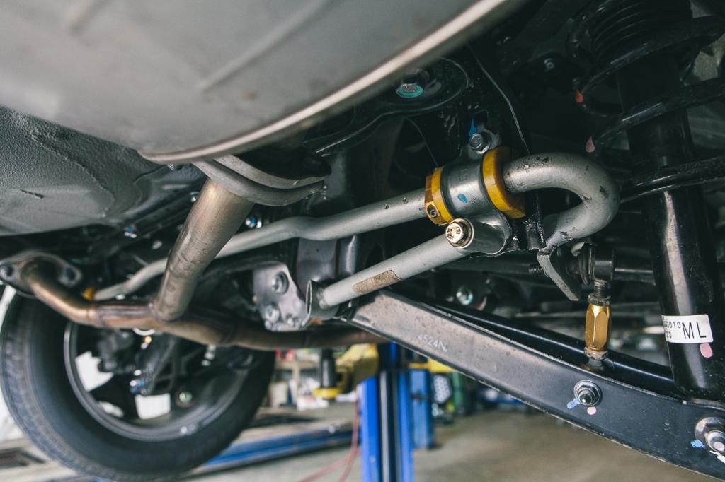

    WHITELINE 22 MM ADJUSTABLE REAR SWAY BAR AND ENDLINKS
    I have it set on Medium and first impressions are decent. It didn't make as big of a difference on the forester as it did on my wrx, but that is to be expected with a bigger vehicle. It was noticeable however with the back end really following you through the turn and a slight feel of under-steer wanting to happen.
    I may set it down to soft and see if it feels more neutral but happy so far with the choice.

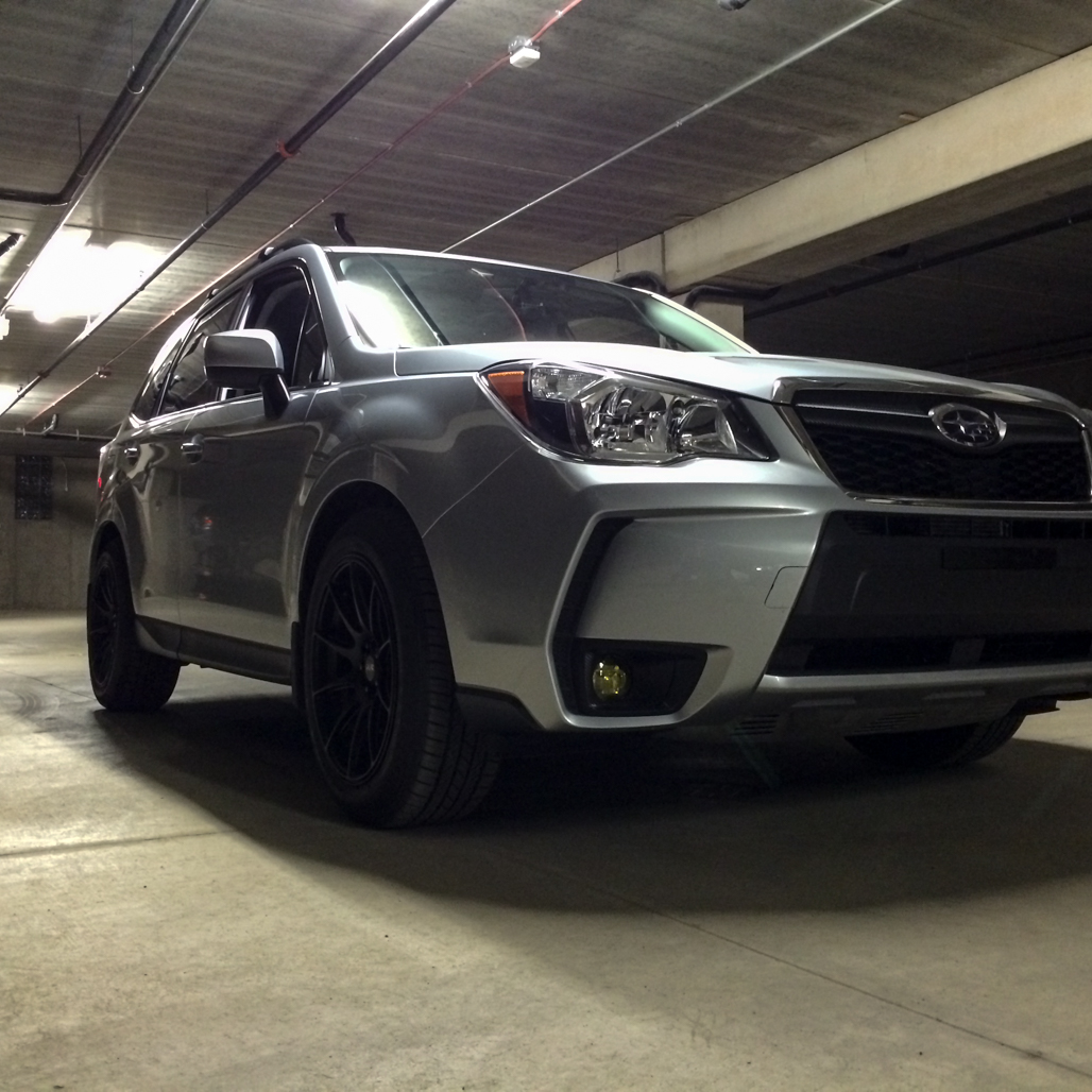

    New to shooting vehicles, I have shot a ton of weddings and people but cars are new and I am addicted to learning now! Wanted to get some shots with the 50% tint up front and the full stock setup before new shoes and drop tomorrow.
    Also in big news, I am headed back to the cities to live! Can't wait to meet you guys and see more of you around!
    EricS, JuStaWRX, boone1186 and 2 others like this.

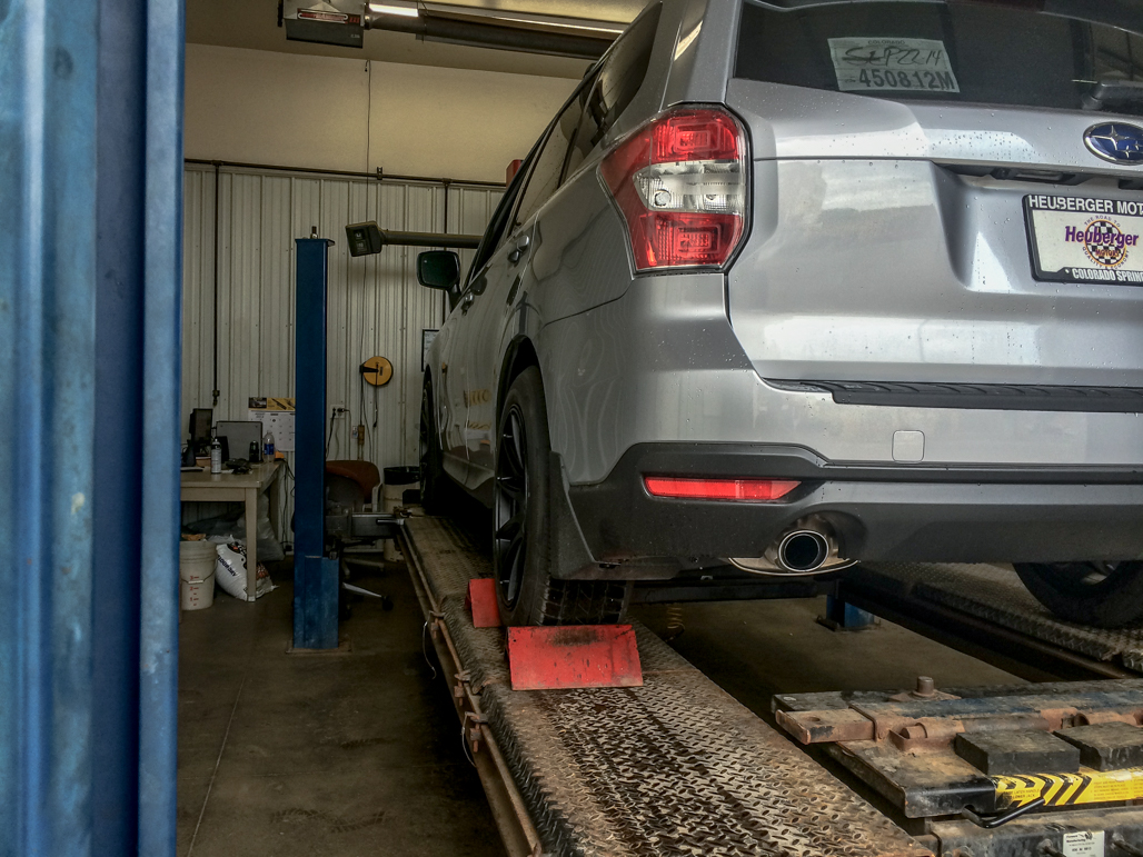

  34. Schlanseay
    Schlanseay Well-Known Member
    48

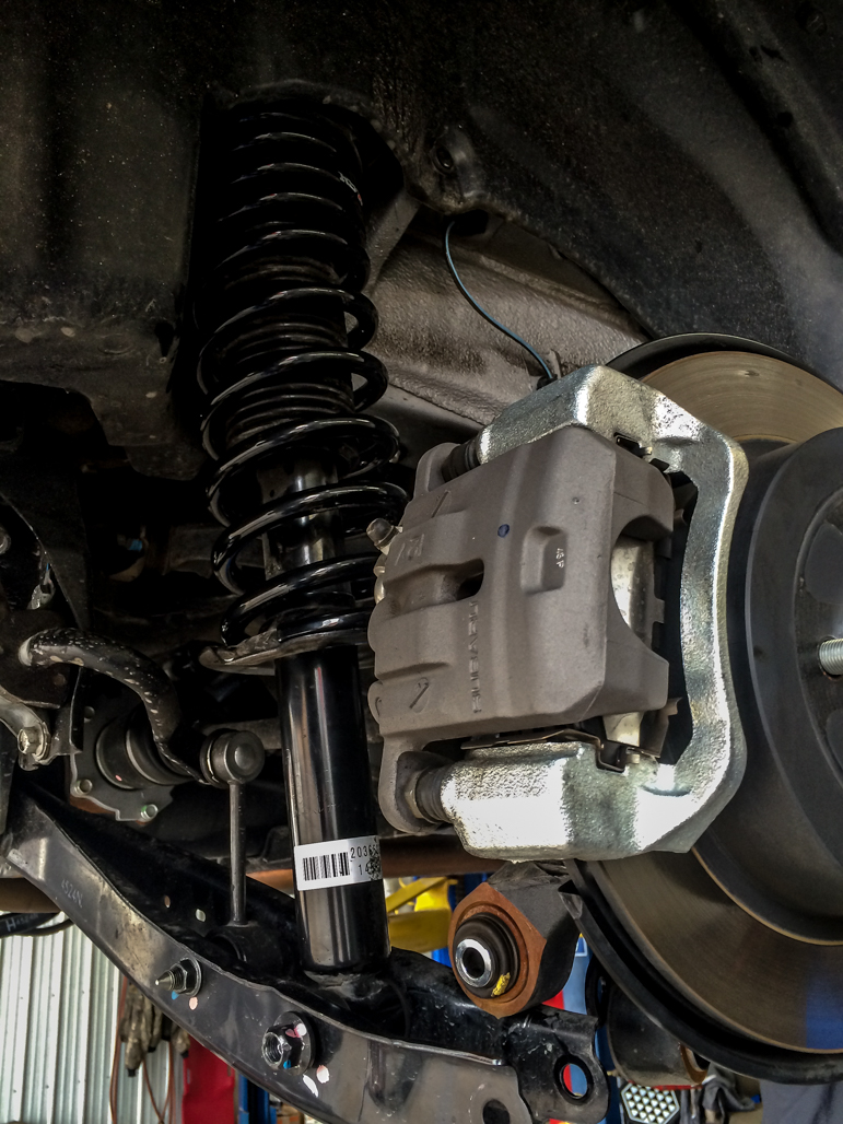

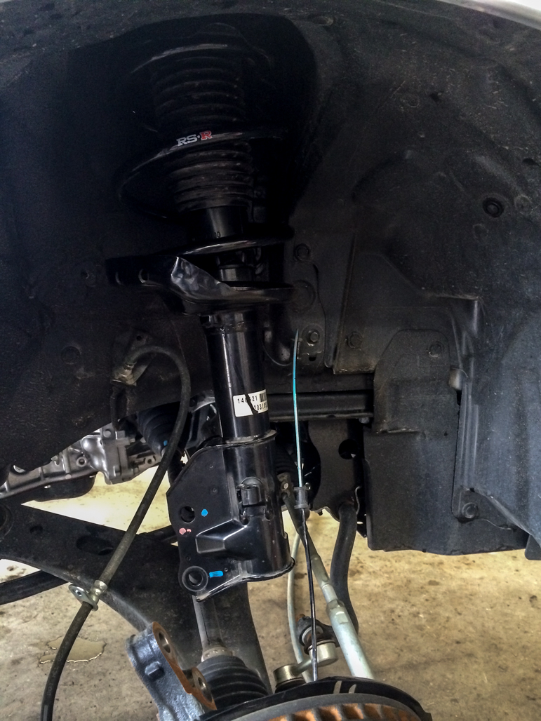

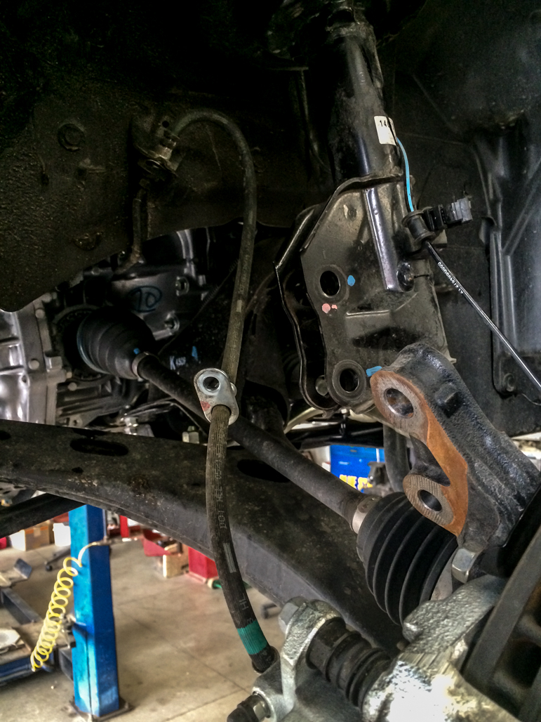

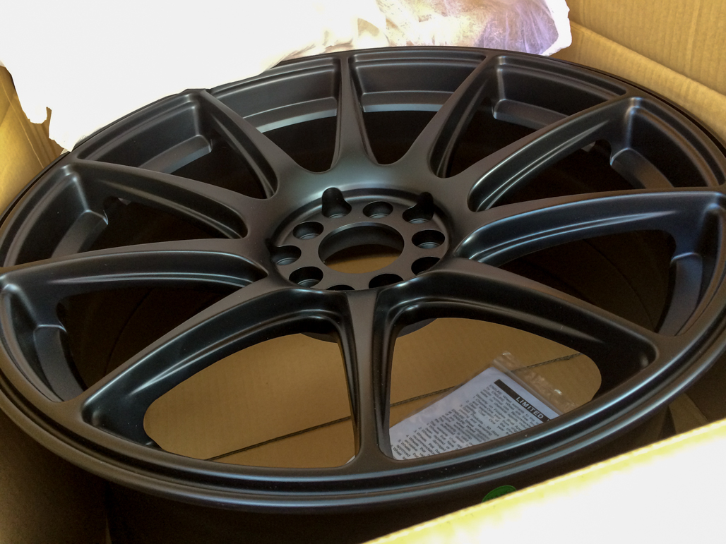

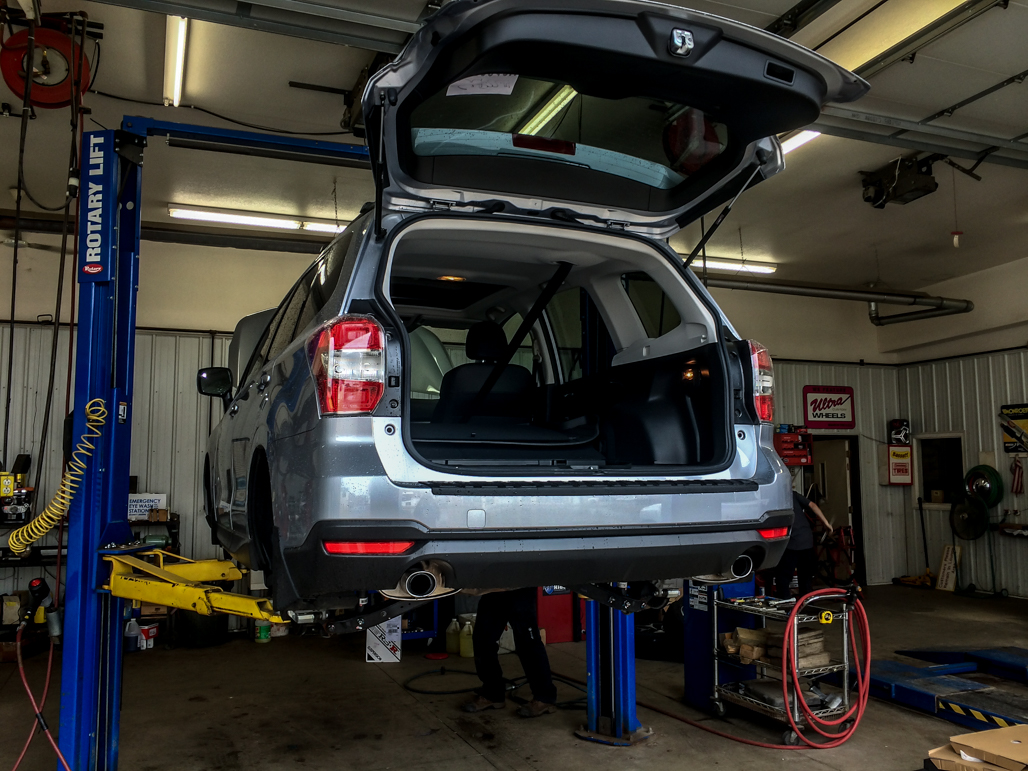

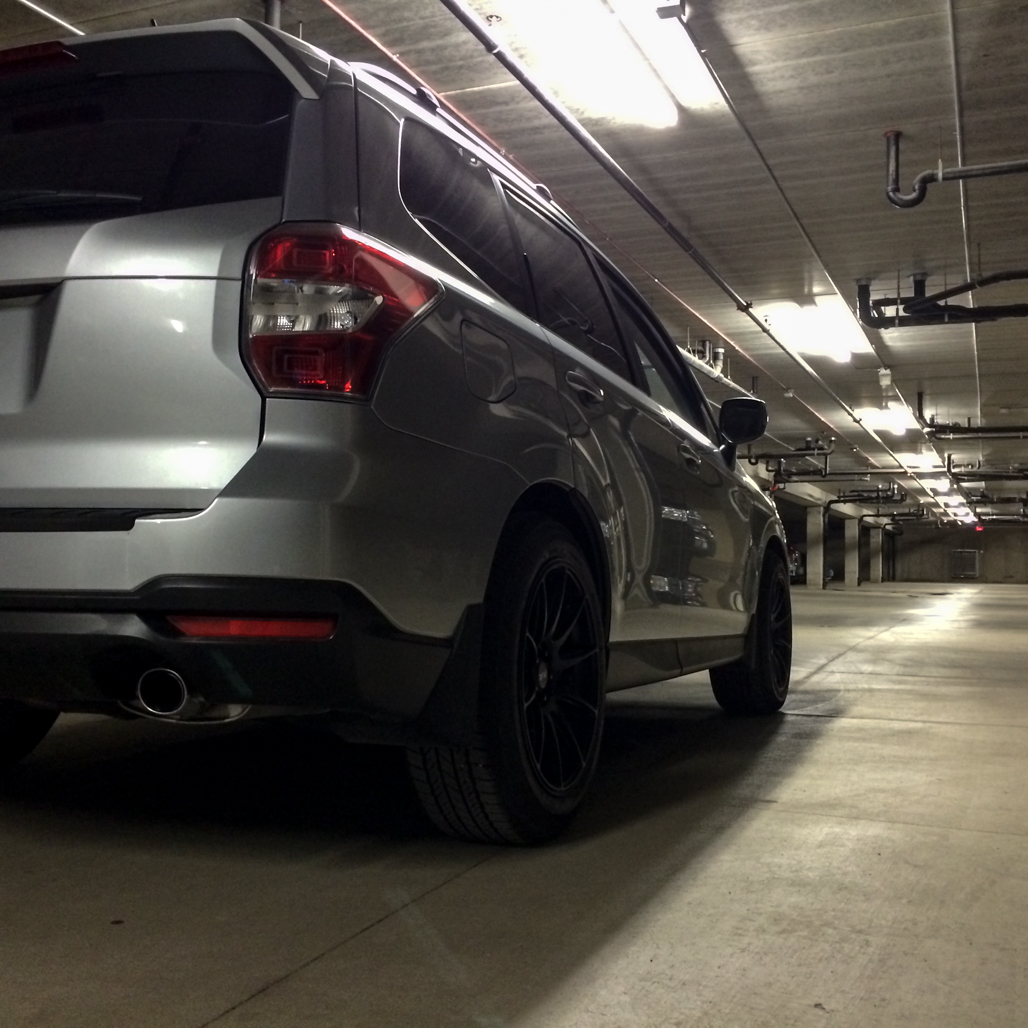

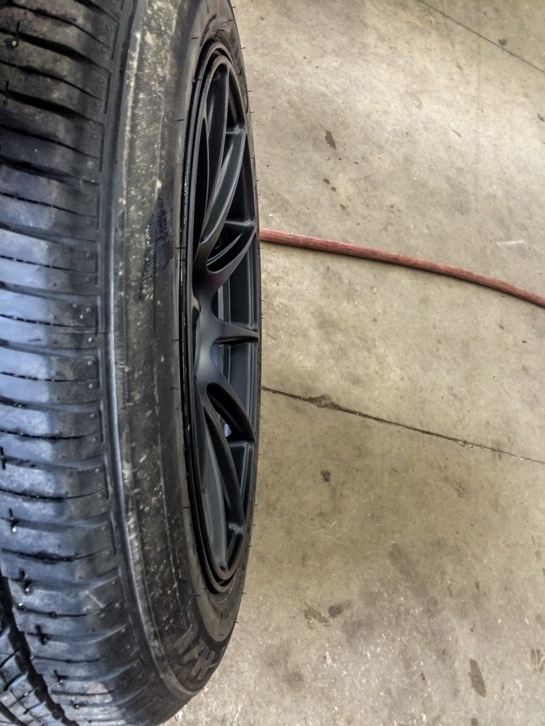

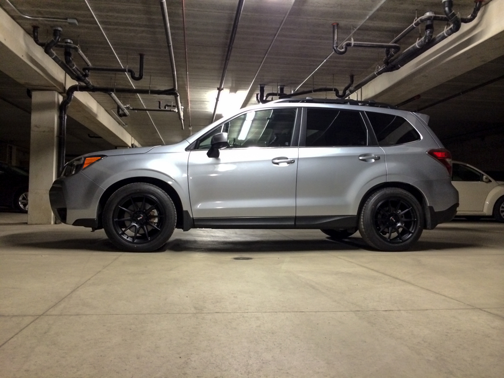

    RSR DOWN LOWERING SPRINGS + XXR 527 WHEELS
    XXR 527 Specs
    18x8.75 +35
    Tires: Stock 224/55/18 *Future: 255/50/18
    I was pretty anxious to see ow the oem tires fit on the 8.75" wide wheels and how the offset paired with the forester. I am not a huge fan of the stretched look and didn't want a huge poke. The setup is pretty aggressive for me but I like it and doesn't look as bad as I imagined it with the stock tires. The rear tires sit about flush and the front poke out about 1/8" with this setup.
    Install
    I didn't do much of the install on the springs as I had some buddies do it at their shop. Everything seemed to go really easily. The only fussy part was getting the rear shock assembly out, as we had to unbolt the sway and lower control arm to get it out but that wasn't difficult either.
    Ride
    The ride feel same as OEM with slightly less of a "top heavy" feeling from the OEM springs. It is not a harsh ride by any means.
    Here are some iphone pics until I get go out and take real ones!

  41. tangledupinblu
    When are you going to CF/wrap out the rest of the chrime on the grill? I like the look of the photochop that you did! Doooo it! Lol
