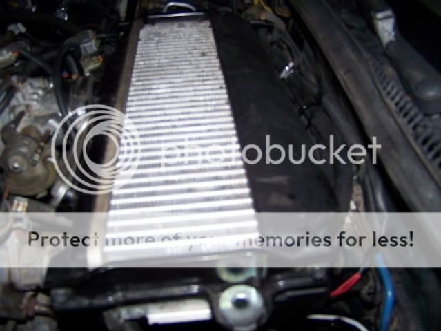

    Finally got it all squared away, only took about 3 days total. Spent more time running around getting the stupid misc parts that i needed. But all and all wasn't to terribly bad. The intercooler needs to be modified to fit, i tried one from a 02, way too tight, finally went with a 07 style. Still needed to trim about 1/4"+ off the end of the intercooler to get it to fit.

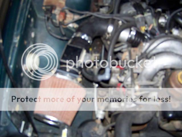

    and for the air intake, i just used the stock one, cut it in half where the breather hoses come into it, and flipped it around and got one of those adapters to mount a cone filter on it.

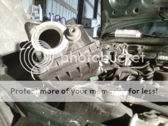

    first ram air setup to test, should be capable of at least 1000 hp
    1000 hp was a little much, so i changed my mind to this

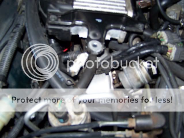

    showing how tight the fitting is for the turbo/lines/wires (and MAKE SURE anything that may melt is pulled away from the dp my o2 wire housing melted)

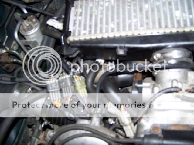

    what little space the TMIC has to fit into

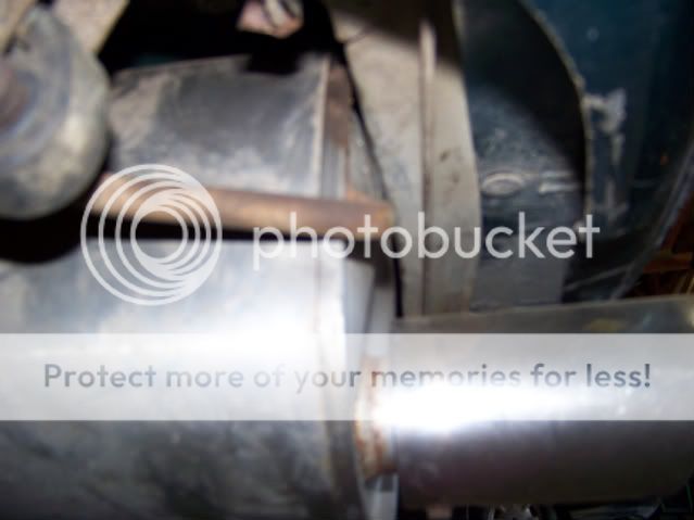

    how tight the exhaust really is

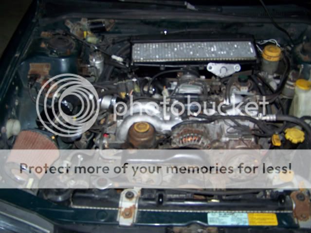

    pictures of the finished product

  2. PaulasaurusREX
    Sweetness. Glad to see its up and running. Good work! I think "tight" is an under statement on the exhaust.
    '07 intercooler :biggrin:

    thanks for the correction, ill update that..
    and yeah that was the biggest pita, i failed to mention i had to cut away some metal and bend the crap out if it to make it fit back there. but a floor jack solved that problem..

    Nice! I am glad to see that it is up and running. I am guessing that this was quite the learning experience, I know it was for me the first time I did it. Just a couple things, make sure your oil return line is safely away from the exhaust manifold. It is kind of close running a UEL header not too sure on the stock one. Also it would be a good idea to occasionally check that TLeg 90* intake piece for cracks, not a huge issue but that piece of rubber is over 15yrs old now.
    The exhaust is a tight fit because the uppipe mounts the turbo about 1.5" back towards the firewall. This is the same reason it is a nightmare to get the DP in and out. However if the turbo was located exactly in the stock position you would not be able to get the intake pieces on.

    and that oil return i wrapped it with a bunch of heat resistant stuff so i hope that keeps it from melting. and that 90* pipe i cut all the inlets off of it, jb welded and put rtv sealant over the jb weld then metal taped it, then duct taped that.. so there "shouldn't" be any issues with cracks.
