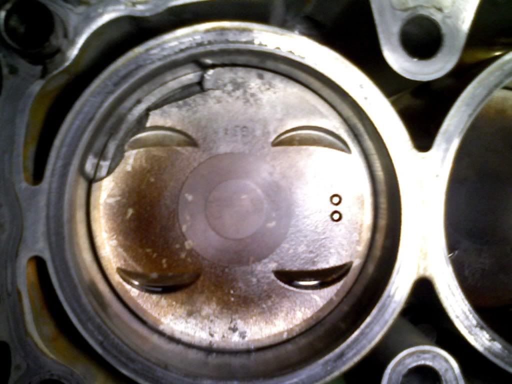

And yet I don't miss that turbo RS of mine at all, every day wondering if this was the day I was going to shred the transmission. Oh wait I do miss it
It still ran, with part of a piston. Furthermore that piston was completely washed? cracked head perhaps?
My guess is that it exploded into small enough pieces and passed through the valves and through an opened wastegate
