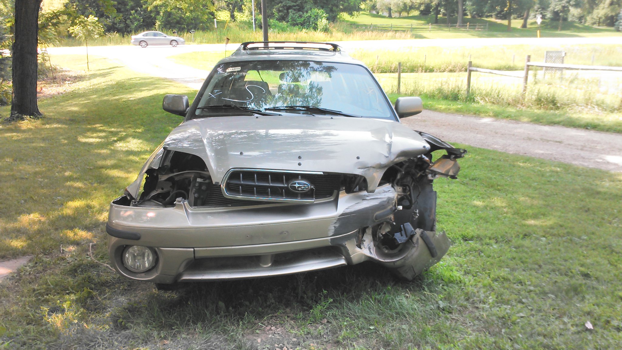

    The bad....
    [​IMG]NCM_0448 by Numbchux, on Flickr

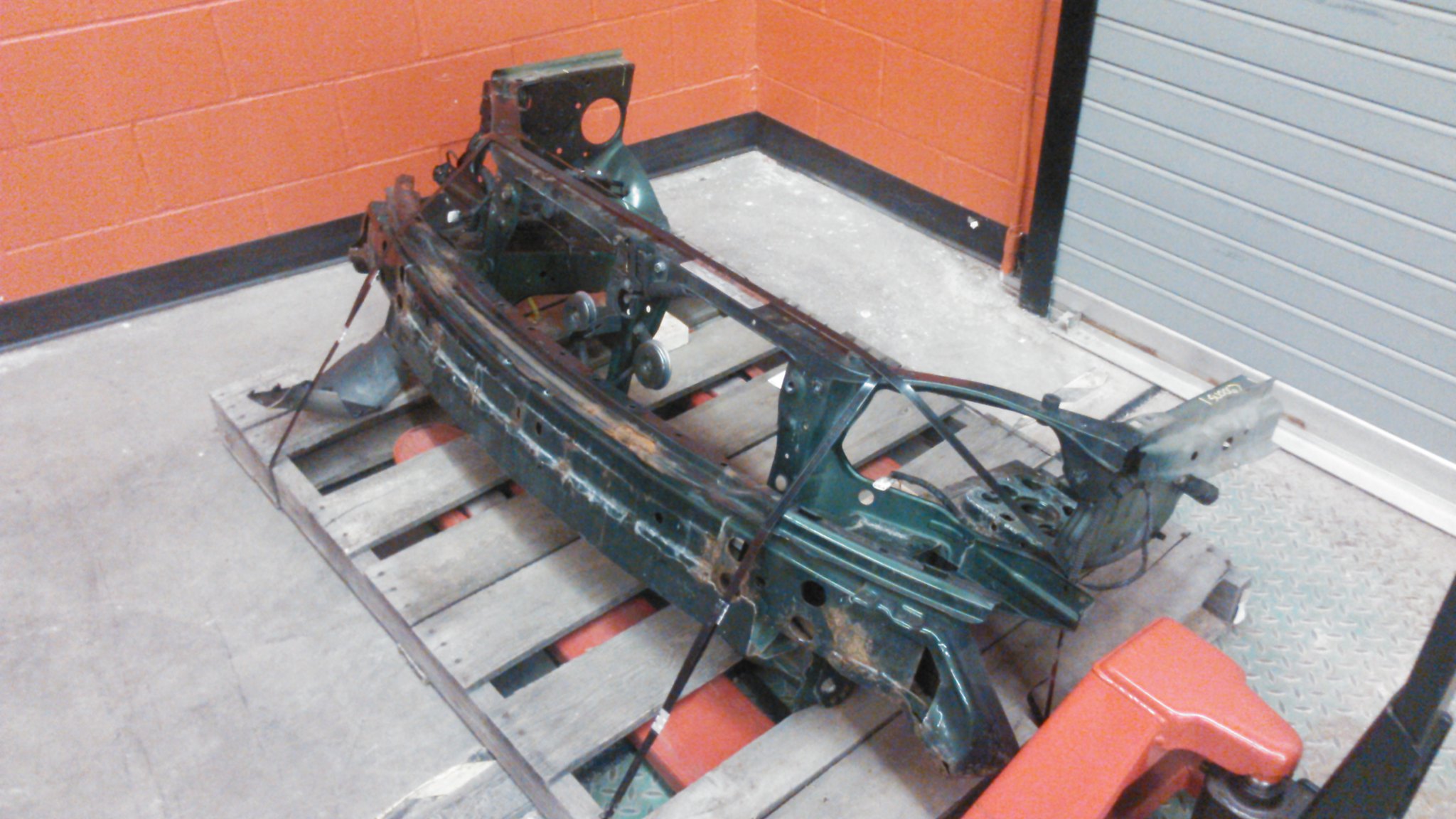

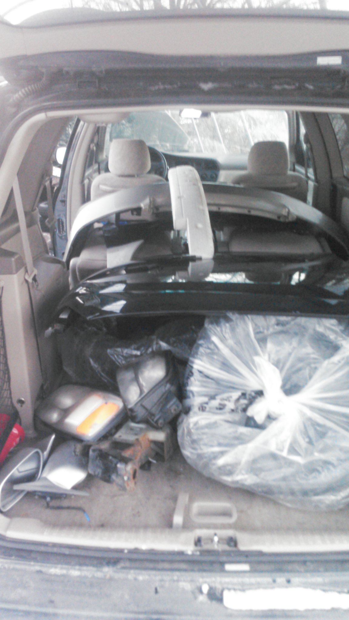

    But thanks to Oak Leaf Auto Salvage for this:
    [​IMG]NCM_0810 by Numbchux, on Flickr
    And UPull for much more:
    [​IMG]NCM_0802 by Numbchux, on Flickr

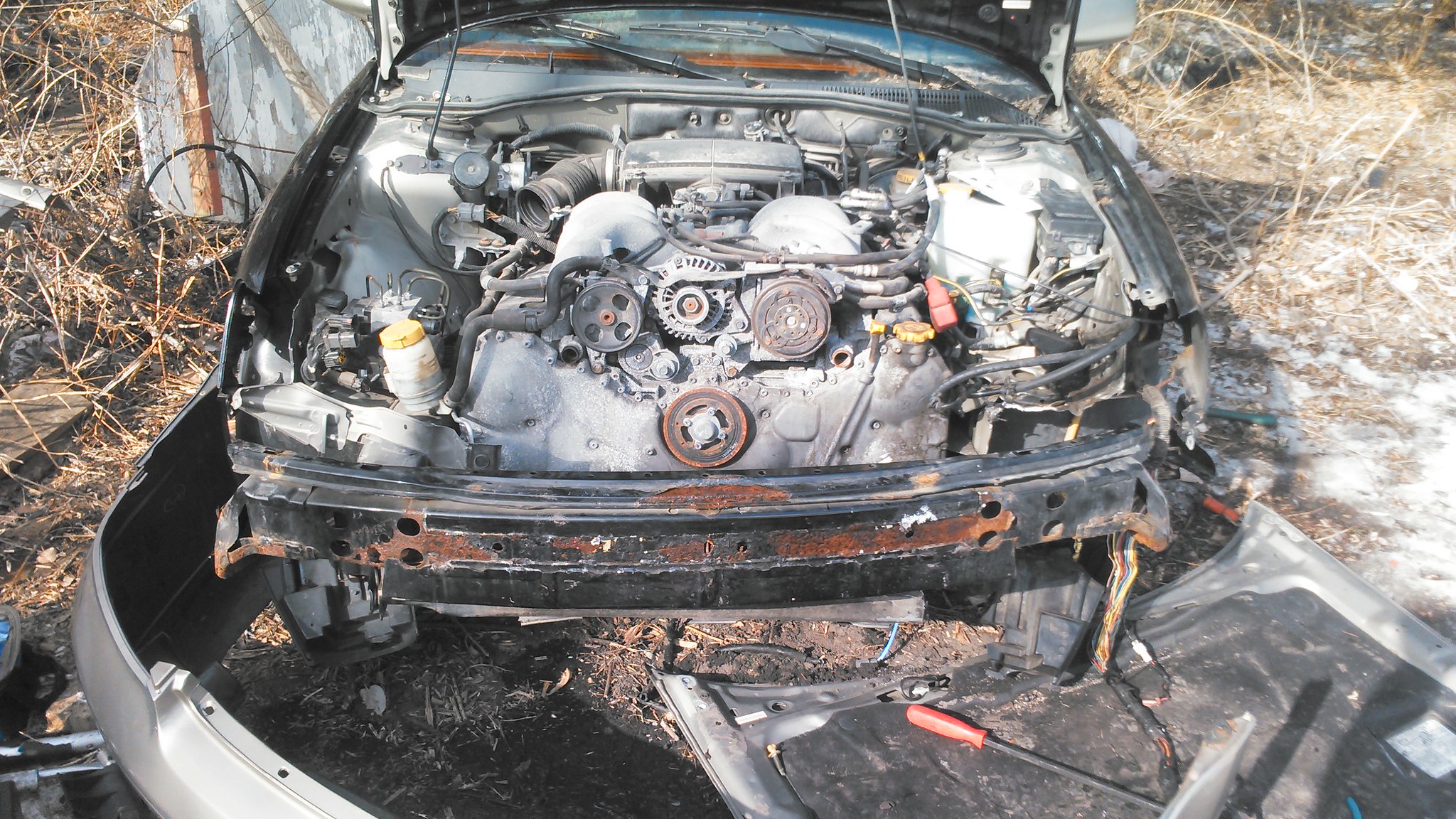

    Cut most of the bad off:
    [​IMG]NCM_0839 by Numbchux, on Flickr

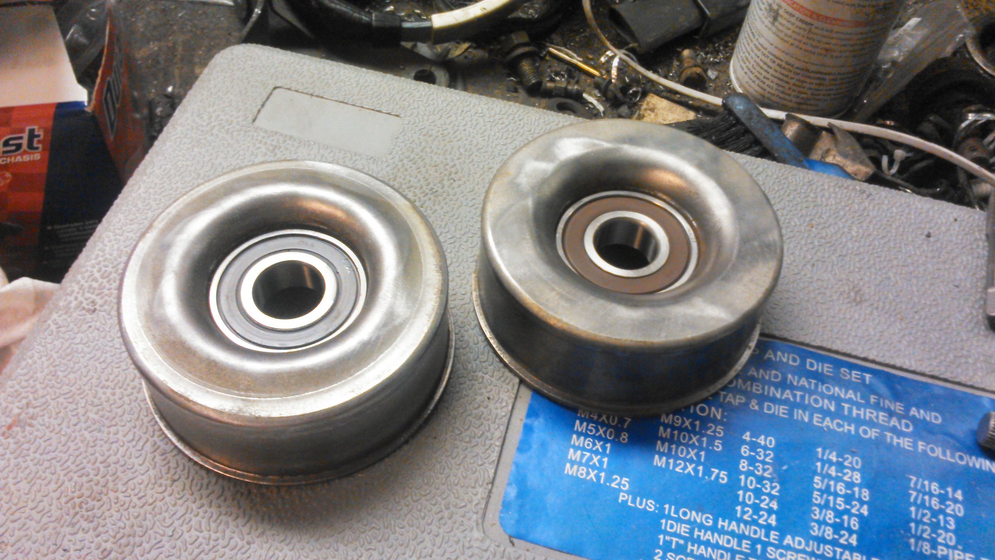

    Pressed new bearings into the serp belt pullies:
    [​IMG]NCM_0854 by Numbchux, on Flickr

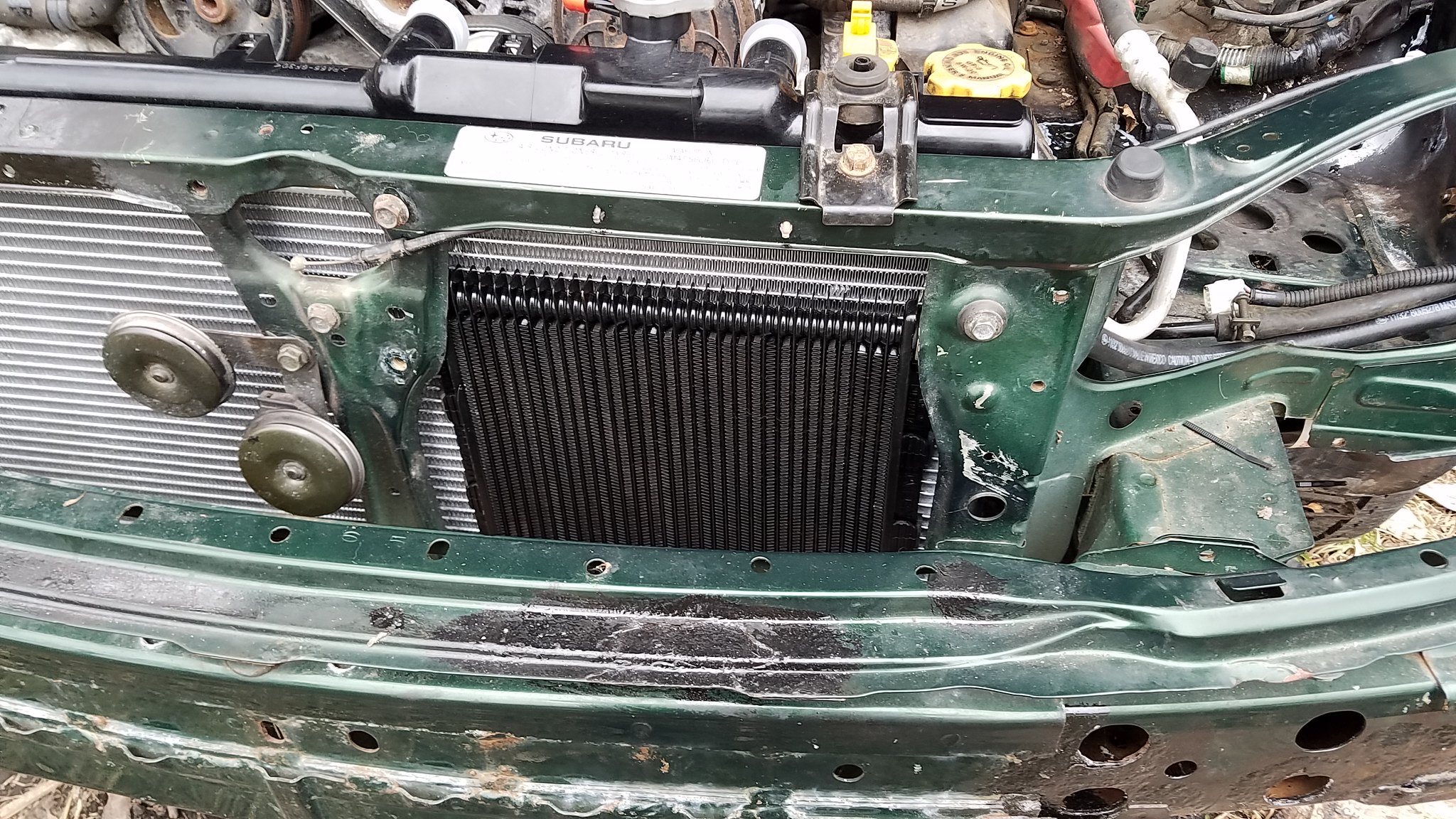

    Added an auxiliary transmission cooler:

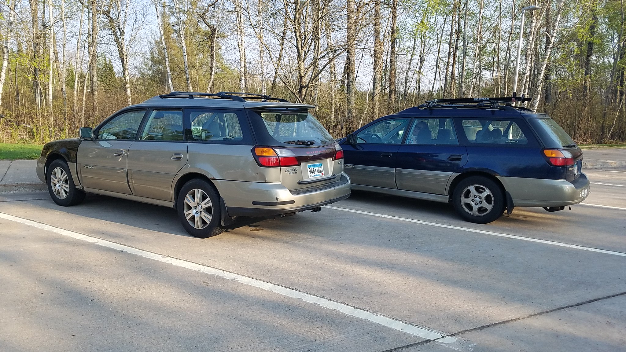

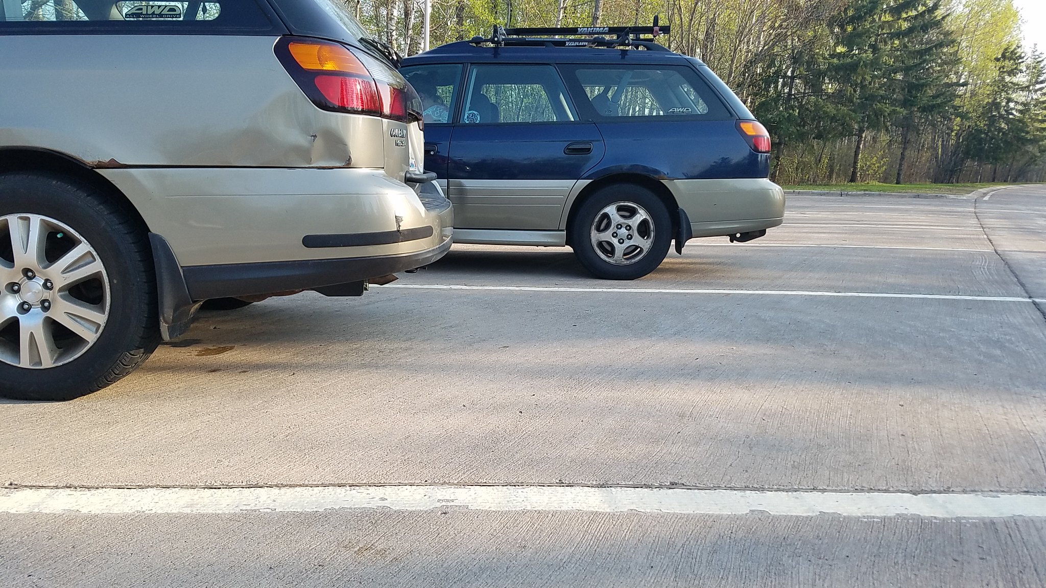

    Got a ride down to my parents' place yesterday, and threw the trailer hitch on it before heading home. I took a few pictures at a rest stop next to our '03 4-cyl Outback:
    [​IMG]20160508_182200 by Numbchux, on Flickr
    [​IMG]20160508_182216 by Numbchux, on Flickr
    More direct comparison shots of the Subaru vs Reese trailer hitch. The Reese one is the only one of the aftermarkets (that I saw...) that goes over the exhaust like the Subaru one, instead of under it. It's also rated higher (above the towing rating of the car), and is much cheaper.
    [​IMG]20160508_182229 by Numbchux, on Flickr
    [​IMG]20160508_182245 by Numbchux, on Flickr

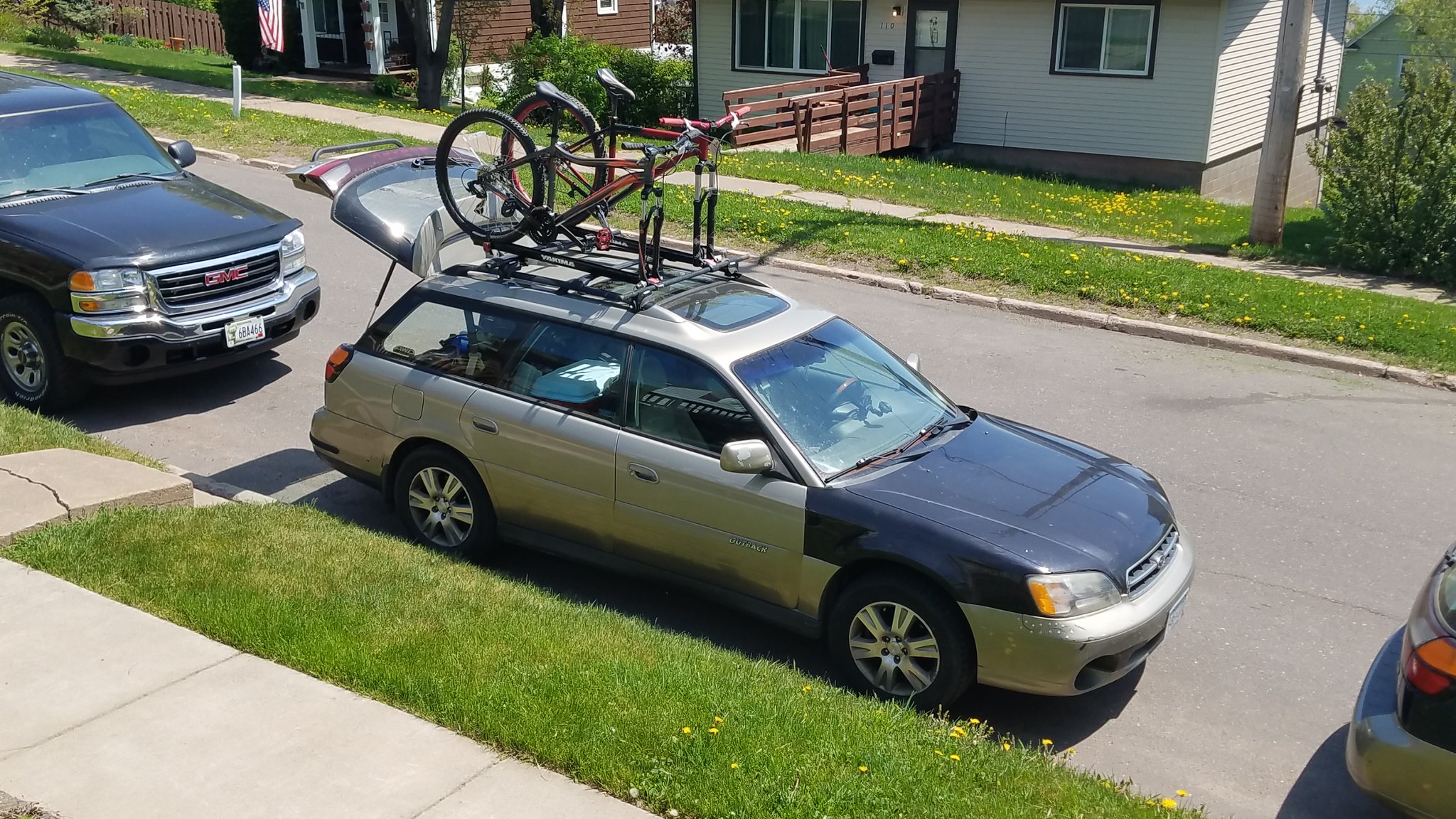

    Top tip for rear hatch clearance...mount the bike racks in the opposite direction. I've had to do that on about every Subaru hatch/wagon that I've owned.

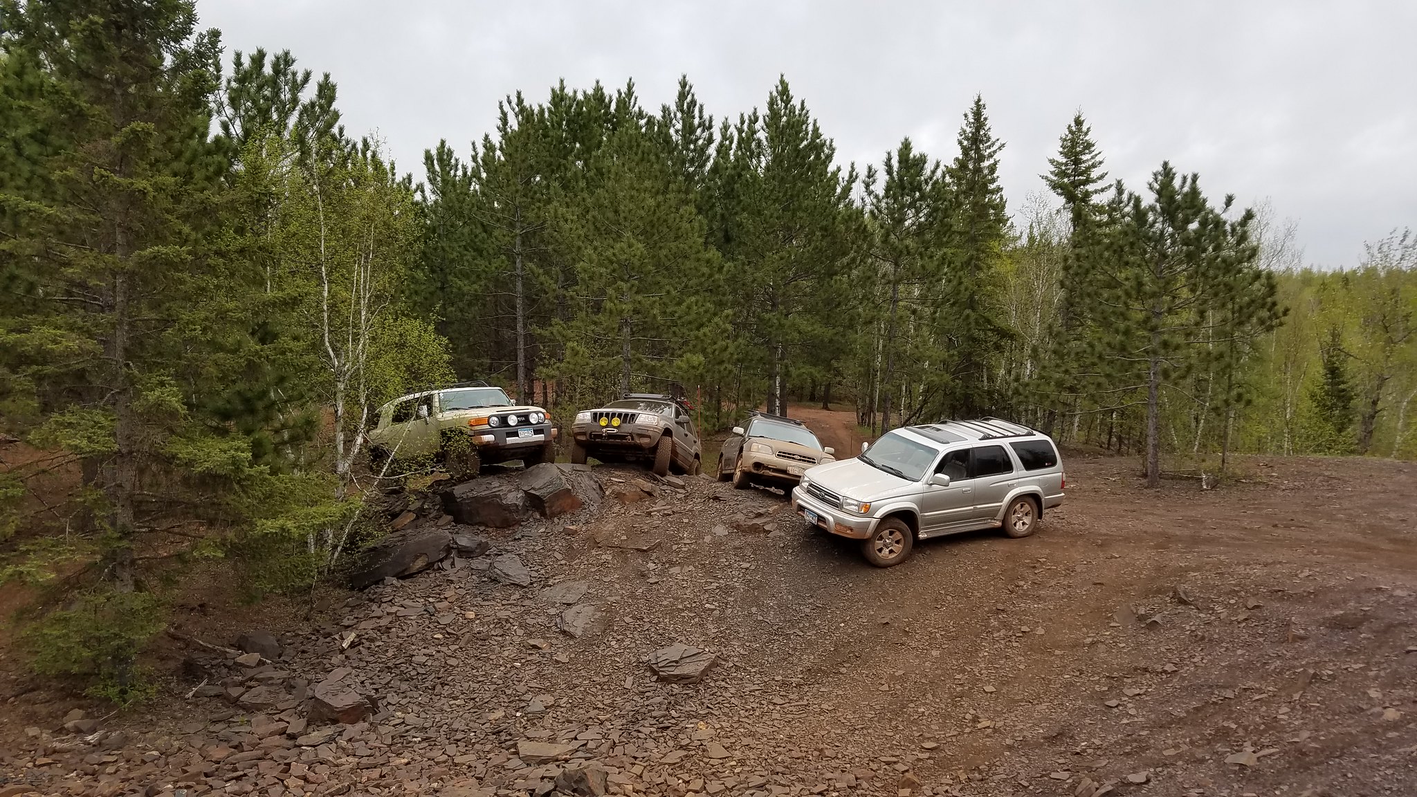

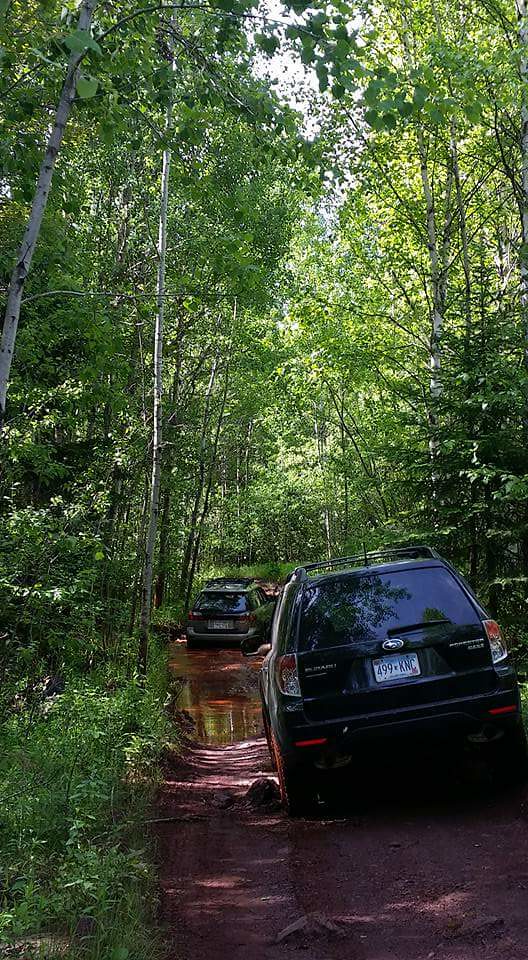

    Martin was anxious to bring it up to the OHV recreation area in Gilbert, in northern Minnesota. Several members of the Ziptie Rally Team have some 4WD vehicles, with varying levels of experience, and eager to try it out, so we gathered a group of 5 vehicles and went up.
    I left straight from work Friday afternoon, and drove up to Hibbing and stayed at a friend's house. And we all left early Saturday morning to head over to the park.
    Our group:
    [​IMG]13418373_10100460104149457_7171720721831413890_o by Numbchux, on Flickr
    I was in the Outback (obviously), with by far the most experience up there. The the WJ Grand Cherokee (Tall Dan) has been there a few times. The other 3 drivers were completely new. Jeep had by far the most suspension travel, but open diffs. FJ Cruiser (Dan Drury) has rear locker, and Atrac traction control. Forester has a lot of ground clearance, and good tires, but is a manual transmission, so he had a serious gearing disadvantage. Obviously the Outback has a ground clearance disadvantage, but the VTD 4EAT did excellently. And the X5 (Jesse) was cranked up into it's highest ride height, which left a ton of ground clearance, but virtually zero travel, and low profile tires meant the AWD system was working hard, but it still did well.
    Being that I had the most experience and the least capable vehicle, it made sense for me to lead. So, I did:
    [​IMG]13413005_10107744258730360_6110313075677664850_n by Numbchux, on Flickr
    I dragged the exhaust and the trailer hitch over everything...
    [​IMG]13413773_10107744257996830_7770212468363781785_n by Numbchux, on Flickr

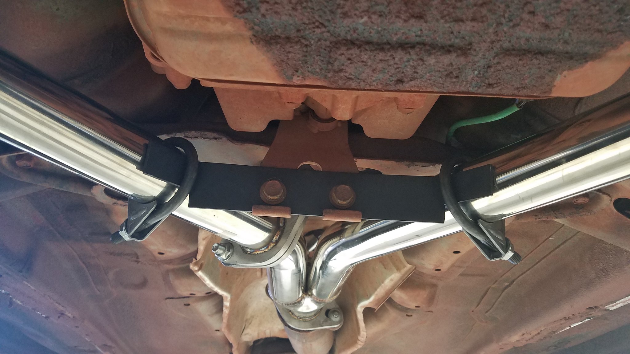

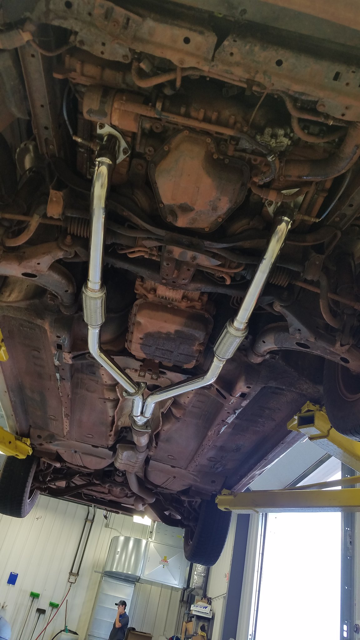

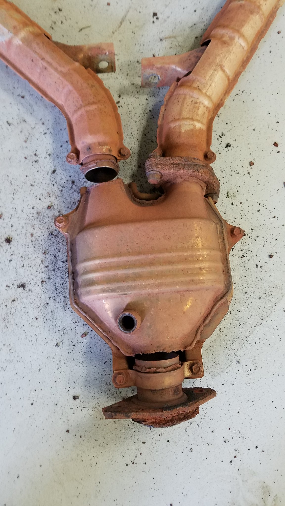

    Exhaust leaks identified:
    [​IMG]20160623_165837 by Numbchux, on Flickr
    And fixed:
    [​IMG]20160623_173614 by Numbchux, on Flickr

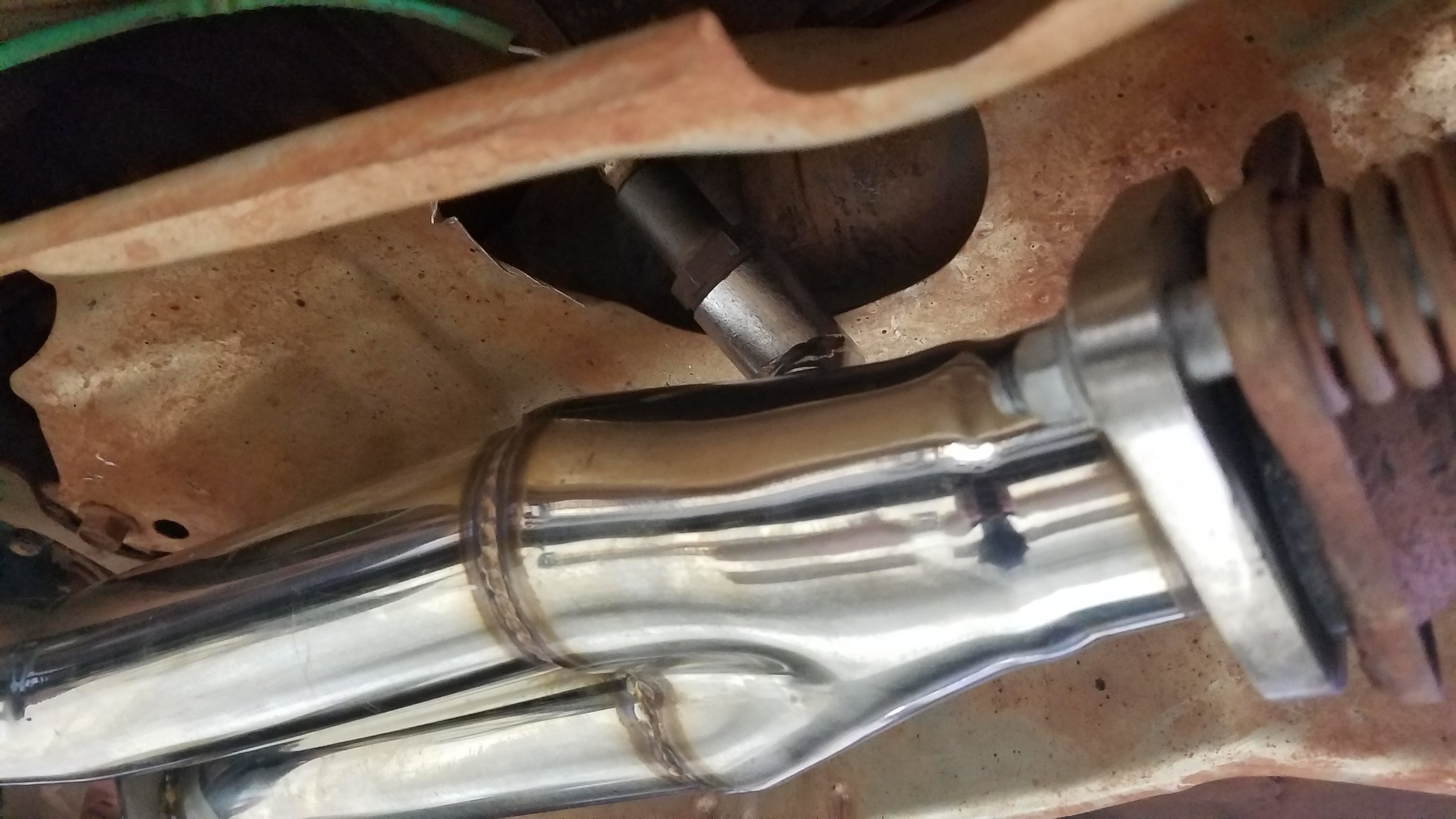

    If you look closely in that picture, you can see that the OBX header set doesn't have the mounting tabs to the transmission. So I made up a little metal bracket that bolted to the tab coming off the transmission, and then clamped to the exhaust:
    [​IMG]20160625_095144 by Numbchux, on Flickr
    45* Stainless oxygen sensor spacer required to prevent P0420 and keep the sensor off the driveshaft:
    [​IMG]20160625_095131 by Numbchux, on Flickr
    [​IMG]20160625_095137 by Numbchux, on Flickr

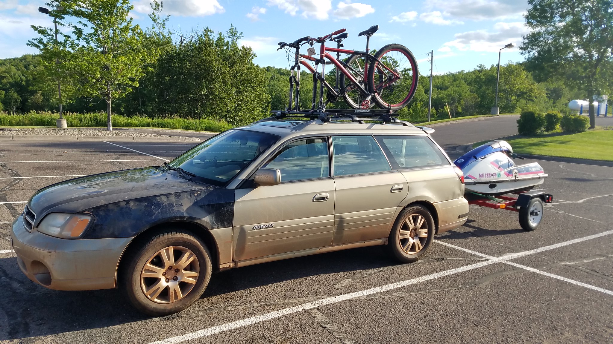

    Another 450ish miles on it this weekend. Loaded up the bikes, hooked up the jet ski, set the climate and cruise control....I love this thing.
    [​IMG]20160701_184051 by Numbchux, on Flickr
    I don't like how quick it is to downshift with the cruise control on. I'm thinking about doing what I did with my last Celica, which is sever communications between the cruise unit and TCU, and then adjust the cruise cable so it has far less travel.

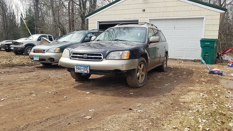

    Just stopped in to replace my photobucket links...
    Not much to say. Something about having a 50 year old house and a 5 month old daughter seems to reduce the free time for car projects.
    But did a couple things over the winter.
    LED drop in bulbs in the headlights:
    [​IMG]20170106_194211 by Numbchux, on Flickr

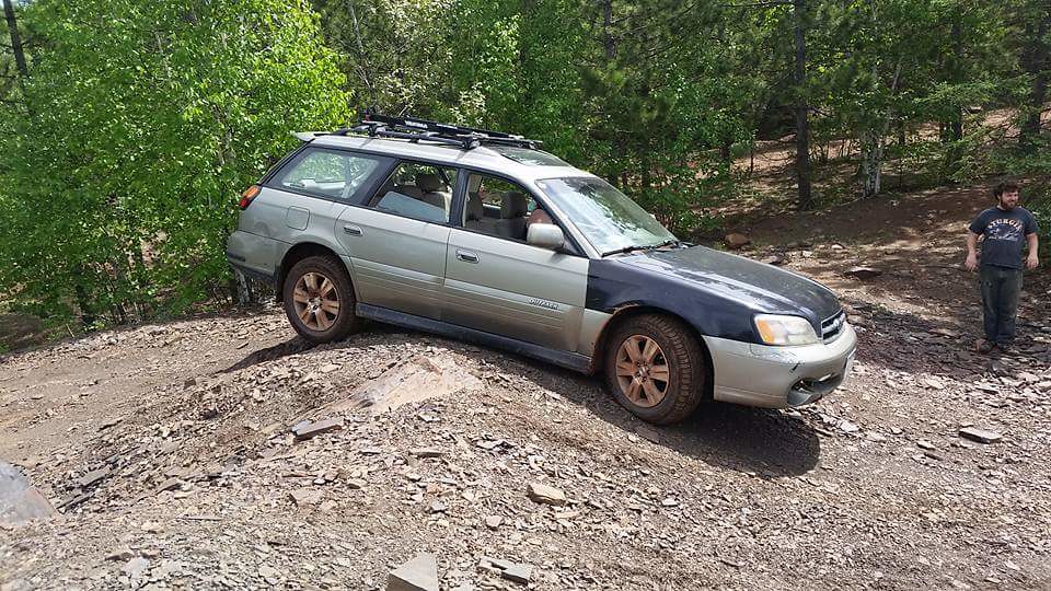

    215/65r16 Hakka R2s on Forester alloys:
    [​IMG]20161126_131433 by Numbchux, on Flickr
    Went wheeling this spring:
    [​IMG]20170520_142939 by Numbchux, on Flickr
    Towed the 4wheeler up to a buddy's farm for some irresponsible activity. I kept looking in the rear view mirror to see if the trailer was still there, it tows so smoothly I couldn't feel it.

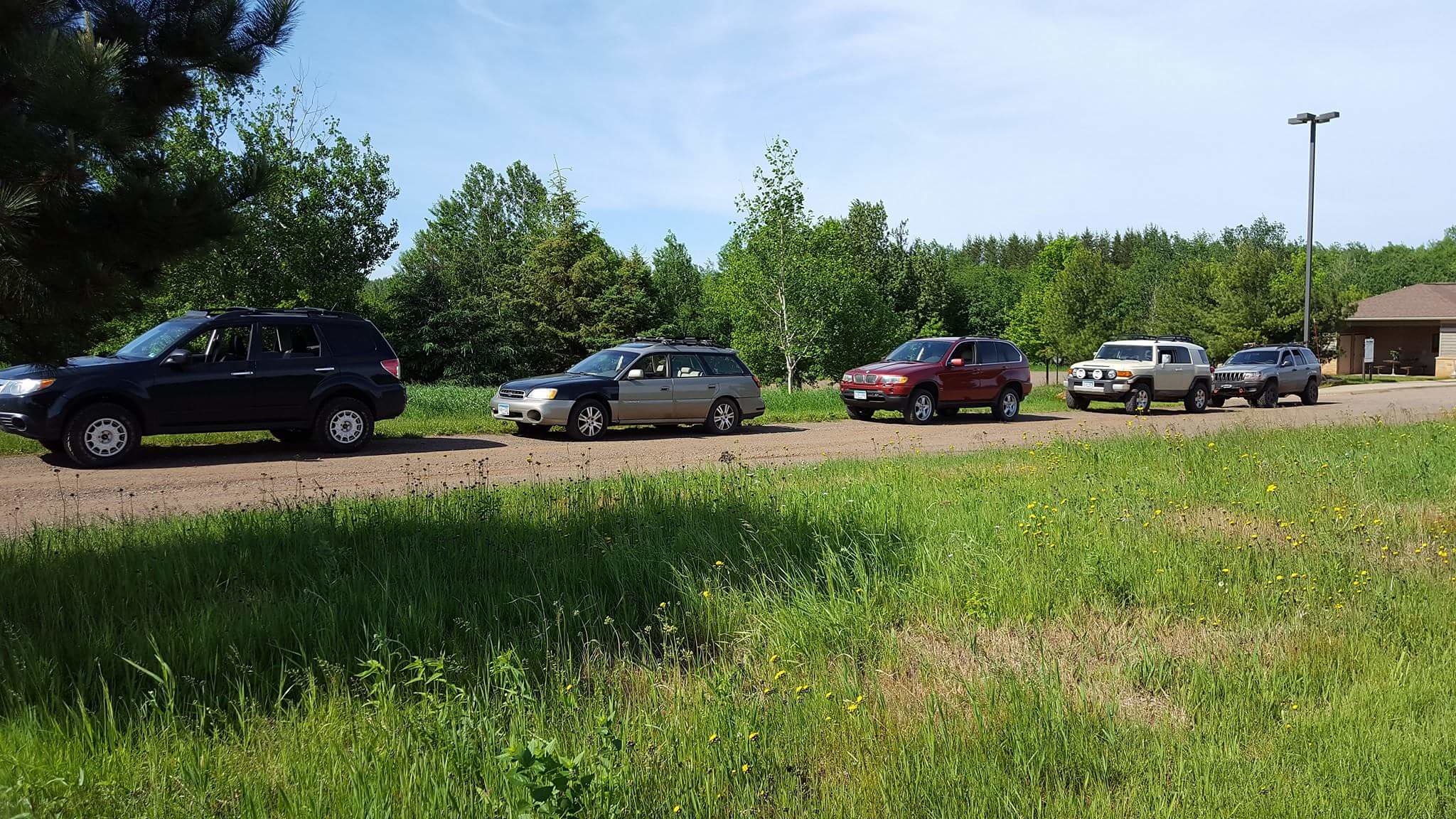

    Dan (FJ Cruiser), Jesse (BMW X5), and Martin (Lifted '13 Forester) left the cities Thursday evening and camped in the Cheq forest in Wisconsin, then Friday they drove on a section of Minimum Maintenance Road which turned out to be more of a No Maintenance Muddy Path. I left Duluth after work Friday evening and met them at the campsite at Agate Beach one the Western shore of the Keweenaw outside Toivola, MI. Our campsite was just up the hill from the beach, so cool.
    Here's our group at the site in the morning. It was a little foggy in the morning, but still way cool.

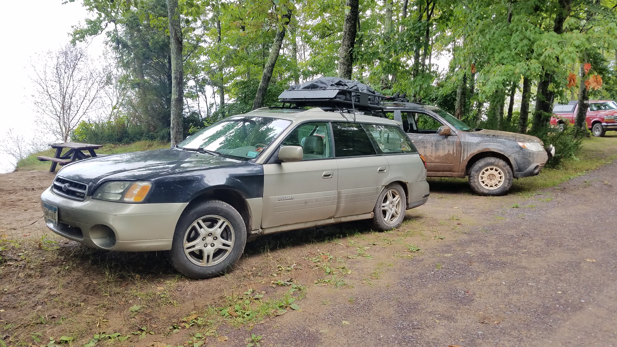

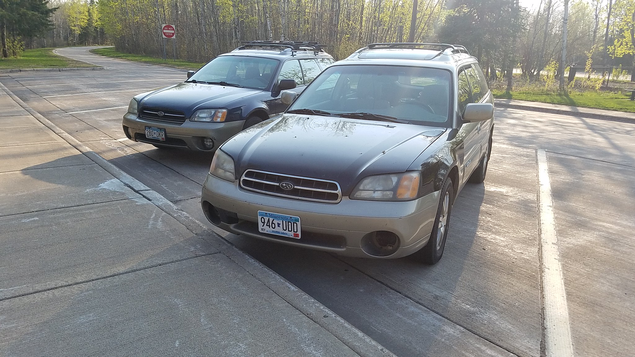

    The 2 Subarus in the group. Mine being exceedingly stock on highway tires, Martins with a lift and General Grabber A/Ts
    20180901_131259

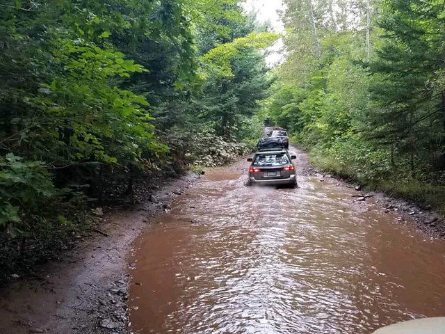

    Saturday morning, we made our way north through Houghton, then taking the ORV route (rail road grade, not challenging, but good to get away from the traffic) up the hill from Hancock to Calumet. It had a few big puddles, and some good views.
    FB_IMG_15360772879349834

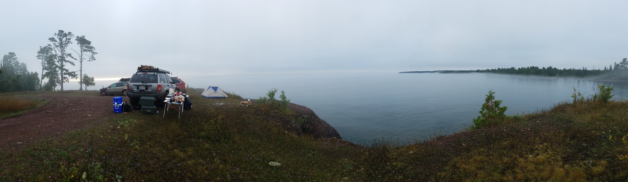

    We made it to High Rock Bay (the easternmost point on the Keweenaw) right about sunset. There were many other people camping, but we still got a spot right on the rocks near the water (so close, that we set up a few lanterns to mark the edge so nobody would accidentally fall off in the dark). Here's our campsite from inland looking out into the lake, Manitou Island appeared out of the fog for a little while.
    20180902_082907

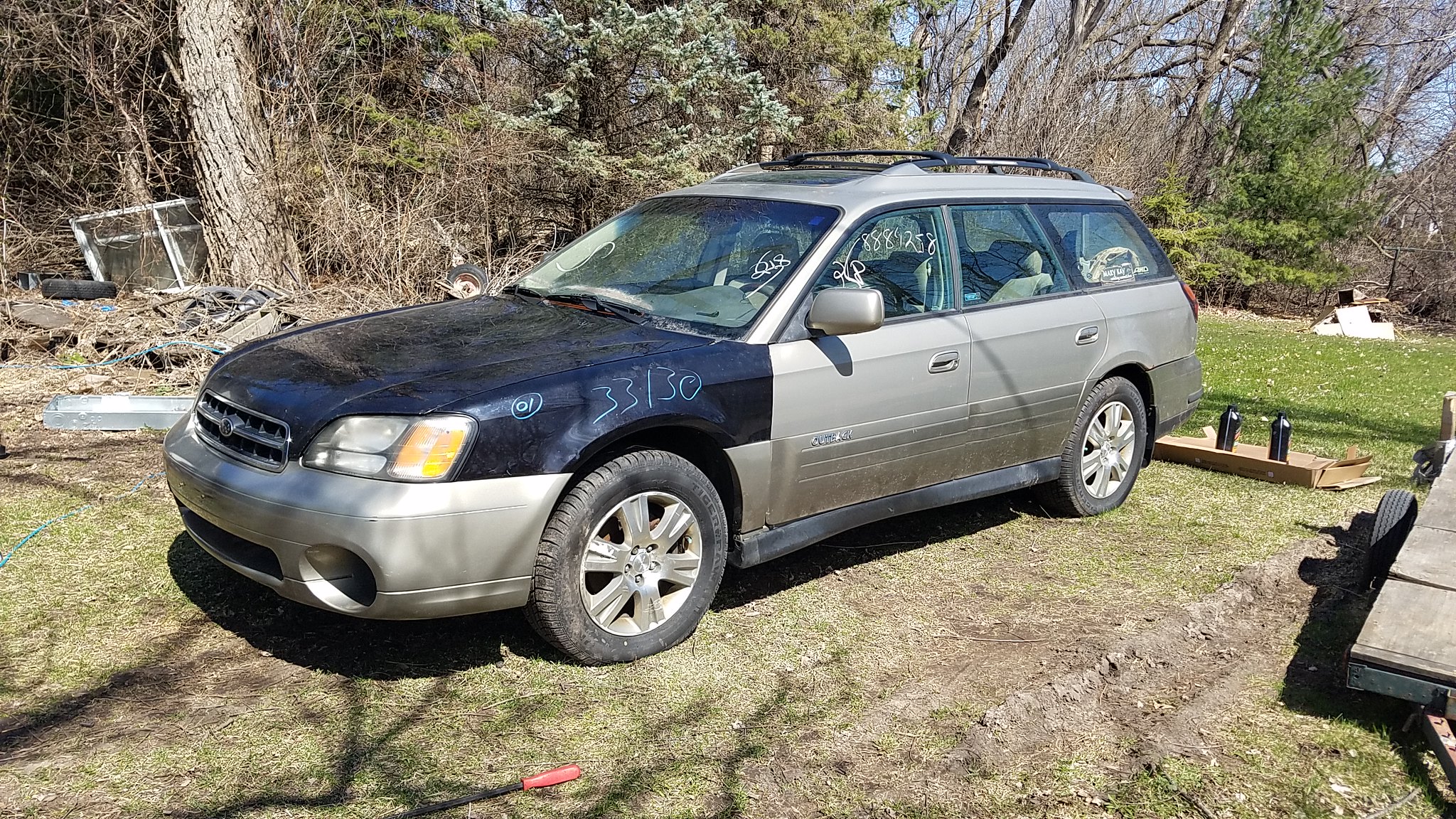

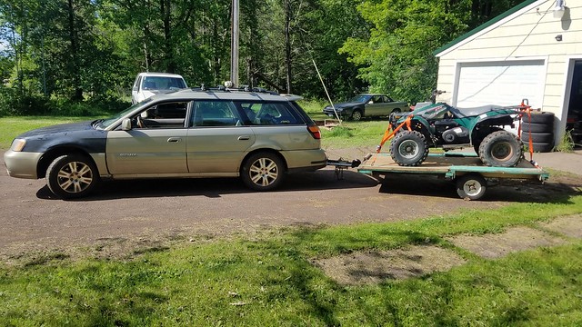

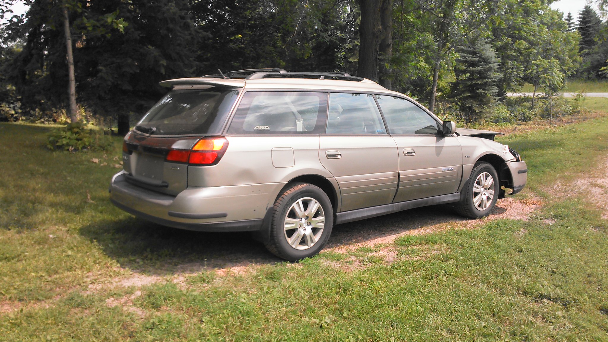

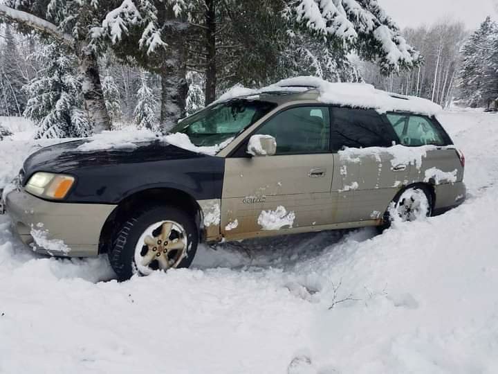

    A few weeks ago, my wife was driving into work in the fresh snow. The plow had only made one pass, and when she moved into the unplowed section to leave room for an oncoming car, she misjudged where the edge of the pavement was, and got sucked into the ditch:
    2021-04-05_08-13-33
    Pretty minor hit, but tore up the front bumper cover. So I leaned in, and cut the bottom half off and finally got it put back together yesterday:
    2021-04-05_08-13-11
