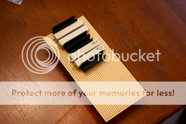

    Yeah, but it needs too see a 10-15ohm resistance, so it's got to dissapate about 10w - you can't throw a normal 1/4 or 1/2 watt resistor in the connector :) The dummy load that the thread OP built looks like this:

    My guess is that the solenoid in question is not continuous-duty rated, which would make sense in its normal application.
    But for Nhibbs or other electrically-inclined folks, I don't know why you wouldn't be able to use a potentiometer to feed the line the voltage it's looking for, instead of using a big dummy load? Unless the TCU is measuring that line's current using an internal shunt resistor and not just looking at the raw line voltage...
