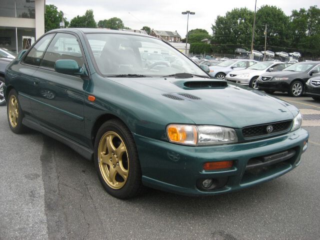

    How many different green colors came on the early imprezas? Does anyone have a list of the paint codes? I am trying to find a passenger fender and a RS/OBS hood that matches so I don't have to deal with paint. How likely are all of these to match? I'm trying to duplicate the look of the '98 RS except for the wing on the cheap:
