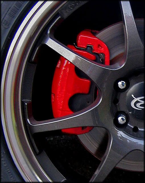

    Use a two part brush on paint if you want them shiny and to last a long time, like G2 or Eastwood or something. I used G2 on mine, it costed about 30 bucks for the kit. If you want to go the cheap route you can get spray on crap at any auto store, but the paint will look quite dull and doesn't hold up as well. Here's a picture of how mine turned out.

    brush on was very easy, just cleaned them with brake cleaner, and masked them off, and brushed it on. The paint is garuntee'd for life to stay shiny and not chip, and has held up for over a year perfectly.
