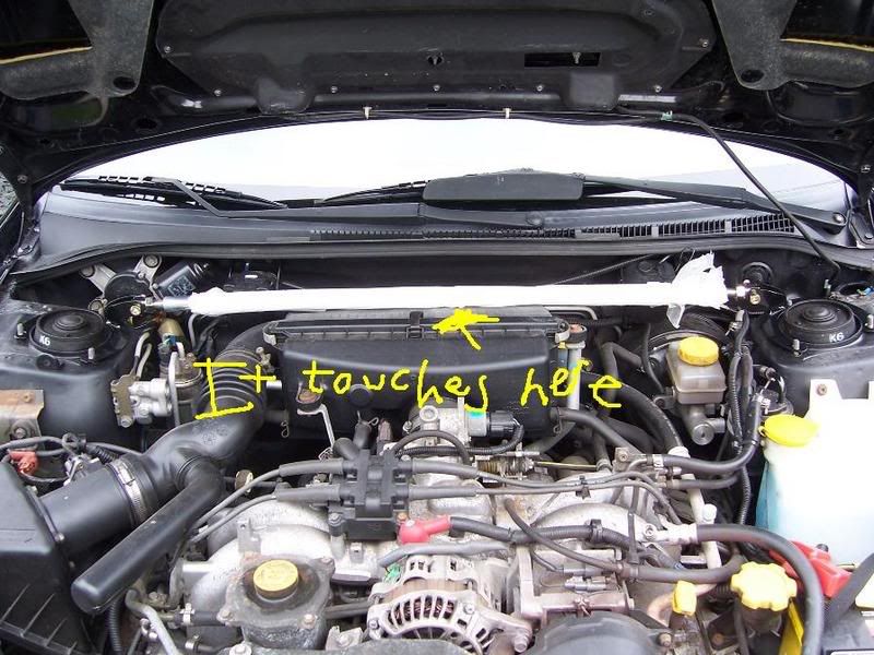

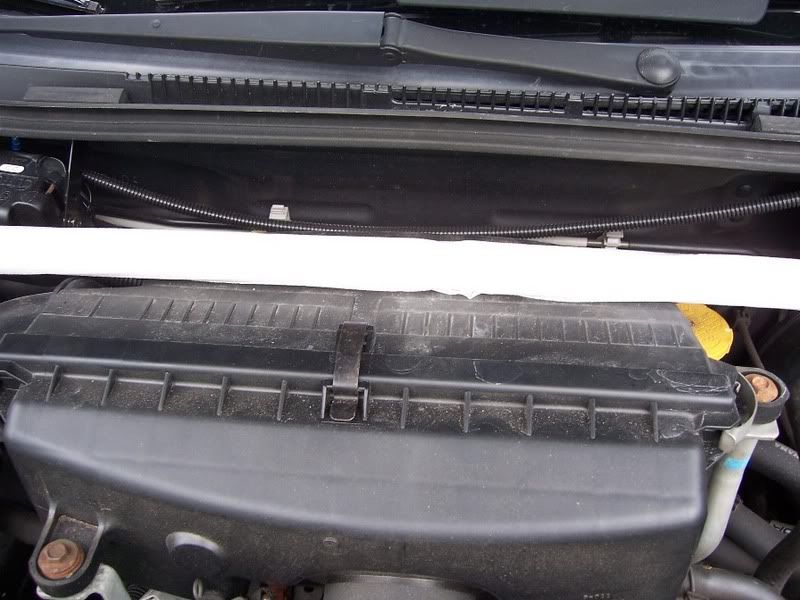

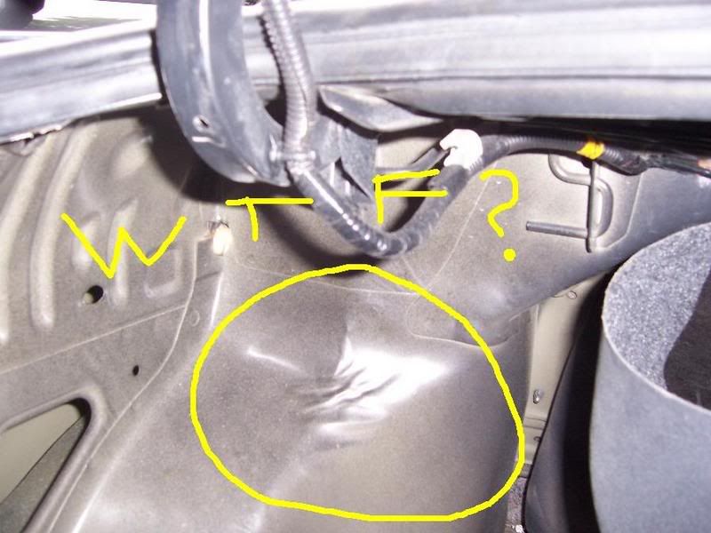

    Well The strut bars came today and I have some problems. The front one doesnt clear the airbox so i cant mount it. Dont worry, it gets worse. The mounting points are mysteriously missing in the trunk. I guess I just assumed they would be there like on my old honda. BUT NOOO!!!!! I pull back the trunk lining and all thats there is metal! I suppose it pays to look ahead.
    here they are. I guess its the price you pay for going with cheap ebay stuff. When you can buy 2 bars for under $40 I suppose you cant expect perfect. If there is something I am missing in the pictures please point it out.

    you need to remove the rear seats to access the rear strut tops.

    okay. And how do i accomplush that?

    take the bolts of that hold it on

    touche. But Where would I find the bolts. I have honeslty never looked.

    two bolts below the lower seat by where your feet would be if you were sitting in the seat.
    Then the back portion of the seat has 3-4 bolts near where the seat belt buckles are. Once they are out then you need to push the seat up to release the hooks at the top.

    The rear seat belt mechanism may be in your way. They will be a pain when putting them back in. IMO fender braces would been a better buy.

    carefull taking the seat out.
    you will scratch the **** out of your side skirts!
    and when you are putting it back in, make sure you get the seatbelts all sorted out before hooking the rear in place.
