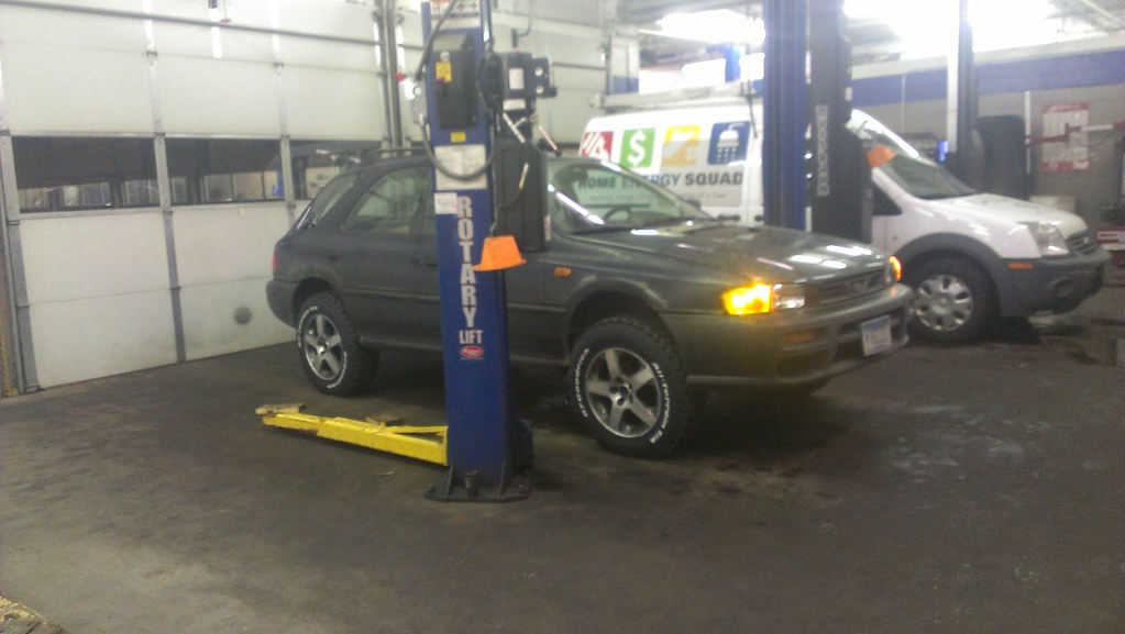

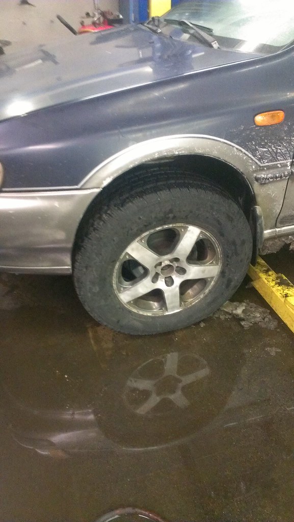

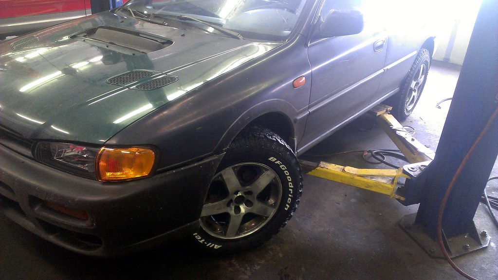

    How big of a tire can you fit on an older impreza? Well... This was the biggest tire I could fit into the wheel well without any modifications to the fenders.
    Here are pics of a 235/70/16 tire with a 28.95 inch OD on a 16 inch VW rim with an offset of +38(15mm further out from hub then oem). The tire is at 8/32nds.
    fozzy suspension + 3/8 and 1/4 inch spacers.
    The car is on the tires, lift isn't touching the car.
    As you can see there is room inside the fenders to fit the tire. The wheel actually won't turn to the inside, it is hitting the front side of the fender, the outside of it. A little bending or cutting and it would turn freely.
    One issue you would have if you didn't have the right offset with this wide of a tire is clearing the strut and even more so if you have an oem suspension.
    These tires and even smaller big tires will not fit without outback trailing arm brackets or cutting out a bit of the fender unless you have oem suspension, in which the biggest size you can fit with oem wheels is 215/65/16 or that seems to be the consensus.
    After this test fit I decided to go with 215/70/16s which is a full inch smaller tire. Less weight and gearing disadvantage for this tiny motor.

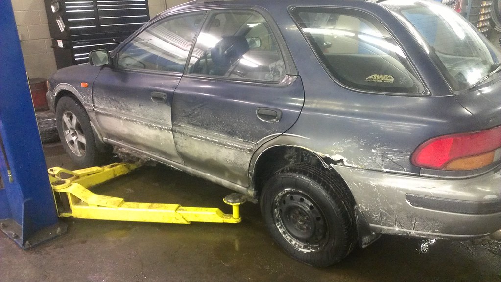

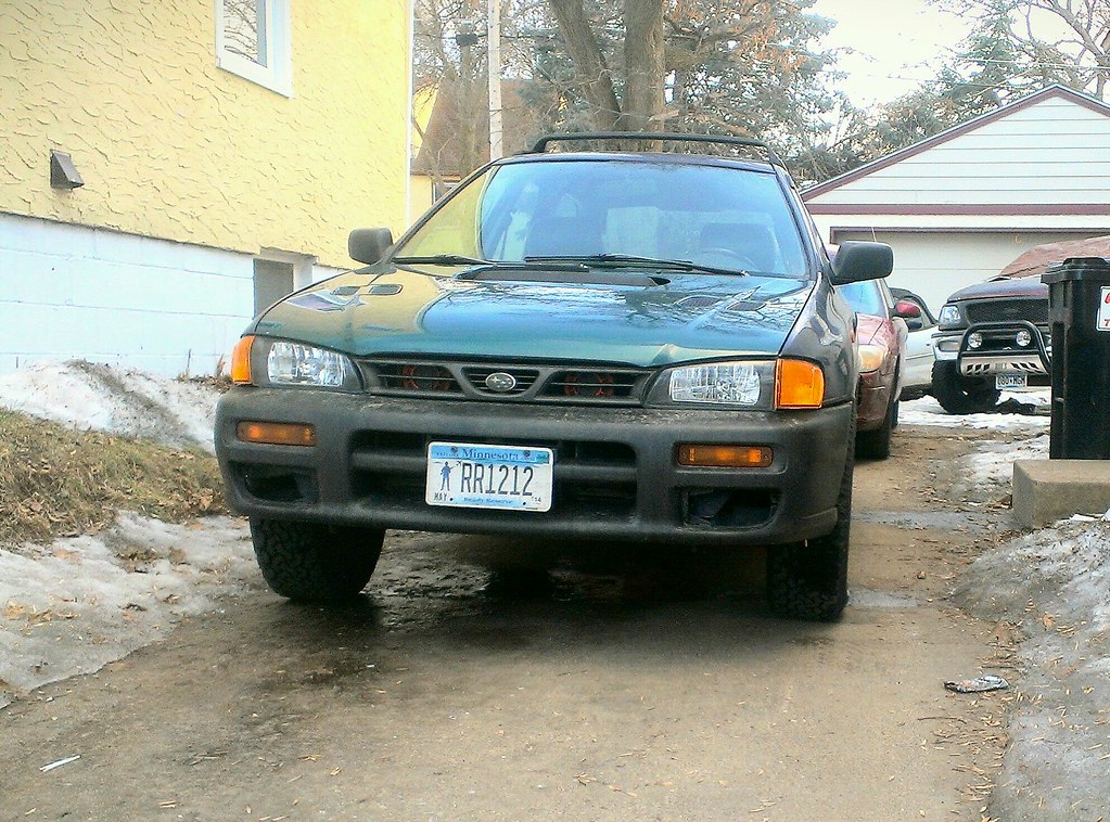

    Before
    After
    Yes it rubs a tiny bit, but that can be sorted with more grinding. These tires are too big to run even with forester struts unless you have the proper alignment, they will hit the rear strut perchs at highways speeds. To make sure this doesn't happen until you get an alignment when you put your struts in make sure the cam bolts are giving the hub all the positive camber you can get. Also be ready to break out the grinder and go to town on your fenders, pinch wields, etc. I had to remove and cut out the area where the mudflaps bolt in the front. I need to hit that spot with a grinder and make room for aftermarket mudflaps.
    So far I love it and the car looks just plain mean from the front or rear. It's taller than it looks.
