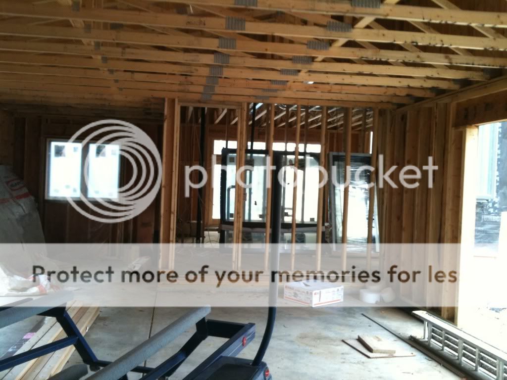

    I'm exactly opposite. We have a house and have been trying to build another for the past three years...
    I can tell you I'd rather be balls deep in a Subaru than balls deep with the mortgage companies! :)
