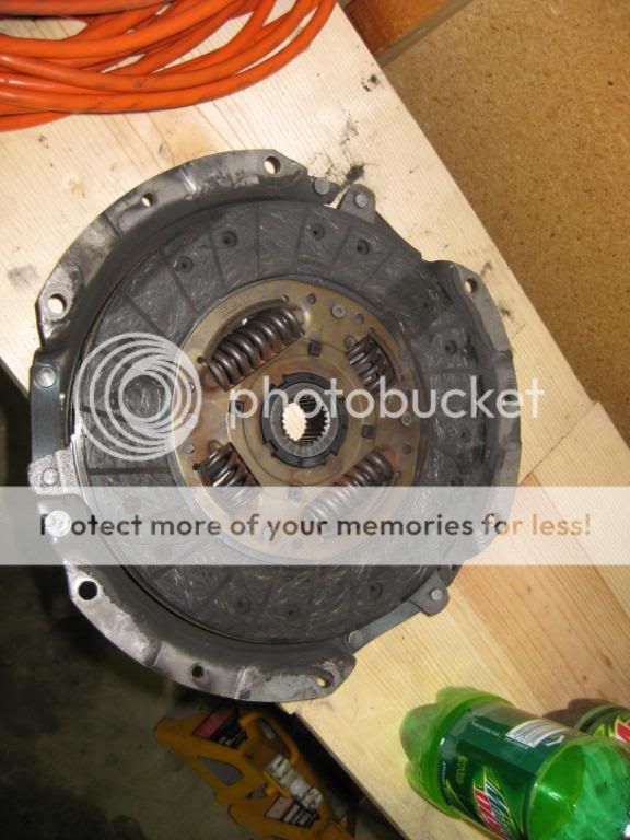

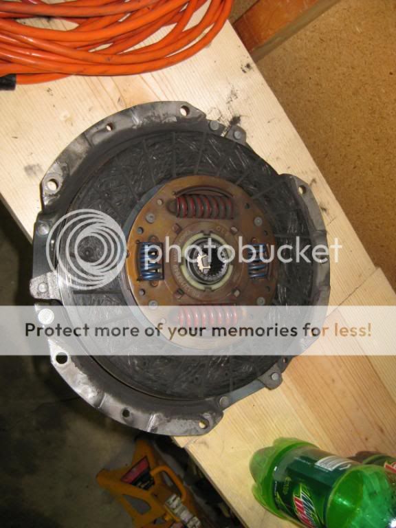

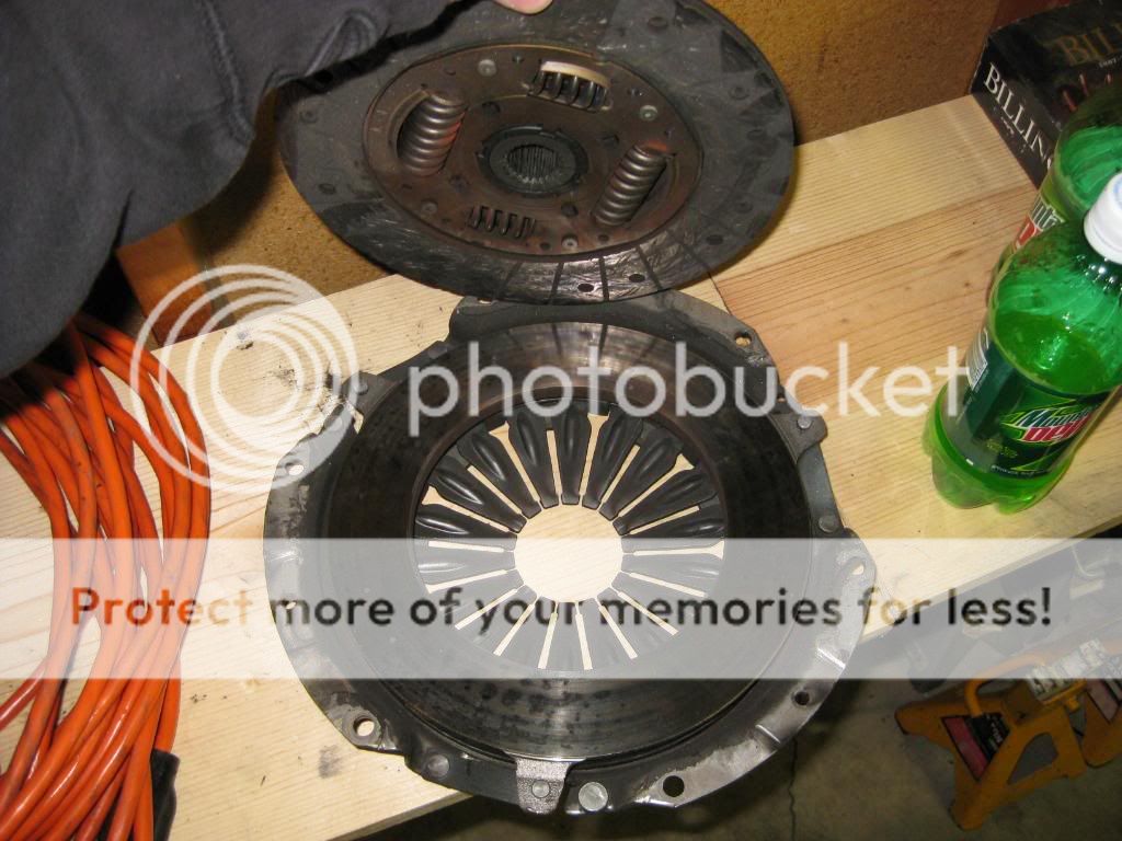

    Normally I would agree with this being a risky thing, but I found a clutch for sale for $50 and there's about 3000 miles on it. I've got some pictures of it, and to me it looks to be in pretty good shape. I just thought I'd post up the pics and see what you guys thought and if you had any suggestions for me.

    When I got the 02 clutch replaced (because of the clutch judder), that's what the pressure plate looked like. Just my opinion, that looks like it has more than 3k on it.

    ok, thanks. I wont make my decision based solely on this, but I'll definitely keep it in mind. btw, is there something specific about the pp that looks bad? It just looks a little dirty/used to me.

    Does that disc say 'made in Korea'? Is that a factory oem clutch?
    Just think, if this doesn't work out. You are going to replace it twice and be out the $50 plus the $300 to get a new one.
  9. HiImBrian
    HiImBrian Member
    I think it does say made in korea. Thanks for the heads up. I'm leanin towards no now :(

    If that pressure plate pictured only has 3k miles on it as you were told those were some pretty rough miles! Maybe just the disc has 3k miles on it?
  15. HiImBrian
    HiImBrian Member
    ^Yea I just heard back from the guy. He initially said the clutch had around 3k miles on it and I asked if he had the pp and he said he'd throw it in for free. So I just assumed that had 3k on it as well. Turns out that's pretty old, so it sounds like a better deal to get a new set. Thanks for the help guys!
