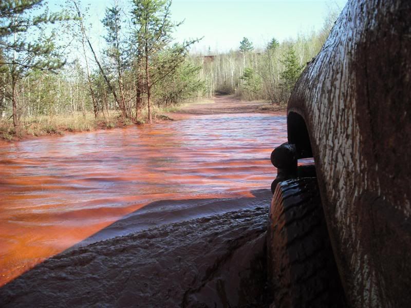

    Also, last time this vehicle was used:
    So, "fluid" control will be an issue
