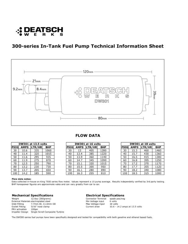

    Technical data:
    Additional tech info -
    Pressure release valve is set to open at 100 psi
    Amp draw is 10-14 amps depending on voltage and pressure
