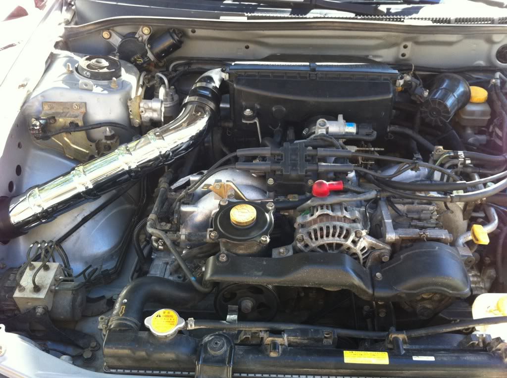

    Well, I was wondering if anyone has done these two simple diy's.
    I already did them myself, but just wanting everyone else who did it to show what they got!

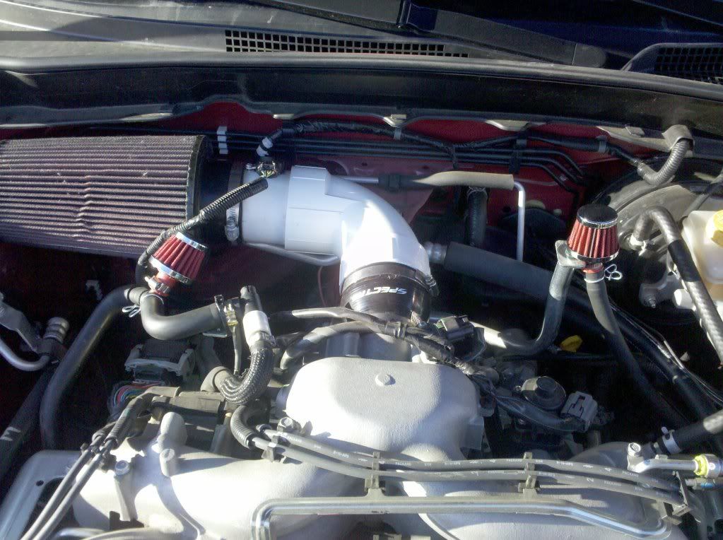

    Here's mines: Also very sorry for the big picture... ;P

    Heres what I've done, seems to work pretty well but the inner diameter of the PVC is bigger then the OEM so the MAF sensor freaks out and all sorts of pretty lights come on the dash...Still working on a solution, but the car runs and drives great.
  3. Nuke
    You should get your fuel trims checked out.
    Should be running pretty lean if so.

    Yeah I should, also some oil squirts out of the right breather...not sure if it only does it when the oil is overfilled, but it doesn't seem to cause any issues but it just seems strange that both sides dont do it. How do I go about checking the fuel? Any easy tricks?
  5. Shibbs
    Yeah, get it tuned.
    Or put the stock intake back on, whichever is easier for you.

    hmmm where bullwinkle? haha The car is also an 4eat, I was asking around about tuning a while back and people were pretty reluctant because I guess theres not much more umph to get out of everything, in a nutshell a waste of money. Thoughts?

    When you get to it I'm interested in seeing your grounding set up, as well. I've heard it improves idle, exc but have yet to do it.
    Also what is the with the mini air filters on the lines? Not sure if I've ever seen that before.
  11. AWDimprezaL
    Those are breathers.
  12. burtonboy00
    burtonboy00 Well-Known Member
    47
    They make it so that crap cant get into your engine, but vapors can get out. Traditionally those lines lead back into the airbox burning anything that made it through the engine the first time around. It dosent give any better milage but it means that there are fewer emissions out the back, and we really dont care about those in MN thankfully.
