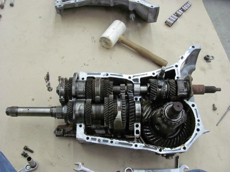

    here's an RX trans open. this one would look the same, but with a different pinion shaft:
    you could get an aftermarket 3-4-5. center diff eliminator, and enforced transfer gears. but I think second gear would still be the weak link.
