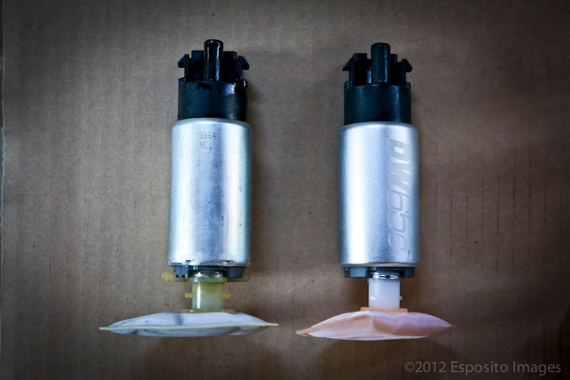

    Supposedly I had an Deatshwerks 65c fuel pump installed. This is apparently an Deatshswerks 65c Fuel pump, Look's like the stock one to me. DW pump's should have their name and the model number on the pump.
    This explain's why my car is running lean up top, it still has the stock pump
    Look at these pictures and let me know if you think it's an dw65c pump or the if it's the stock one

    Would you say its the stock pump nuke?
  4. Nuke
    Dunno. Pull it out.

    Closest I got, Just can't get the tabs off of the pump. If it was a dw65c I would see that on the pump and its not. Why RS Motors? Why? This is how a stock pump(left) and a dw65 pump should look like
    And this is mine, looks the the stock one(notice the holes and no dw65c on the pump) 275.jpg
  9. 03subyR
    03subyR Well-Known Member
    Does not look like DW pump to me :(
  10. wrx 08 Sedan
    wrx 08 Sedan Member
    33
    Looks just like the stock one I pulled out of my car and doesn't looks like my walbro or DW

    Here is a cut and paste of what I sent to Wong.
    Hum I will have to look at the info in the morning. I thin if i remember correctly I tried to get the pump to work on the car and wasn't able to make it work. We found out they delivered the wrong pump that was for an Evo X. I remember that we were under a time crunch with your car and since we ran short on time I put the stocker back in. You can confirm this by the fact that the housing was modified. I think since I did all the billing before we got the car I didn't remove it from the bill.
    I certainly apologize and we will get it figured out
  12. xluben
    Why was the housing modified? I don't think either of those pumps would require housing modification?
  13. Terry Ammerman
    455
    I agree, should require zero mods to make the correct pump work.

  15. WLGT
    WLGT Well-Known Member
    227
    All good now,
    Thank You, Matt at RS:)
