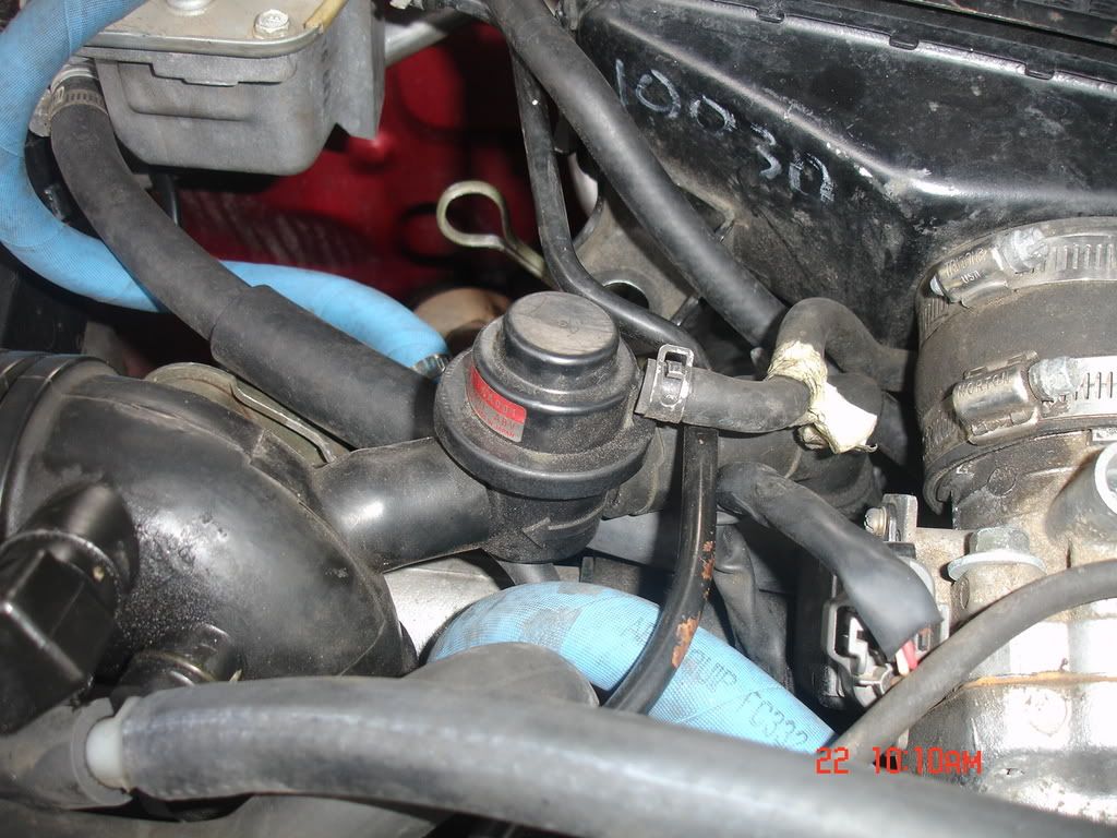

    Here's a shot of my BPV. I know on my WRX I threw a 'T' on the hose that ran between the BPV and the manifold. Does the same go for here? I'm thinking the top hose that has the little piece of white tape sticking to it.

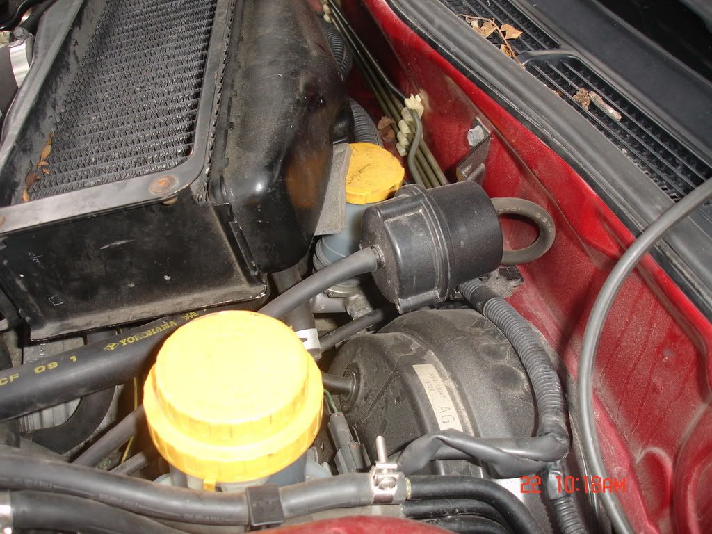

    2nd question: There is a 2nd cylinder resembling the brake master cylinder sitting under my IC. Is that the clutch master cylinder?

    you are correct on both...same hose and yes clutch cylinder then slave underneath that
  3. Dynapar
    you can tap pretty much any vacuum line fore the boost gauge. (except the EGR line)
