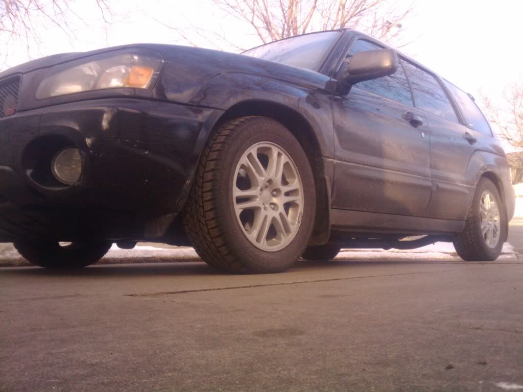

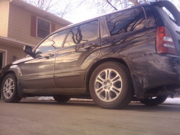

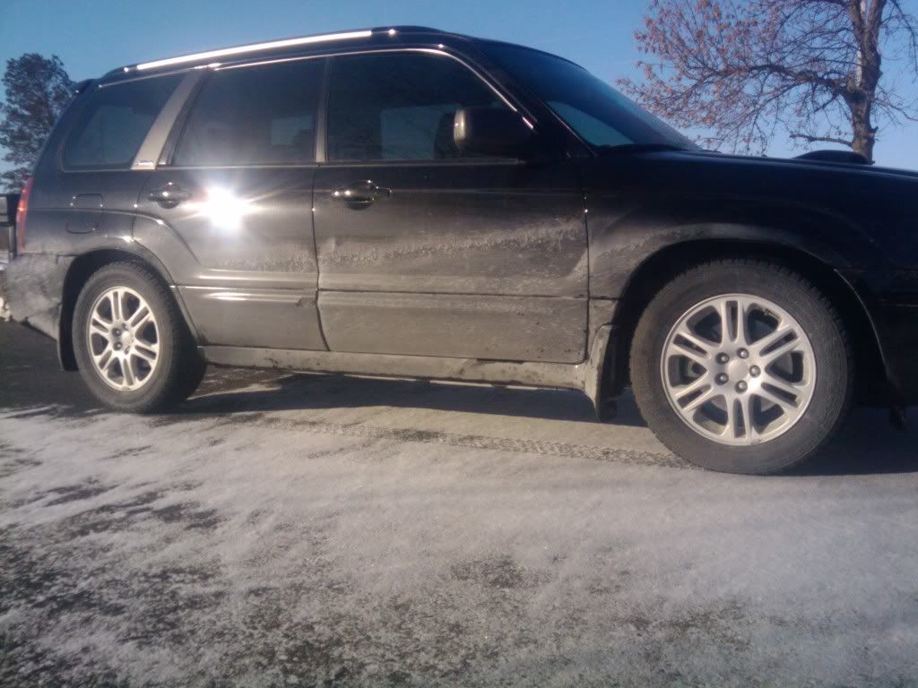

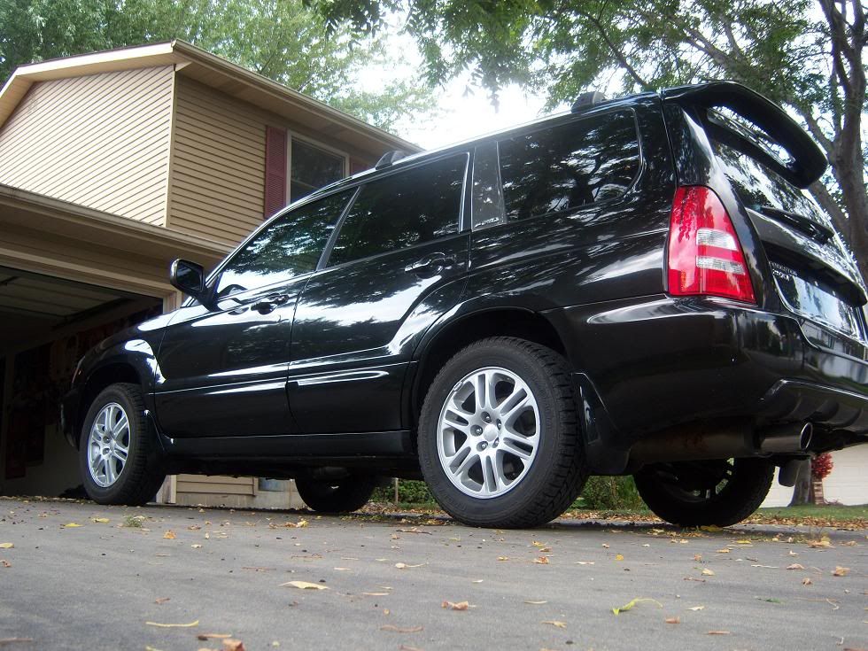

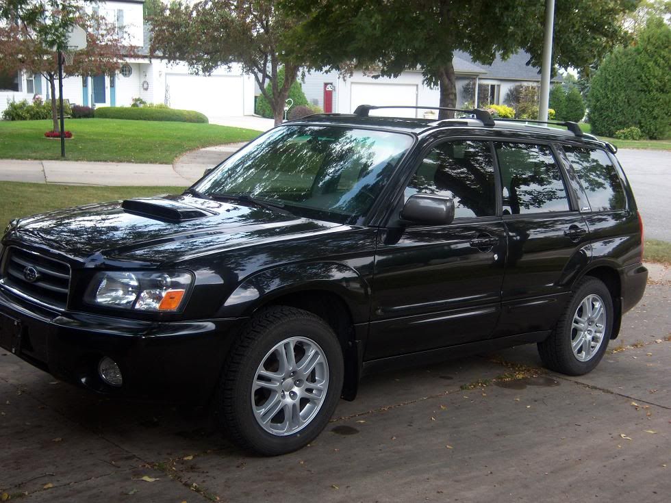

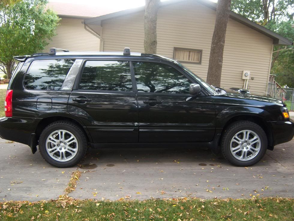

    After owning my forester now for a little over 2 years now, I finally had the funds and time to drop the kid hauler. I'm just waiting for spring to get here to put the winter set up away and get the summers out...
    Before I was just running stock XT suspension
    Now I'm sitting on 06 WRX takeoffs with 3/8" saggy butt spacers
    anyways on to the photos.

    I would highly recommended it just for the fact that the ride is way better. I had read that there was questionable choice on valving/spring rate combo on the stock forester suspension like the sti has, running wrx takeoffs makes me a believer.
    Plus it looks that much better without all that fender gap!

    Yes, the body roll is substanially less, especially paired with the sti sway bar I put in last year.
    As far as a setup to increase the drivability and still maintain a comfortable ride on our beloved MN roads... I have absolutely NO complaints.
    Its perfect for spirited daily driving and hauling the family around on the weekend!
