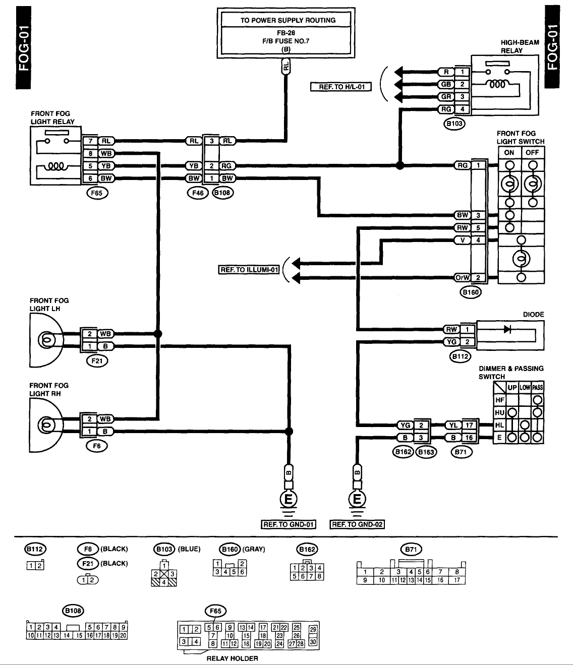

    03 WRX. Fogs just won't come on. They were last working normally a couple weeks ago. There is no green indicator light when pressed in and no relay click, but the switch illuminates with all other dash lights when headlights are on.
    What I have done: (nothing more, nothing less)
    1. Pulled fuse and put in another =no go
    2. Swapped relays with known working one =no go
    3. Swapped a fog light bulb out with another known working one =no go
    What to do or test next? thanks

    Maybe try checking the wiring, could possibly be a bad ground somewheres

    Bad switch, wiring, or shut your brights off :)

    Here is a wiring diagram. Hope it helps, follow your wires and check your grounds.
    Sjogun and silver03 like this.

    Could be that your foglight harness has burnt out
