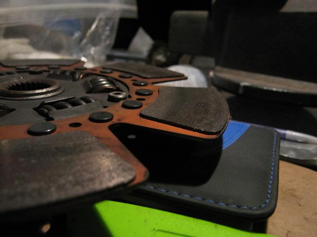

    Exedy Hyper Single Clutch, 6mt
    This clutch held this turbo without issue. My stock 6mt clutch didn't like 5th and 6th gear. There is about 60-70% life on the disk. The flywheel is machinable, and a new disk and pressure plate can be purchased from anyone who deals in Daikin/Exedy. $1100-1200 new.
    This clutch has a lighter pedal than a stock 6mt clutch due to the higher leverage ratio. I enjoyed it, and would rather not part with it if I didn't have to.
