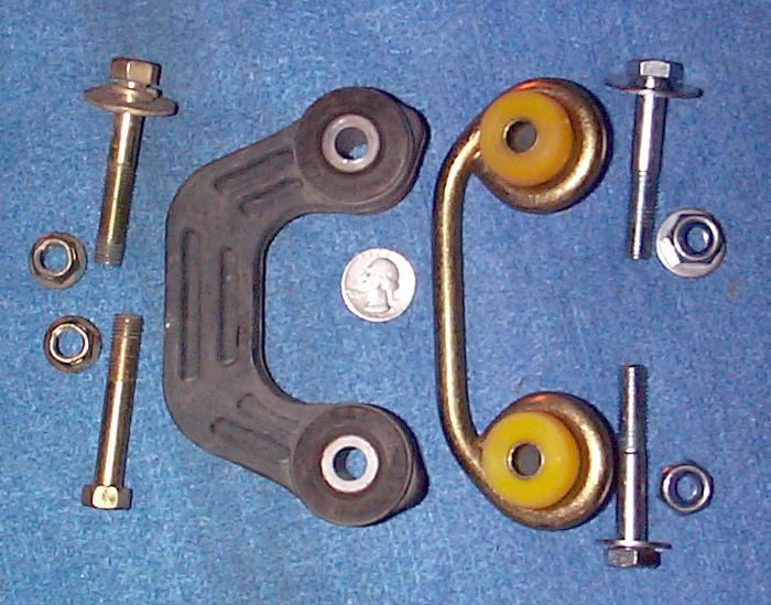

    Here's my story of clunking whiteline FSB. I've been hunting down a clunk noise forever. I've read everything in the universe about FSB clunk and nothing has worked; extra grease, extra torque, less torque, crying my eyes out...So I put the stock endlinks back on, and the problem was solved, mostly. I couldn't get one of the bolts tightened down all the way, so I've still got a little noise. The the bolt is so loose that I can wiggle it with my hands. So I tried to tighten it and have ruined the rubber gasket around the bolt. In addition, I've stripped it to hell and now I'm stuck.
    So can anybody help me cut this bolt out? I also need a set of stock endlinks to go back on my 2005 WRX, cause I've really destroyed mine. I hate it when fixing something is code for me not being careful and actually breaking something. I though I was so close to fixing my noise and now, so far away, at least until mnsubaru saves the day.

    Your endlink is attached with something other than the nut and bolt arrangements pictured here... (yes, I know these are rears)
    Is it possible that having the wrong nut/bolt combo in there has been your problem all along ?

  7. Andrew
    Andrew New Member
  8. stoooo
    stoooo Well-Known Member
    I think those are STi links, meant to fit the aluminium control arms, not the standard WRX ones.
    The bolt outs might still help. They'll quite happily grip the side of a totally round nut, e.g. Subaru Locking Lug Nuts.
    Stuart.

    I was reading about somebody else wrestling with these things that employed a saws-all. Great idea. The bolt is now removed. I put my Kartboys back on again and now the clunk is gone...for now. It always seems to come back though. I'm afraid.
