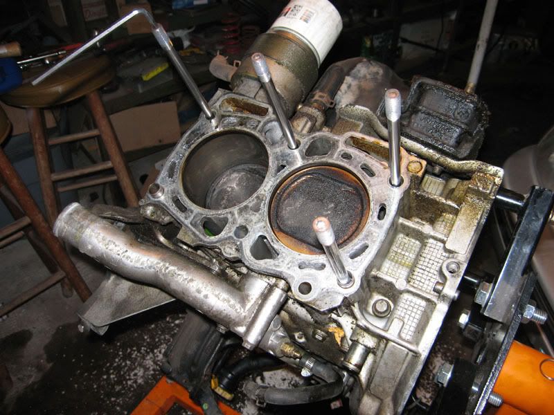

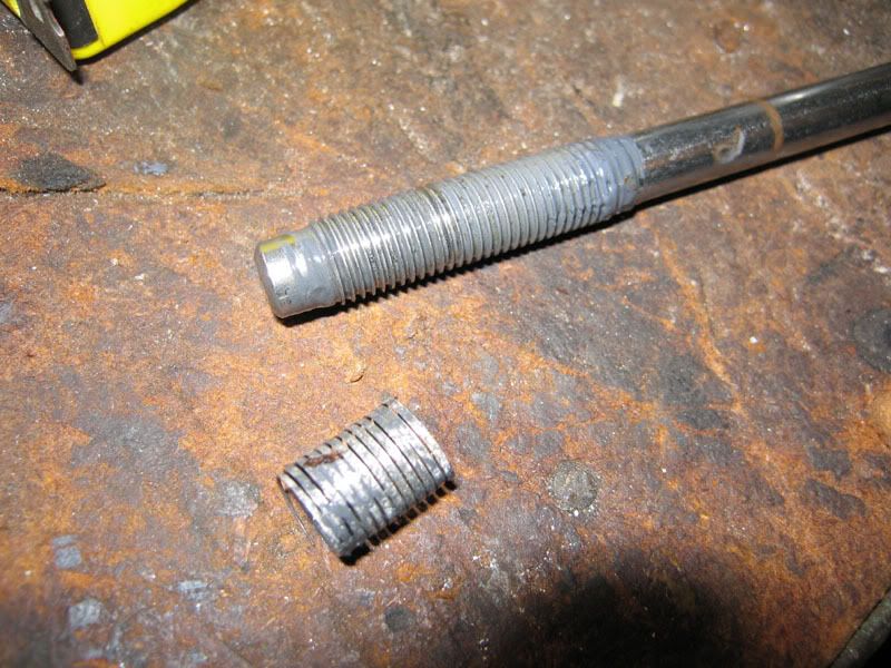

    The headgasket blew yesterday putting along on the freeway. Over 15k miles and the threads finally let go. I had no idea studs were supposed to bottom out. Kind of a debilitating oops.

  5. bikerboy
    94
    OHH that is not good. In the first picture are those the threads from the block? If so that is going to suck, I cant think of a good way to fix that since the threads are so deep.
  6. piddster
    Yup, stripped them out of the block on two studs on that side. I've lost motivation to finish tearing it apart at the moment. Maybe a few more beers and I'll be there, lol.

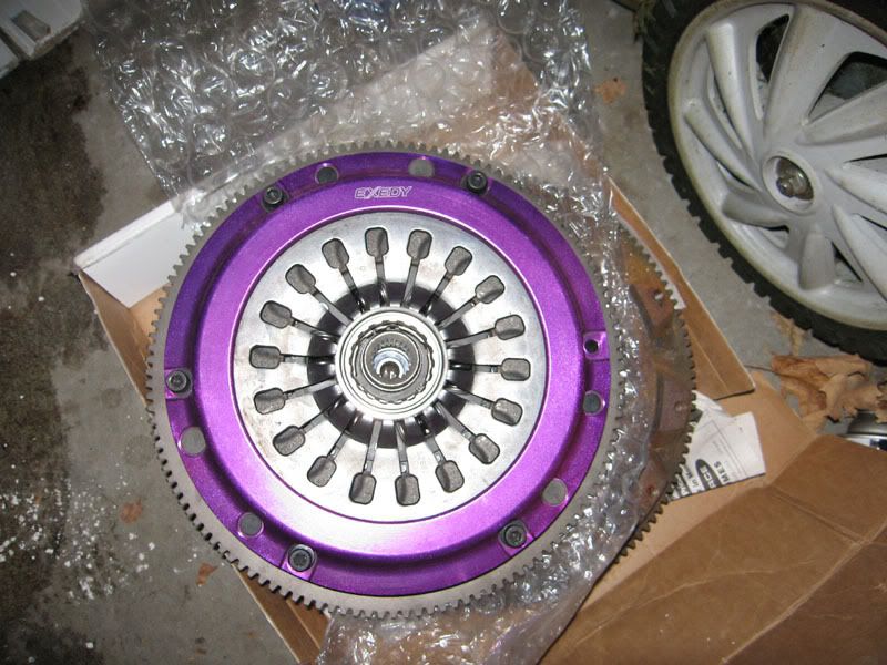

  14. piddster
    Its not worth it since yours is together.
    I found a good deal on an Exedy Hyper Single.

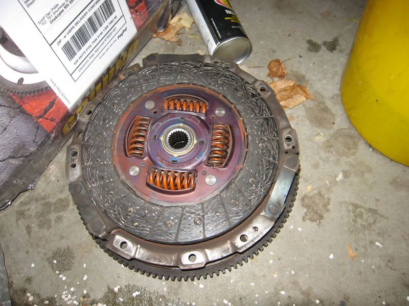

  15. 02blubru
    what is the right way to break in on a new clutch?
  16. piddster
    not beating the hell out of it right away. Let the disk seat into the flywheel and pressure plate a bit before you really give it.
