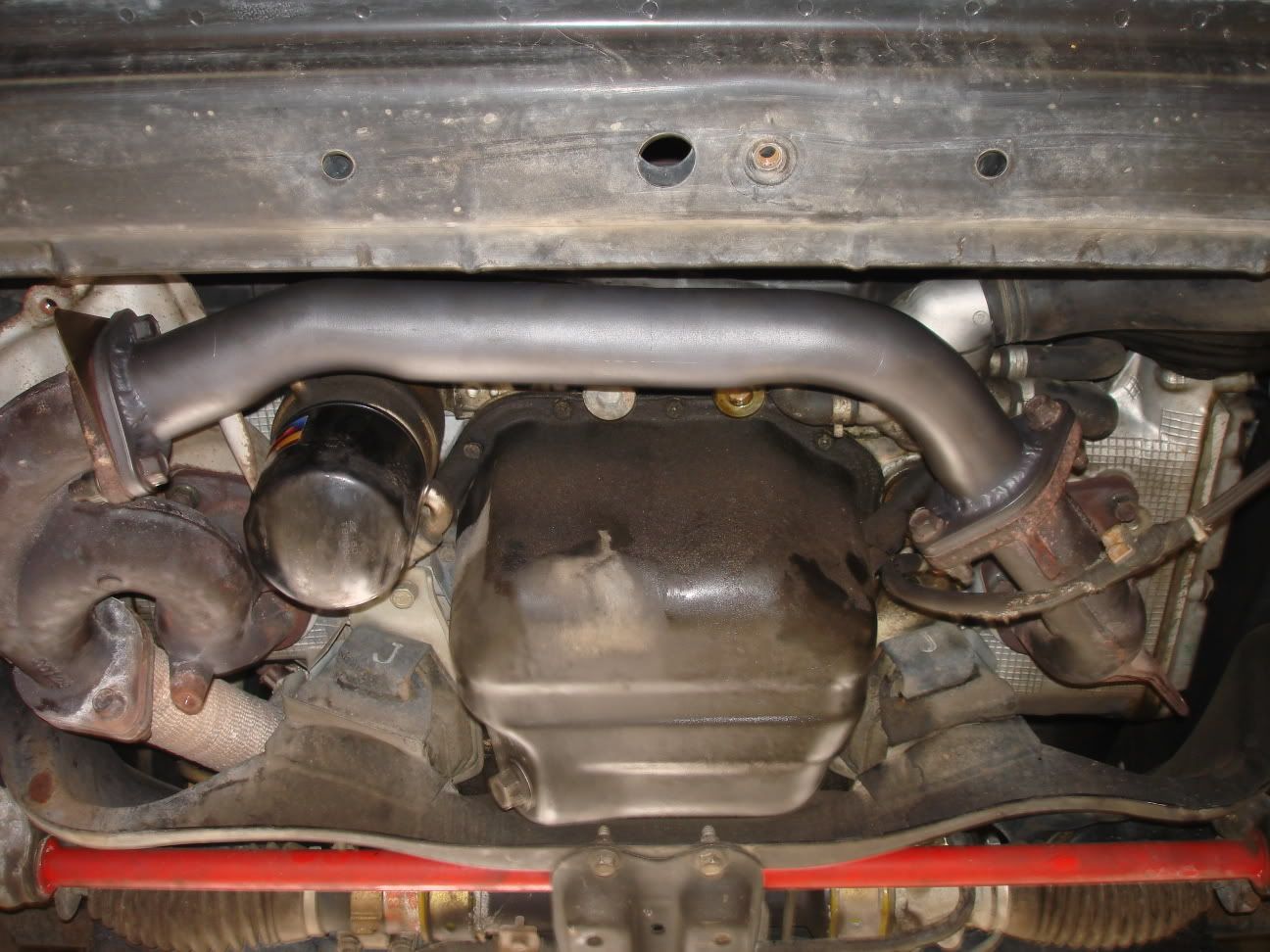

    Anyone interested in a custom made one.. Justin got me to make one for him so I made 3 and kept 1.. I think he is buying 2 maybe.. but I am interested and making more....
    I will post pics tomorrow if I remember to take my camera to the shop...
    2in piping... not as pretty as an aftermarket but probably a lot cheaper.. ha ha ha

    As far as welds holding up... well the truth is it isnt polished, it isnt stainless steel.... and welds rust over time... just like on my exhaust... but as far as I can see - unless you spend more time on your back under your car then driving it who cares what it looks like as long as it functions well...
    and the one on my car.. not a good pic as it is too close...

    It connects the 2 exhaust manifolds together. The front-most exhaust pipe when looking underneath. It crosses the engine, thus crossover.

    Me and Justin will be talking tonight about it... The one on my car as far as I know so far isnt leaking... I will give it a few days and then recheck it.. but when I made them it was made to my car with NO gaskets so once the gasket is in place it should be a tighter fit... should be.. ha ha
    now this is just a gauging of interest.. I am not sure I want to get right into it yet as each time I make one I have to pull my car apart to make it suit...
  10. TSTRBOY2004
    ps... I made them with 2in piping.. so even with the squash bends in them they flow more than stock...

    Ok. I finished coating one a few days ago. This will be a much cheaper alternative to the Injen Crossover. The Injen goes for $250+. Nathan and I havent came up with a final price yet but we will soon. We'll probably have the option of either ceramic coated or not coated.
    Oh, and for specs, the stocker is ~33mm(?) and these are 48mm.

    ok guys. Starting to produce these now and i have 10 on hand. A couple are already reserved for a couple ppl here and a couple guys on nasioc, but there are still some left. This replaces the tiny stock pipe that connects the driver side and passenger side collectors of the exhaust manifold.
    These are similar to the injen ones but the injen's arent coated and they cost $250. I'll be selling these for $125 and they will be ceramic coated. Inner diameter is 44mm.
    Upgrading the crossover alone has been documented to produce quicker spool up and higher hp/trq.

    and the welds on these ones are very good compared to the original posted pics....
    Justin will post some more pics

    This will fit wonderfully on your car. The template was designed on a WRX. I've been running one for awhile now on an 02 wrx and i have had no problems at all.

    I built them all on my car to stock manifolds indiviually... they are all hand made and fit sluch with NO gaskets so with gaskets should be a real nice fit...
    as far as effect?? check the link Justin posted.. give or take a couple of horspower.. but it all adds up in the end and for the price it isnt a bad upgrade...

    Well, I put mine on Saturday. Went over to Nathan's shop and had him throw it in. Fitment I would say is B+. No major modifications needed to be done, but not exactly bolted up flawlessly.
    Hard to feel 5-10hp on the butt dyno but I would say it sounded like the turbo spooled a tad quicker. Be great to match with PnP manifold and UP.
  43. TSTRBOY2004
    yeah when I built them I build them without the gaskets in to get a good tight fit.. hmm they are tight alright...
    so be warned.. you have to fiddle a littel to get them snug but they will fit with soem work... but unlike Dizmal most guys dont mind getting their hands dirty and working on a car.. ha ha ha
