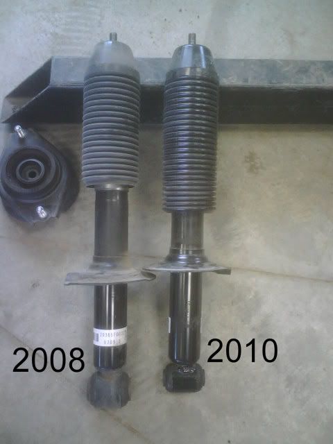

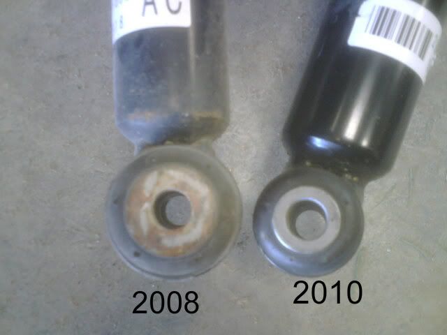

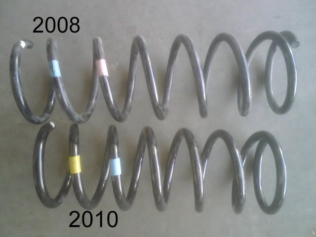

  33. predavore
    predavore Well-Known Member
    695
    Here is a little comparison for you between the 2008 struts/springs and the 2010 stuts/springs.
    Rear
    There is noticable (and measurable) size difference in the springs. The 2010 springs are shorter (same length as the STI pinks).
    (I hate photobucket...)

    Ok... so here is the question. Will the perch to top height difference cause extreme negative camber?
    Look closely (I know that the boots cover up all the important parts.) The 2008 rear strut seems to run the car higher (longer from the perch to the top of the threads). In return, the 2010 might lower the car farther. Resulting in the rear being lower and the camber being more negative.
    I'm running around -2 degrees of camber. That's the closest to 0 that I can get. I'm contemplating a new set of springs to bring the rear back up a bit. The other option is some uber expensive adjustable lower rear control arms. That or just new rear struts specifically for the 08.
    I've been switching out to wider tires over the last year and a half. I'm noticing more inner tire wear. Pretty sure that it's due to the negative camber.
