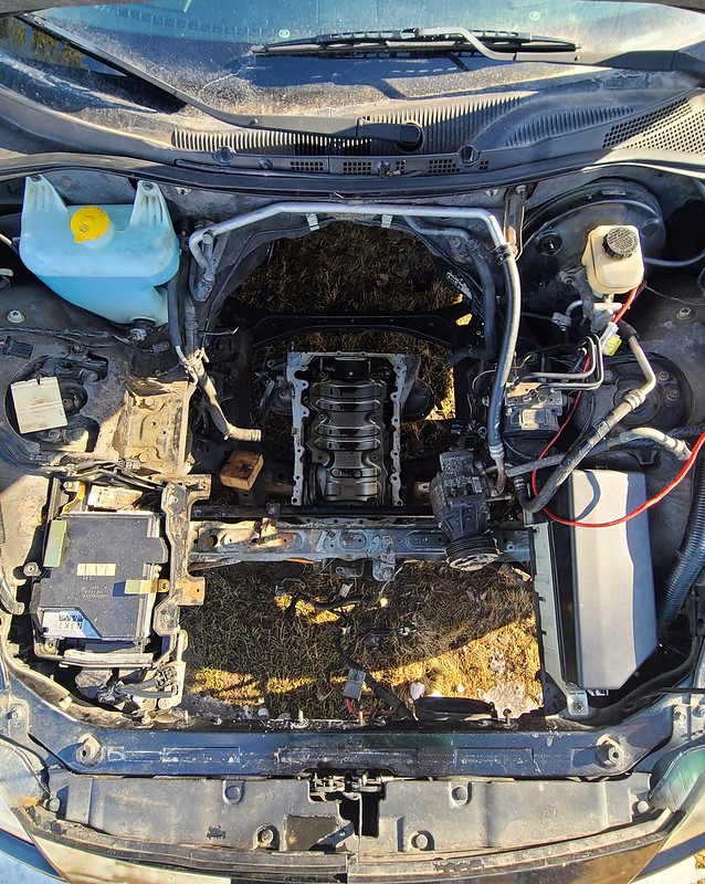

    Here is a 2GRFSE oil pan mocked up in the RX8 engine bay. This is the longitudinal RWD version of the Toyota 3.5l V6. I can use this oil pan on the transverse version of this engine (2GRFE), and with some factory parts use an R series 5-speed RWD transmission behind it. Likely an R150 or R155 truck unit, with a few R154 Supra parts for better gearing. This engine was insanely common in Camrys, Highlanders, Rav4s, Siennas, RX350s and ES350s, as well as the Lotus Evora. My plan is to get an AWD donor vehicle from Copart...
    This engine is a fairly common swap candidate into MR2s, so there is some performance support (Toyota offered a TRD supercharger for awhile). And with headers, an intake and a tune, they regularly make 300rwhp.
    I plan to run it on an ECUMaster EMU Black, which can use the DBW, and VVT, and output the CAN information for the power steering and gauge cluster on the RX8.
    This is a very long term project. If things go well, I hope to buy a donor car next winter and can really work on it next summer.

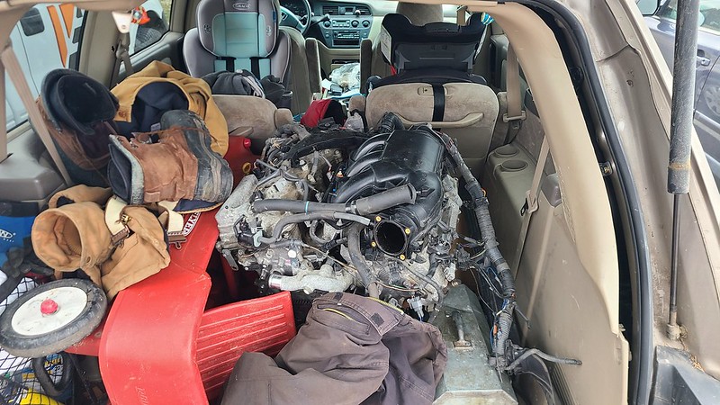

    My dad and I went to UPull for the $100 all-you-can-fit-in-a-wheelbarrow sale last weekend. I had hoped to get a transmission for the Baja project, or a host of other things, but struck out on anything major. Until we came to an '07 V6 Camry. I knew this car was there, but hadn't planned on putting the time/effort in to pull an engine in the yard. But, someone had pulled the transmission and left the engine on the ground. Despite the rain the day before, it was dry, so I suspect it was pulled earlier the same day.
    So....we lifted it into a wheelbarrow, stacked our other things on top of it, paid the $100 and rolled it into the back of my minivan

    I spent a little time on Monday test fitting the intake manifold reversed. It hits the intake VVT solenoid on the valve cover...I have a couple ideas for solutions, but, I'll wait until I can test fit it all in the car and see what hood and firewall clearance actually looks like.
