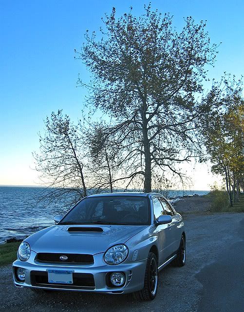

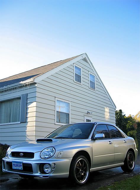

  15. Deride
    Here are mine cleared out with clear corners too.
    I used the oven roasted technique, and mine re-sealed just fine haven't had any moisture in them for over a year after doing the mod. I left the clear bulbs in the fixtures too.
  16. 02blubru
    That looks very nice

  18. PaulasaurusREX
    So you just took out the Orange lense and didn't paint anything inside? I think I may try the "ship in the bottle" trick and attempt to take the bulb out in pieces from the back. Baking just sounds like trouble and i know nothing about it so.
    I also like the clean look of your car, very nice. The headlights look good, if thats unpainted I think i'll be able to live with that and not bake them.
    Thanks for the pics, what scoop is that?

  20. Deride
    I'm using the factory (clear) bulbs, and no I didn't paint anything inside the fixtures.
