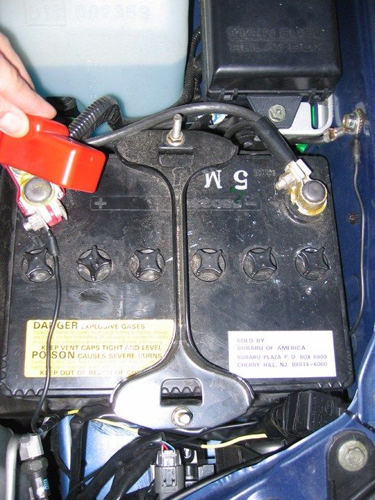

    Here's what I've done so far.
    Here's where I drilled the holes for the brackets.
    I used a wood block behind the metal to make sure I didn't accidentally drill through anything like radiator or hood release cable.
    The brackets that come with the horns are not easily bendable. Either make some custom brackets from some flat stock or stack a lot of washers to space them back far enough.
    Here's both of them mounted.
    And behind the grill.
    I haven't done any wiring yet besides just finding a place to mount the relay. I'll work on the wiring tomorrow.
    Ok, here's a pic of the finished wiring. I left the low tone from my old Fiamm horns hooked up to the stock relay.
    This is basically what I'm going to do for the wiring... I just need to go pick up a few things like a fuse holder and some larger ring terminals for connecting to the battery.

    I finished the install today. I didn't take any more pictures, it just looks the same but with wires.
    They do kinda work with the stock relay, but they are much louder with the hella relay.
    I bought a cheap db meter at wallymart. A 1/2 second blast measured 110db at about 6 feet away. I haven't compared with stock horns yet, but my brother's two wiener dogs barking full-blast were 100db at 6 feet away. So, supertones are better than two weiners under your hood.
    So, here's a list of what I used.
    Materials
    about 10 feet of 14ga awg wire. depends where you mount the relay, you may need more. My relay is closer to the horns, so I used less wire. buy 20 ft and go from there. (menards)
    about 8 female disconnects (menards)
    1 male disconnect (I didn't need this because of where I mounted my relay.)
    3 or 4 ring terminals, 1 for power, 1 to ground relay, 1 or 2 to ground horns. (menards)
    1 ATC 12ga fuse holder (walmart)
    1 15 or 20 amp ATC fuse, instructions say 16, 15 works fine on my car, I've seen other people using 20 (walmart)
    misc sizes of heat shink tubing. (menards)
    solder (menards)
    flux (menards)
    cable shield for the power supply cable. (optional) (menards)
    5 or 6 zip ties. (menards)
    small amount of electrical tape (menards)
    2 3/8ths x 1 1/2 bolts + washers, lock washers and nuts (menards)
    1 1/4-20 bolt, star washer, nut to mount relay, (optional, otherwise mount relay to fuse box)
    optional, aluminum flat stock for custom brackets (menards)
    Tools
    diagonal cutter
    wire stripper/crimper
    solder gun
    mint butane torch or heat gun really helps with the heat shrink
    drill + drill bit (to match bolt size)
    misc wrenches for bolts
    misc tools for removing grill if required
    optional for making custom brackets, vice + drill press
    But yeah, they're loud, very loud, I won't be testing them inside my garage anymore, it made my ears ring....
