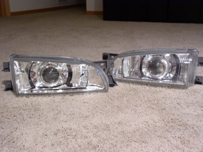

If you have the time and patience I can walk you through it. If not I wouldn't charge much. I also posted a write up on rs25.com http://www.rs25.com/forums/showthread.php?t=41155

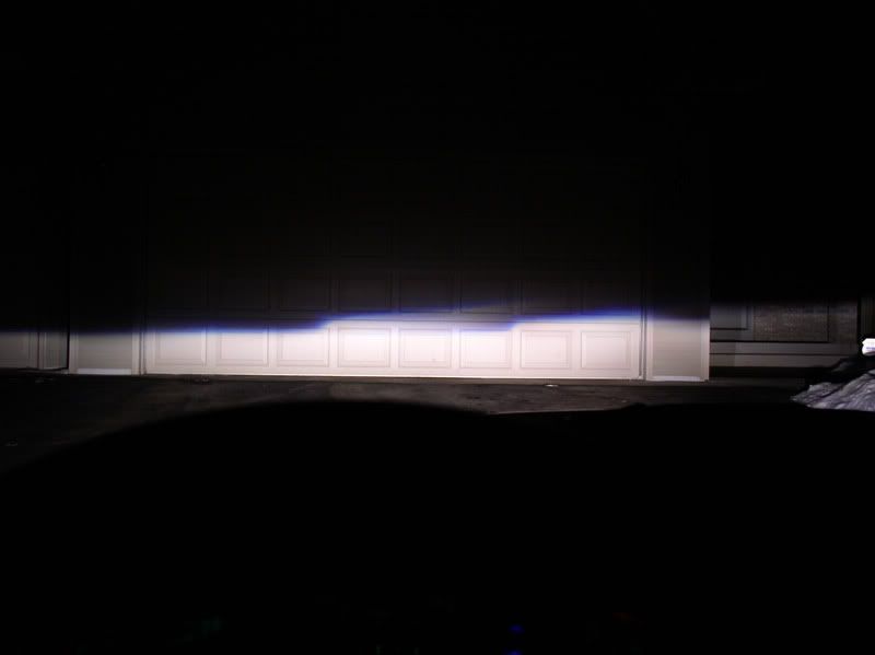

really nice work, before this i had only seen people using the HID conversion bulbs. those things have horrid beam patterns in non HID housings. i will hava to read your walktough
so you're the guy on RS25 that posted this! i wanna see the car in person! fuji and yia also did this mod on their cars but they are still in the makings. fuji and I are trying to make a dual beam projector.
If you can do this with a reasonable price tag I might have to start saving my cash. Send me a pm of how much you would charge and maybe I could send my stuff up to your place over spring break or something
I intially wanted the BMW dual beam look, but it would've require way too much cutting. Plus I wouldn't be able to adjust my headlights using the factory adjusters. I didn't want the projector and bulbs to be sticking out the either beacuse this might cause water problems down the road.
I've been working at it for about a month a so during my winter break. SVX has HUGE projectors so my cutting work turned out to be more than yours. Yours look good! I wished you wrote this project up sooner so I didn't find out to do it the hard way!
STiwannabe, that is a wonderful modification that will have a lot of people doing it to their old skool Imprezas, too. I didnt' know you were so creative, man. I would never have tried that myself.
Well you know me, always looking for something new to do. Can't just sit around and play games all day anymore :lol:
My total cost for the HID parts are listed TSX Projectors $175shipped e46 Ballast/Bulbs/Shrouds $200shipped Screws/Wiring/Misc stuff $20 Dremel Tool $60 I wouldn't say HID would be the end all be all lighting, because you will still need your highs in some cases.
