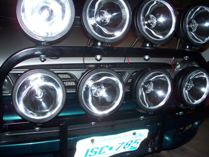

    so i finally got my cheap fogs for my green car but i might have gotten a couple too many, lol. they should hopefully be mounted this weekend :biggrin: i'm gonna blind some people at the ice driving ;) :biggrin:

    uh, that looks like enough for four cars. :) how are you going to mount them?

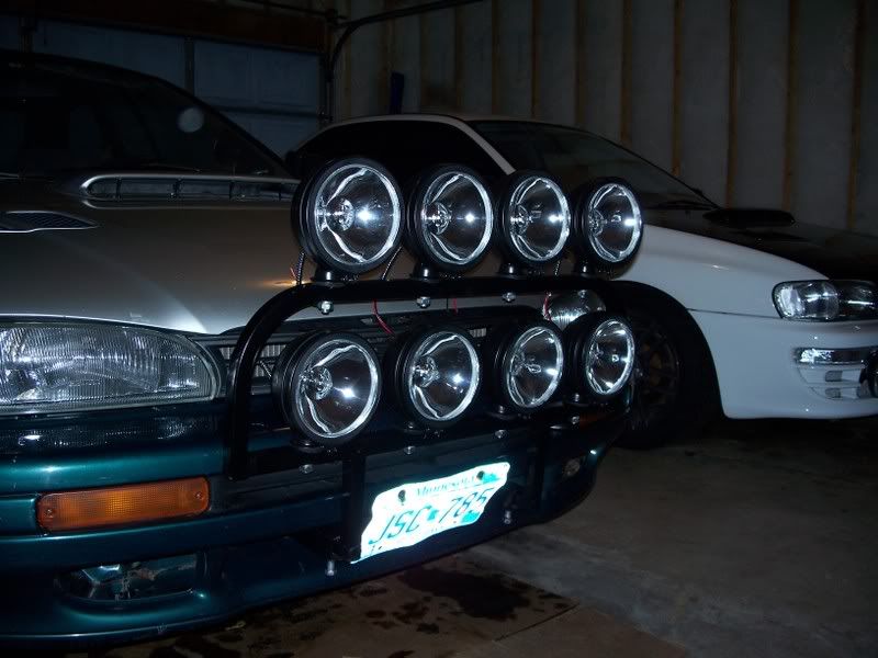

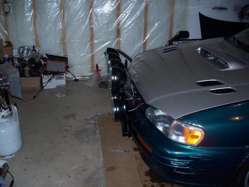

    well i will have to make a special mount for them, it might not be the prettiest but hopefully it will work out well. planning on two rows of 4. my buddy will be helping me, i'm helping him put a tranny in his car and he will be making my mount :biggrin: i will post up pics when i get the bar built.
    8 lights at 130w each :biggrin:

    Something like this?

    that is going to cut off a lot of radiator air flow

    415
    Oh, 8 lights at 130W each is around 80A... That'll kill your alternator fast.

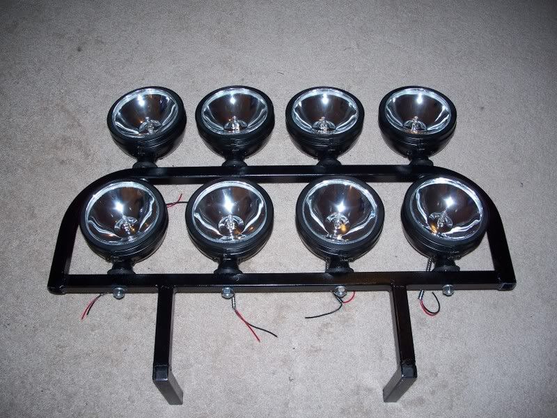

  19. 95lwrx
    95lwrx Well-Known Member
    1,748
    brainerd
    i won't be mounting them in front of the radiator, it will be higher. also i will be doing the wiring so when i turn them on i have control of how many lights are on at a time, so i don't roast the alt right away. and i obviously won't really be using these on road since they will be rather illegal, so it will mainly be at rich's and at the rally races.
  20. 95lwrx
    1,748
    brainerd

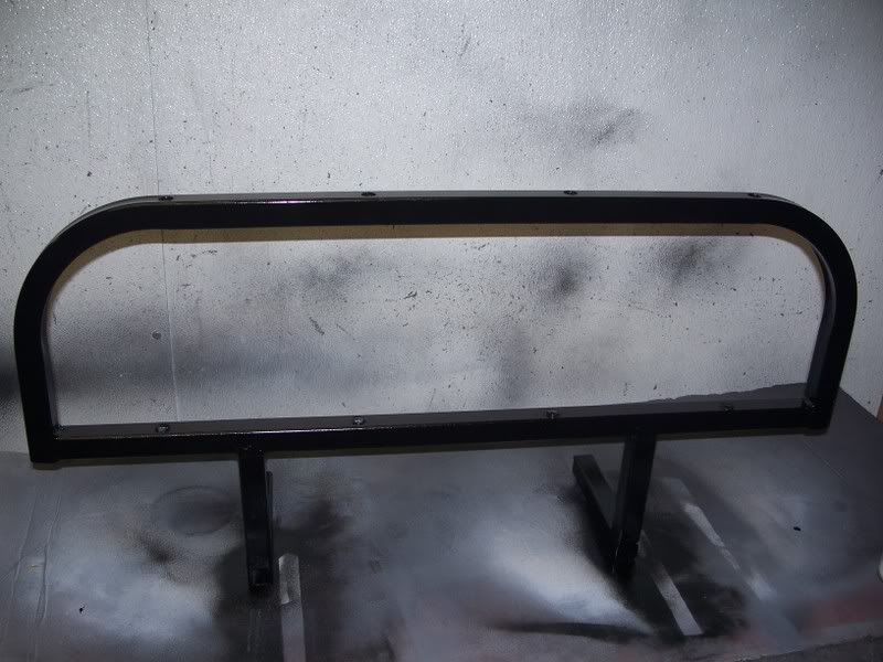

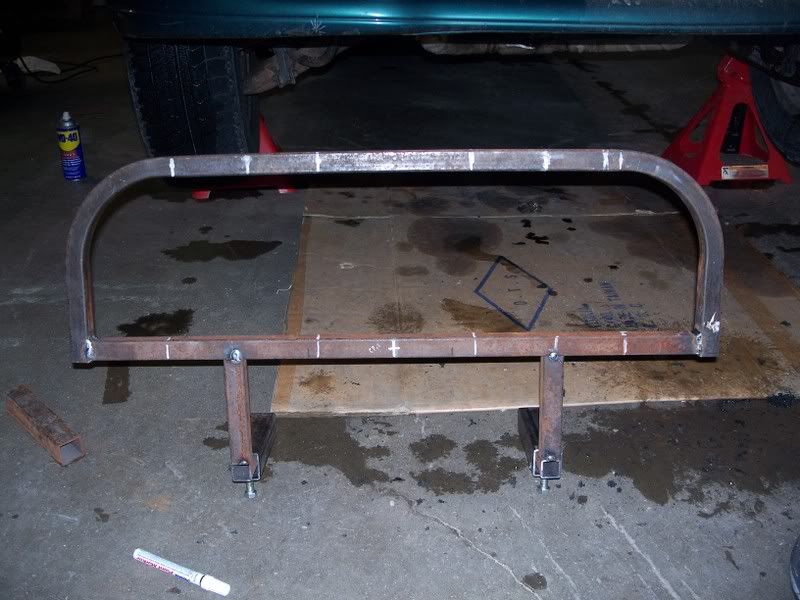

    the bar is done!! pics will be up shortly :biggrin:
    huge thanks to my friend foresterxt on the board(he hasn't posted yet though he just signed up)

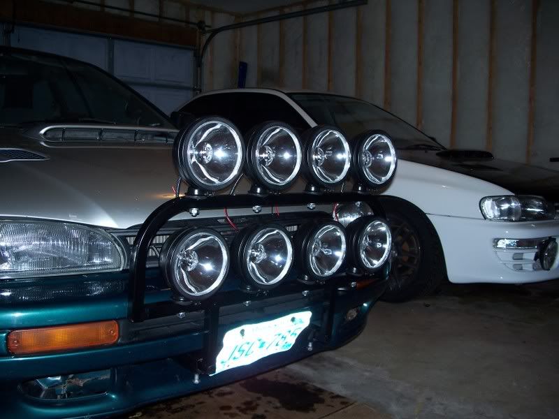

  21. 95lwrx
    1,748
    brainerd
  22. SubieDave
    SubieDave Well-Known Member
    1,939
    South Saint Paul
    What lights are those?
  23. prezawagon
    prezawagon Well-Known Member
    3,438
    49
    Redmond

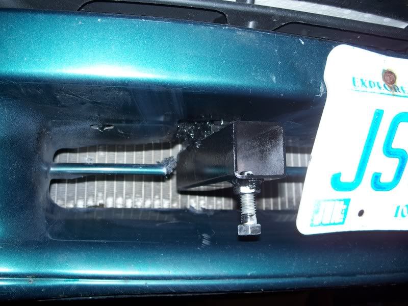

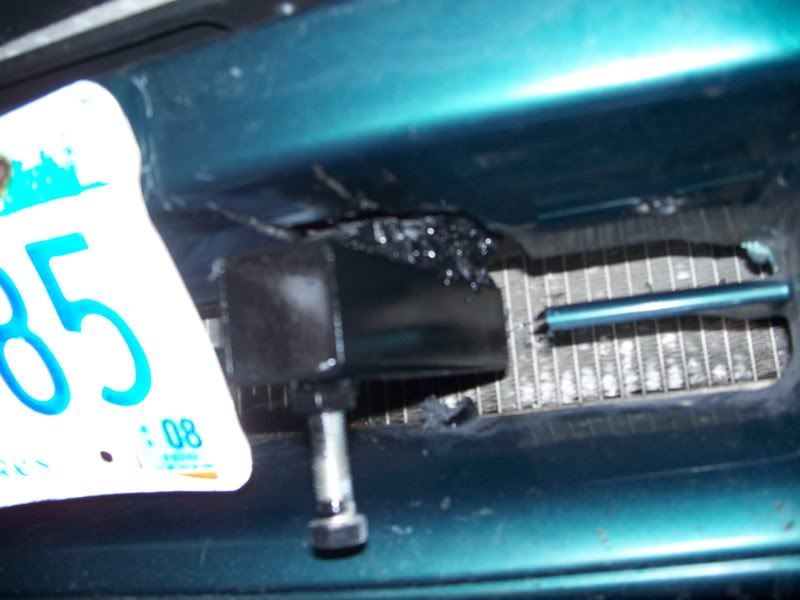

    wow, nuts. I think it's a little overkill with all 8 on there, but that light bar would look really good with just the bottom four lights mounted. Nice job.
    How did you attach your mounting brackets to the bumper beam. Is it welded on there or did you bolt it?

    the lights are ebay specials, and yeah i might just go with the bottom four lights and keep the others for spares. i haven't done any wiring yet.
    the mounts are welded to the bottom of the bumper beam, it was just easier that finding a way to bolt them on.

    I really think those look nice. Now just get them wired up. That bracket sure looks nice. ;) who made that for you?

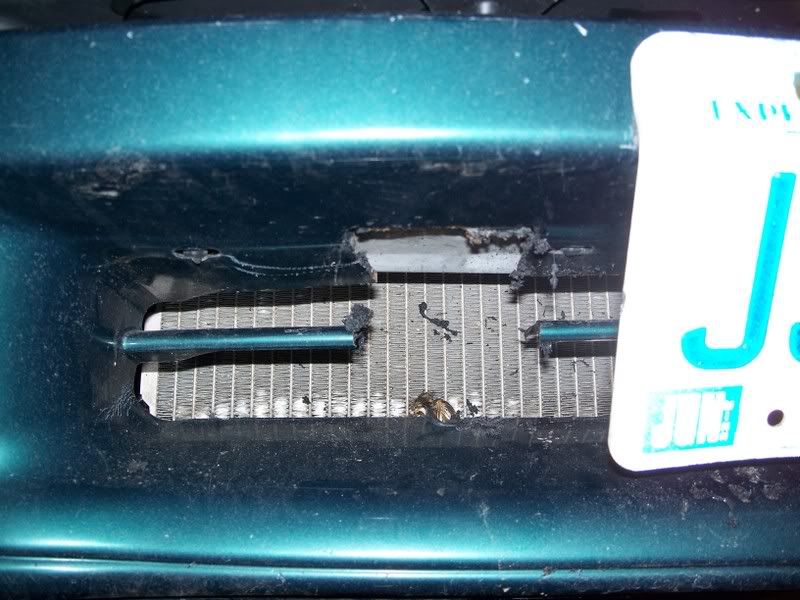

    btw, next time use a dremel when cutting your bumper, not a butter knife
  34. 95lwrx
    1,748
    brainerd
    lol, yeah thanks :biggrin: about time you finally post
    yeah justin it's a little sloppy but oh well, the cutting disc we had was to big and wouldn't fit so we had to go a bit crude, oh well the cars not made to be pretty, lol.
    and this bar is a quick release easy on/off, so i will be making the wiring quick connect also. this whole process took about 3hrs to do. now i just to ge the wiring done.

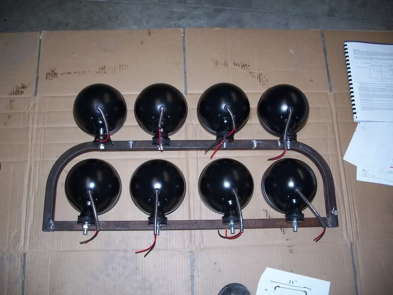

    Here are my suggestions for finishing it up.
    I'll refer to the lights this way:
    ABCD
    EFGH
    The lower set EFGH, leave the stock 55W bulb in them (sometimes this type comes with 100W stock, I'd still swap them down to 55W). The upper set go with 100W bulbs. You can do 130W if you really want to, but you won't actually see any more and they'll cost you more and be harder to locate replacements.
    Incidentally I believe I have at least 4 if not 10 130W H3 bulbs for sale, so if I was just trying to make a buck I'd tell you to go 130W for all eight ;)
    Wire the lights up in pairs, A-D, B-C, E-H, F-G.
    Run one big 4ga ground wire and drill/tap a small bolt to attach it to where the quick attach points are. Actually, this might not be necessary depending on how good the ground is through the frame, but it's not going to hurt, and it'll keep you from melting some poor little wire that could end up carrying a large portion of the current. Then attach the negative wires of the lights directly to the bar with ring terminals and either tap in small bolts or just drill and use sheet metal screws.
    For the power to the lights, run a 12 g or a 10 g wire. 14g will carry the load of even two 130W bulbs without melting, but the lights will be dimmer. You can run 10g wire if you want (I would, but I go overkill). Right off the battery, put an inline 25A fuse. I have at least one nice Hella fuse block I'd be willing to sell at a good price, probably no more than buying 4 in-line holders. But either way. Run the same gauge out to each pair of lights.
    Wiring the switches is left as an exercise for the reader ;)
    Go somewhere where you can park about 50' from a nice large blank wall.
    Aim F-G straight ahead, so they hit right at the bottom of the wall and don't overlap too much. Then aim E-H at the same level, but to the outside of the F-G lights.
    Now, aim B-C straight ahead such that the beams fill in just above the F-G beams. Let them overlap more than F-G however. Then aim A-D such that they're at the same level as B-C again, and again, let them overlap a little more than the bottom row.
    Adjust your distance front he building if you think you're going to be going slower or faster, but 50' is probably a good start.
    On a side note, I have four of that type of light I would sell for like $20 total. They're chrome, not black though (spray paint works...)

    vector thanks for the advice on the wiring. the more i think about it i might just use the bottom four lights, that will be enough i'm sure and if will make the bar more appealing to the eye.
    and then i won't have to worry about smoking my alt right away.
    and these all have the 130 watt bulbs in them already.
    i am planning on doing all the wiring over new years weekend when i have plenty of free time.

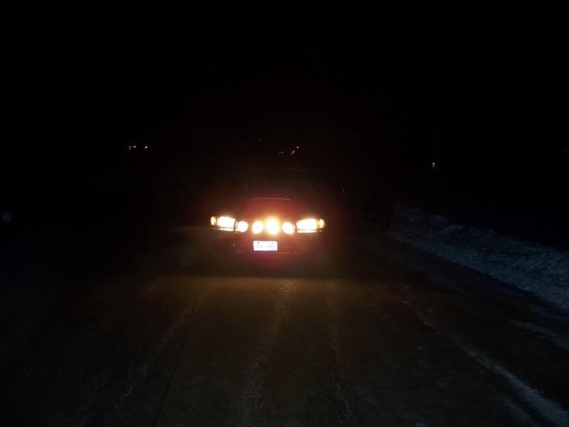

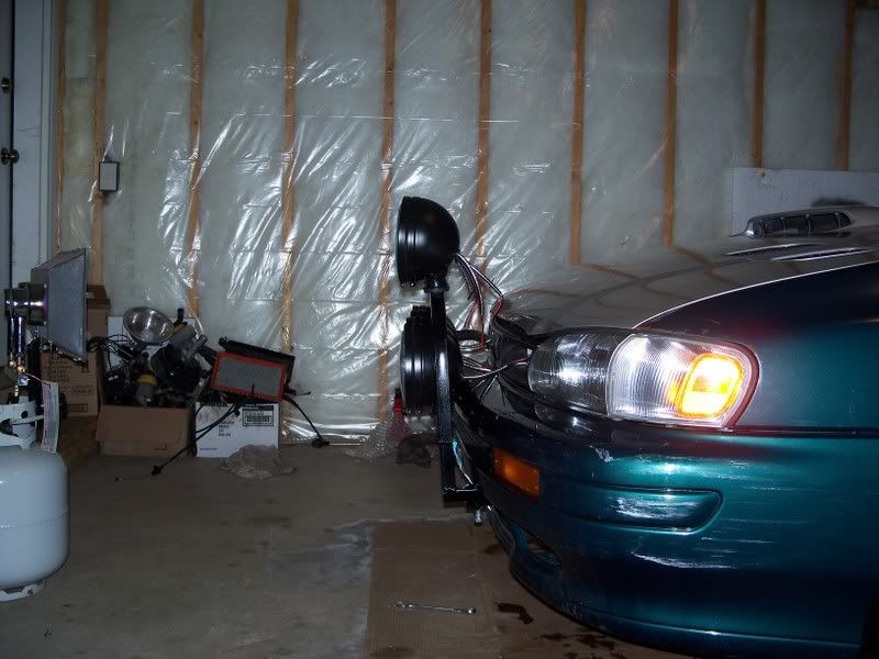

    so i have decided to just go with 4 lights for now. and i got them wired up today, but i still need to fine tune the aiming on them :biggrin:

    damn, looks like the sun is coming at you

    It is fun drive this at night. I did that the first night before most people were there. Got a little worried with some of the driving going on the other nights so I just parked it. I am sure that is what Martin means by dangerous driving.

    as far as the night driving being dangerous, i have a feeling it will be much safer this year with all the snow that is up there. kinda limits on the recklessness, i think i will hold off on the other 4 for now, these will be enough and that way i won't have to worry about my alt.
