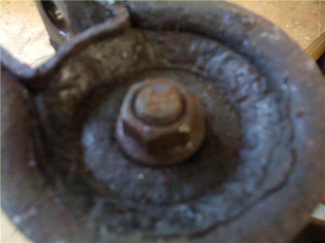

    This will be good for you STi guys. With the inverted strut configuration Subaru is using for their STi struts, one thing has come to light: They collect dirt. Moreso to the point, the craptastic grease in them collects dirt. This will oftentimes lead to clunking and binding in the rear struts. How can you avoid such catastrophe? Repack your struts with Synthetic Grease and replace the worthless lube they come with from the factory.

    Step 1:
    Remove the strut from the car (if necessary). I will not go into the removal an install of this, but may do a writeup on that later.
    Step 2:
    Take the strut to an area where you can work on it without a lot of dirt/dust contamination. Flip the strut upside-down and remove the 14mm nut on the bottom. I have found that sticking a prybar or screwdriver through the lower mounting holes gives you something to torque with. Set the nut aside.
    Step 3:
    Flip the strut back over and slide it out of the lower housing. Clean off your bumpstop (factory grease is yellow, make sure you get rid of it) and set the strut assembly aside.
    Step 4:
    Take your stick/dowel and scrape the old grease off the inside walls of the strut housing. Get it fairly clean by taking rags and plunging them down through the housing. If your stick/dowel is thin enough, you can push the rag back through from the bottom. Use the rags as a finishing touch, don't rely on them to do the major cleaning or you will have a mess on your hands.
    Step 5:
    Clean off your stick/dowel and use it to apply your new grease to the 3 grease channels inside the strut housing. It doesn't have to look pretty, just make sure you've got enough.
    Step 6:
    Take the strut assembly and plunge it in the housing to pack the grease and burp any air out of the strut. Remove it and check inside to make sure you've used enough grease. Repeat Step 5 as needed.
    Step 7:
    When you're ready to re-assemble, make sure you align the threaded end of the strut with the slotted hole on the bottom of the strut housing. Give it a final burping before putting the nut back on. I like to plunge the strut halfway down, then all the way down twice. Thread the nut back on the bottom and torque it.
    Here is where things get optional, you can either add your springs to the assembly before Step 7 and try bleeding your strut with your springs on or remove the tophat and install it that way. If you're skinny like me and only have 140 lbs of weight to compress your strut/spring combination, you will opt for tophat removal.
    Step 8:
    Remove your tophat. There is a little cover on the top, just pry it off and expose the 17mm nut on the top. Generally a nice electric impact wrench will remove it for you, otherwise you may need to get creative with holding the strut or using an allen key and wrench to twist it loose.
    Step 9:
    Put your spring on. Make sure that the end of the spring nestles into the lower spring perch. You will see where it is supposed to go.
    Step 10:
    Re-install your tophat. These are directional, so make sure that the outside stud lines up with your lower strut mount. It will usually have a marking on the top to the effect of "4WD OUT" marked on it. This stud faces outward. Torque your nut back down.
    Step 11:
    Install your newly repacked struts into your car and enjoy clunk-free driving.
