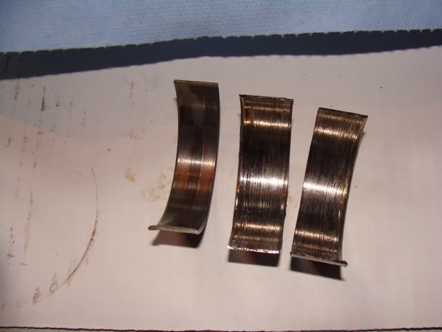

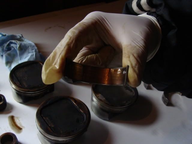

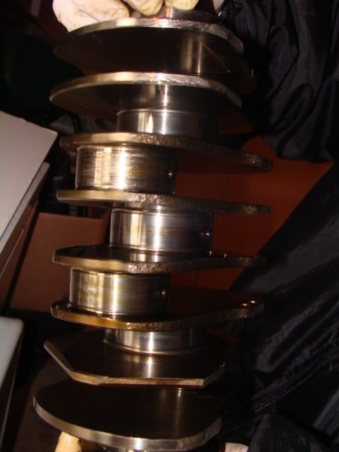

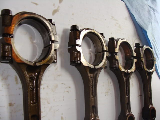

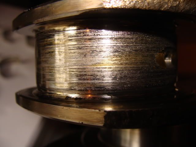

    This is my '98 RS motor that had rod bearings issue when I was up in MN, for that DCTC event with Musashi, Fuji and them guys. Well, I finally had time to tear my motor apart and this is what I found.

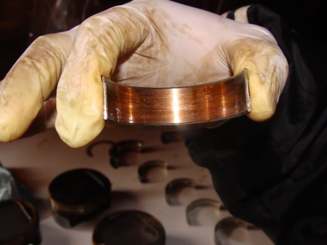

    This was the one where I was wondering why it's missing the notch at the tip of the rod bearings. Now I know why.

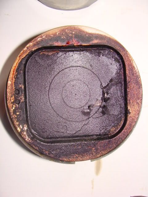

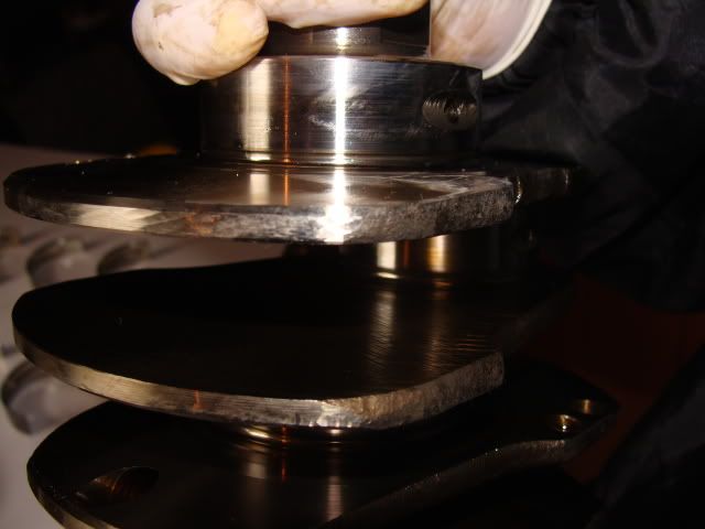

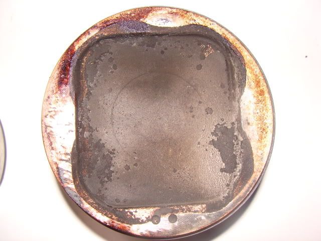

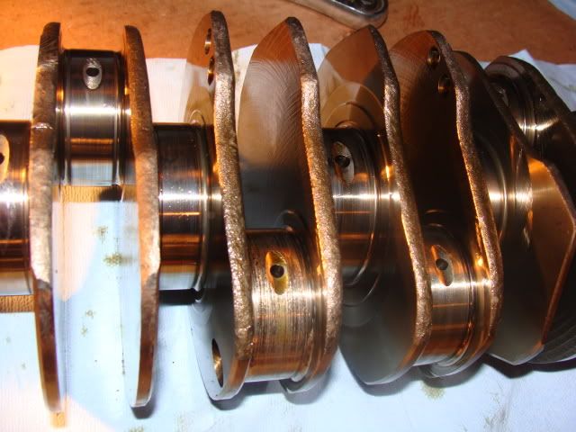

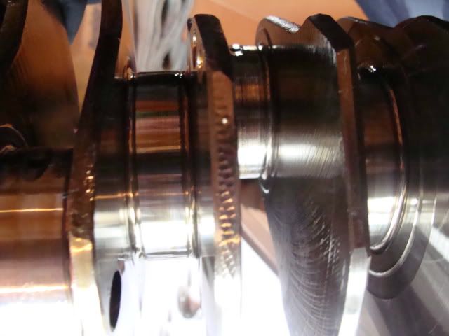

    The crankshaft, it was chipped and had a few scuffs on it. Which means I need to buy a new crank T_T. As for the pistons, I was running too rich and started to detonate?
  2. Nuke
    6,155
    Saint Paul
    If oil was being burned, it would detonate also
    *i think*

    You can get your crankshaft repaired, it might be cheaper than getting a new one.

    It would not detonate if oil was burning, it also would not detonate if it was running too rich. My guess is the problem lies in your oil changing habits, Everything looks pretty burned, like it didnt get oil changes enough.... or perhaps the owner before you. SOME 2.5 DOHC na motors are insanely fragile for no reason.

    I thought about taking the crank to a shop to have them resurface it. Just don't know WHERE they do that here.

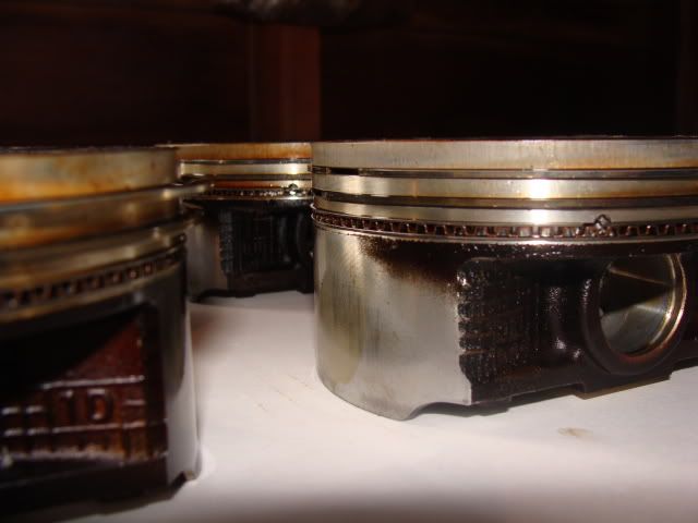

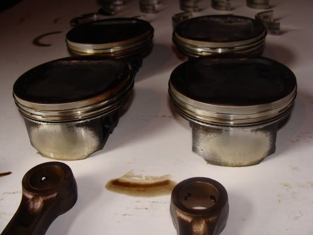

    As for the pistons, I'm thinking I can pretty much clean them and use them again?

    if you had a spark related misfire where you had bad gas mileage you probably got lots of gas in your oil, that would explain the rod bearing easily!

    15W oil and regular changes could have prevented that, that is just not enought lubrication or oil starvation. my .02
