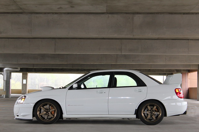

    And It broke the 3rd day I owned it :*(
    One cylinder lost a crap ton of compression, friend currently is working on pulling it and I'm hoping for the best.
    It was a lot of fun though the 2nd day, I drove it a decent amount! :D
    I miss it.

    Sounds like a turbo to me. Nice looking car, good luck.

    Welcome and sorry to hear that... Love the white.

    Sounds like another piston failure. What cyclinder. Assuming the ring land failed, other than using forged pistons on the rebuild, i suggest going with stronger head studs (if you plan to run high boost in the future). You might consider a new oil pick up as well. Good luck and keep us posted. White 04 STi's are one of my favorite subarus.
