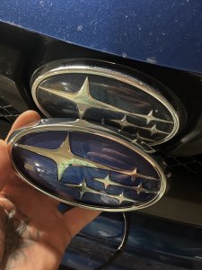

    Ended up ordering the JDM version from import image racing for ~250$
    Come to find out the badges are exactly the same size! Yay!

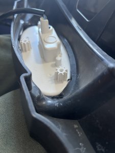

    only took me about 6 hours (mostly because the battery in my dremel was dead)

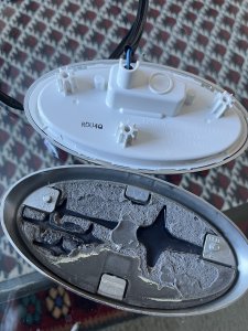

    Comparison of the back side mounting surface differences “img_978”

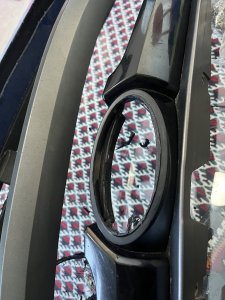

    cutout required on the front most bezel “img_980”

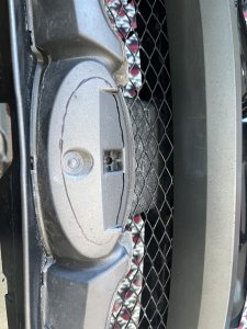

    This needs to be removed from the main bezel with a couple #1 screws that are probably hella rusty.
    cutout template of the rear, further in bezel. This was the starting point, a lot more needed removal, which took more time with my dead dremel. “Img_979”

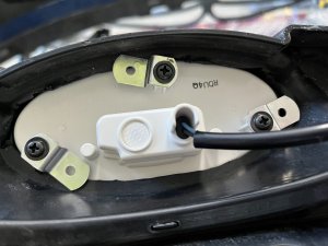

    Bezels remounted together and what it looks like from the rear. “Img_982”
    I ended up using little brackets from picture frames (there’s a framing store down the street from me) these are 1/4” brackets and they worked absolutely perfect. “Img_983”

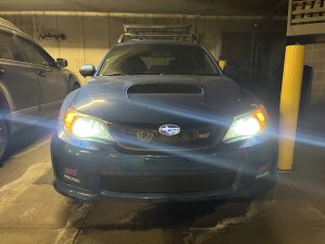

    What it looks like in the garage “img_985”
    I ended up splicing it in with the fog lights because I always have them on and always want this on. Plus splicing into the HID harness sounded like a pain I wasn’t willing to overcome.
