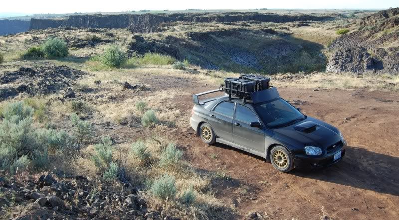

    Ok, so some of you that have met me, know I'm interested in getting a bit more space between the wheel wells. (2015 STI)
    I'm not trying to get a monster truck lift here....just trying to gain a bit more clearance.
    Lets face it, we live in MN and I for one like to partake in vehicle adventures of all kinds. So with that said, how do STI or WRX owners gain a bit of lift without major race type modification?
    I am new to Subaru's and am doing research on my own of course, but figured I would try the pool and see how the water is. (it cant be all just rim and tire choices can it?) (and is spacers even a answer/choice?)
    This is what my idea of an STI should be as far as "stance":
