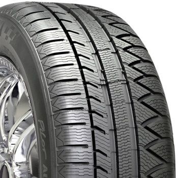

I'm going to be looking at winter wheels on saturday for my 2011 sti, they are evo 8 enkeis that have michelin pilot alpin pa3 tires(235/45/17) on them. they all have 7-8 32nds tread on them and they come brand new with 10.5 32nds tread so they are pretty new. one has a tear in the sidewall which is un repairable. so my question is they don't make the pa3 anymore, I'm trying to see if i can find a new one left in stock somewhere. So if i buy the wheels and put on a 10.5 32nds tread tire on the one and the rest have 7-8 32nds will that do harm to any of my differentials or transfer case? and if i cannot find a pa3 could i put a pa4 on and not have to worry about it this winter? Thanks in advance! here is the difference between the pa3 and pa4. Pa3: pa4:

Justin Tillus @ Vision Speedworks can shave tires. Most dedicated snow tires have dual compounds. The best sticky stuff is usually gone at 6/32s. After that you are left with what equates to a good all season tire. It might not be worth the expense to go through all that for just a season or maybe two of useful tire.
