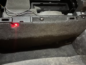

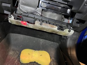

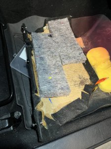

    No glue or anything. I was kind of expecting it to be heat fit and melted in or to have some lip that it needed to over come that once it's pushed in it doesn't come out. Was fully willing to take the Dremel to it to get it out lol.
    Thoughts here.
    I reached out to A-premium and to another company that produces them on Amazon, to see if they could produce a brushless upgraded motor for these. I understand it's different and requires a controller, but I feel like they could figure some of that out.
    Either that or some website was recommending a varnish? for the electrical coils? I was confused.
    Or just a clean up and lube.
    I'm going to add some sound deadening to my fiberglass assembly later to see if it drops the dB.
    Will report back.
    Adding pictures of that here so that they're all in one place.
  15. Superglue
    Superglue Well-Known Member
    42

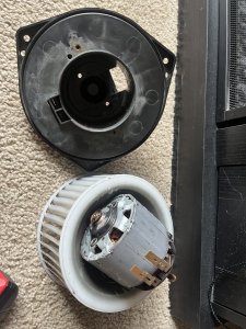

    I opted to put the stock one back in after ripping it apart.
    I aggressively lubed the motor and carbon pads pushing on it, as that's where DC motors get that noise from.
    Added some sound deadening material to the cover I made.
    Started at 50dB average with the A-premium motor, roughly same with stock.
    Dropped to 37dB with the lubed and covered factory motor!
    will likely have to service more frequently with collection of dust from the grease, but it's a price I'm happy to pay, for some piece and quiet
