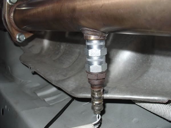

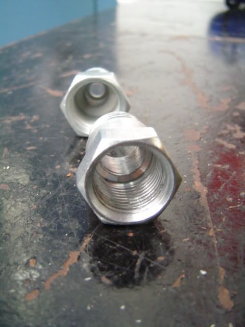

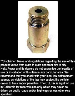

  20. EtchyLives
    EtchyLives Well-Known Member
    Downpipe sensor can be bypassed with two spark plug anti-foulers stacked on top of one another with your O2 on the end of them.
    Serious as a heart attack.
  21. PaulasaurusREX
    Sweet
    Yup that is exactly what I am looking for.
    I assume the spark plug anti-foulers can be had at any local auto store.
    Thanks for posting that up Etchy. Very infromative post
