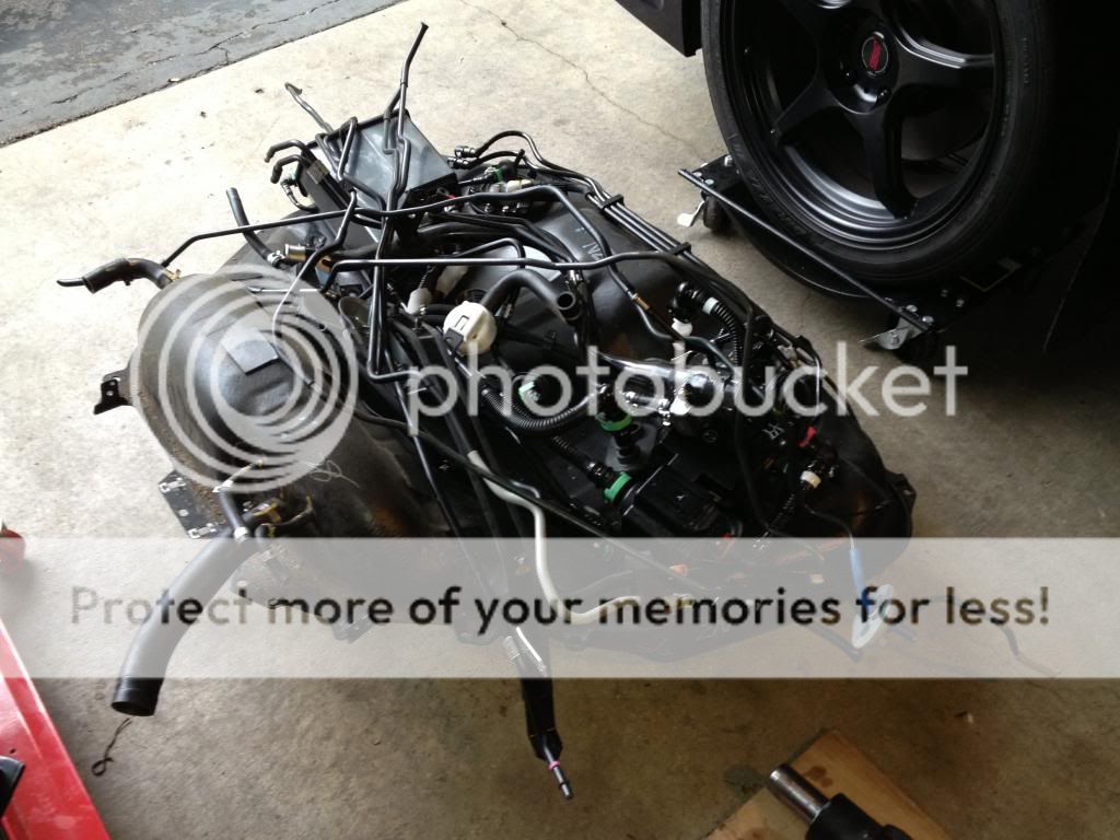

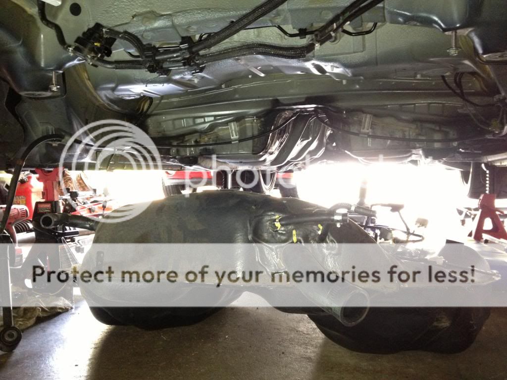

Thanks man! I almost gave you a call last weekend, I could've definitely used a hand dropping the fuel tank...

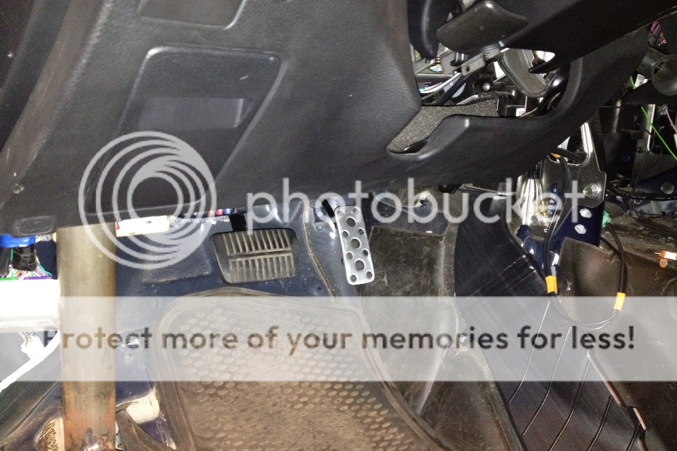

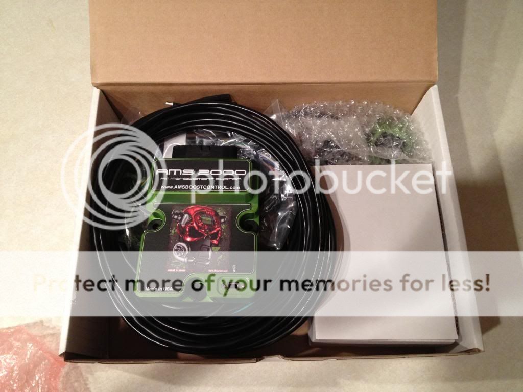

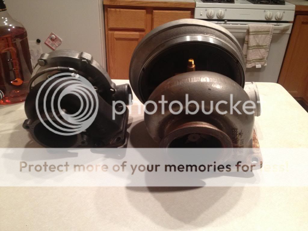

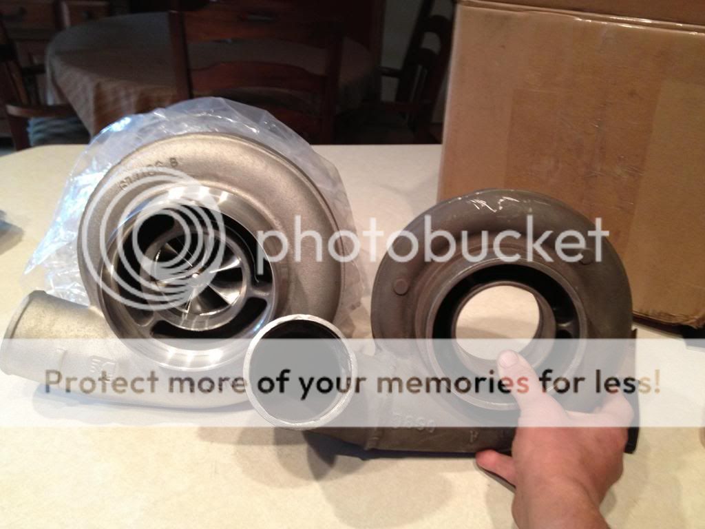

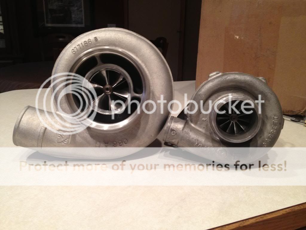

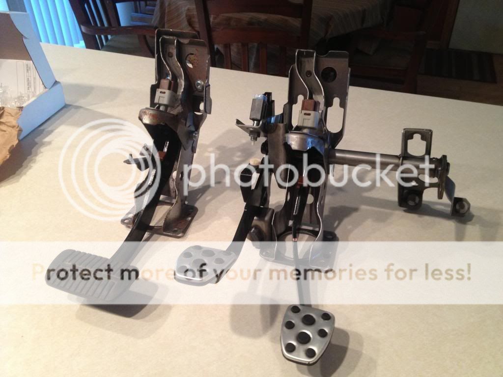

Ok, here's a few more pictures of some of the things I've done so far. After I pulled the motor out of the 04, I ended up finding out that it needed new cylinder sleeves, so the block is currently at L.A. Sleeve having that done. I spoke with them today and it sounds like they'll be shipping that back to RS Motors some time next week. Here's what the engine will consist of so far- EJ22t closed deck block L.A. pro cool sleeves 100mm CP pistons Pauter x beam rods Manley turbo tuff billet crank CNC ported version 8 heads Supertech inconal exaust valves +1 mm Supertech intake valves +1 Custom made Kelford cams Once I had the BW s374 turbo out, I shipped it down to Forced Inductions for a billet 76mm etr-ho upgrade. They replaced the 74mm compressor wheel with a billet 76mm, and put a race cover on it. The first picture shows the 76 etr-ho next to the original BW s374 compressor cover, and the other 2 pictures show it next to my gtx3076r. And for managing the desired boost level of those turbos... an AMS 2000 pro boost controller. Since I won't be needing that 3rd pedal anymore with the auto transmission, I found an auto brake pedal assembly on ebay. I think it came off an 09 Forester or something like that. This would've been a much easier install before the roll cage... lol Removing the stock fuel system. And here are a few more pictures of the transmission and other drivetrain parts I'll be reinstalling soon. That's all I got for right now. Thanks for checking out my thread, I'll try to update this occasionally with any new progress!

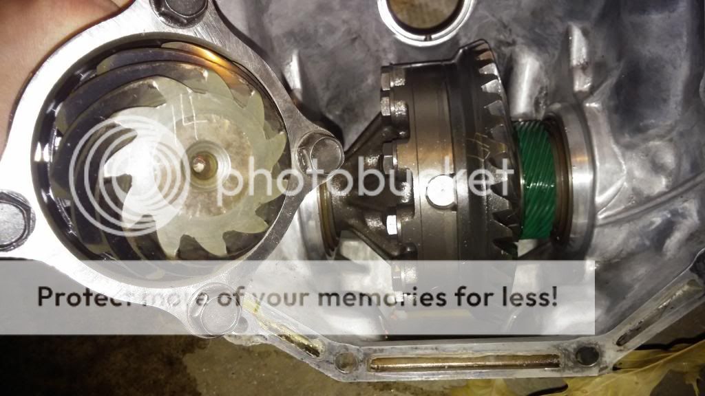

It's been pretty slow going lately. There's a couple things I'm waiting on with the motor, and I'm trying to find 3.54 front gear set for the transmission so I can start putting stuff back together. Ive been working on a few things lately though, I'll try to post an update this weekend maybe.
I'm not giving up now, that search is getting personal! I already bought one 3.54 front gear set from a guy on Ebay, and the ring and pinion weren't even a matching set. One says 14, and the other says 47... If I change my mind, you'll be the first to know though.

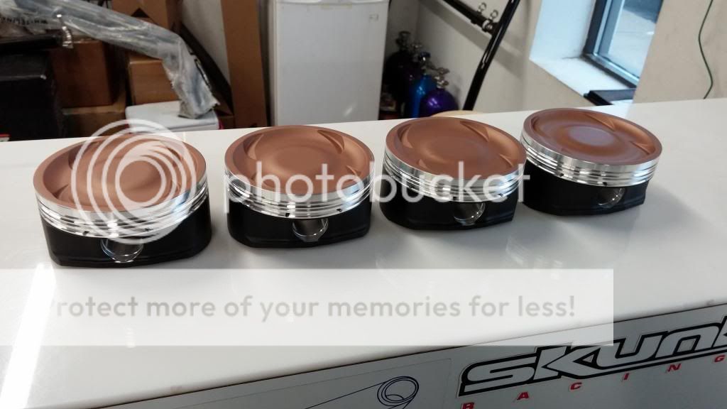

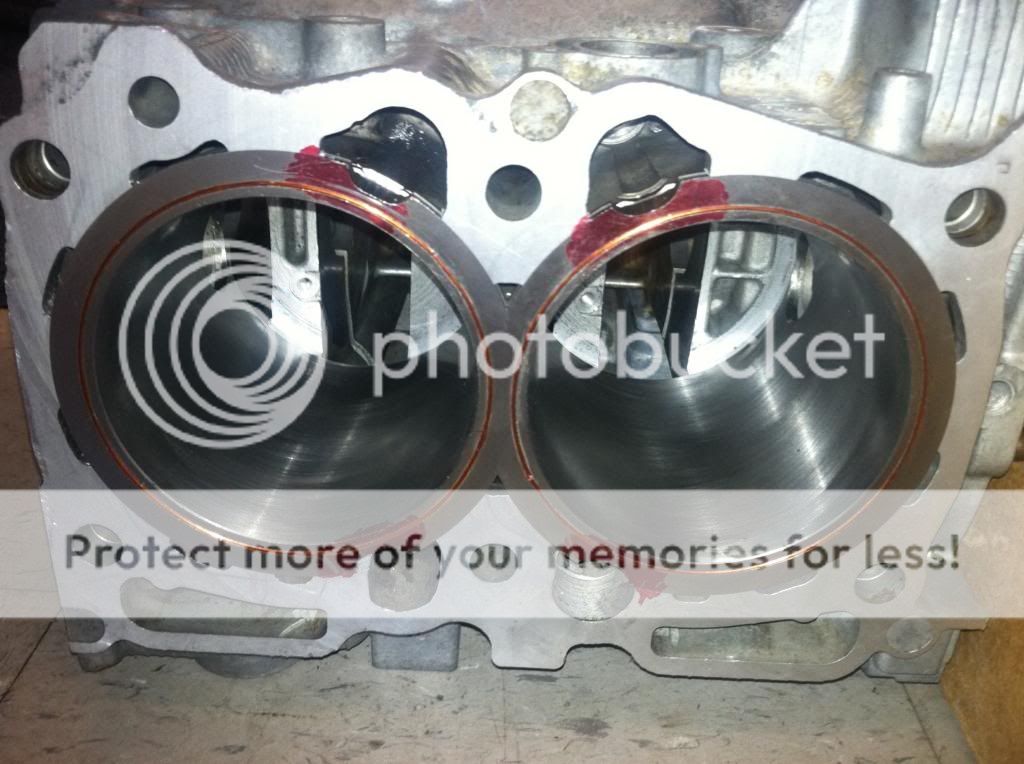

Here's a little update of a few things I've been working on, I'll start with the motor. I got the block back from LA, with the new sleeves and coated CP pistons I bought through them. After getting the block back, it went in for some o-ring grooves, which just got finished up a few days ago. Now it's just waiting to get CNC'd for pinned mains, and get tapped for larger 1/2" head studs. I still have to order the new crank and oil pump, and then it should be ready to go back together.

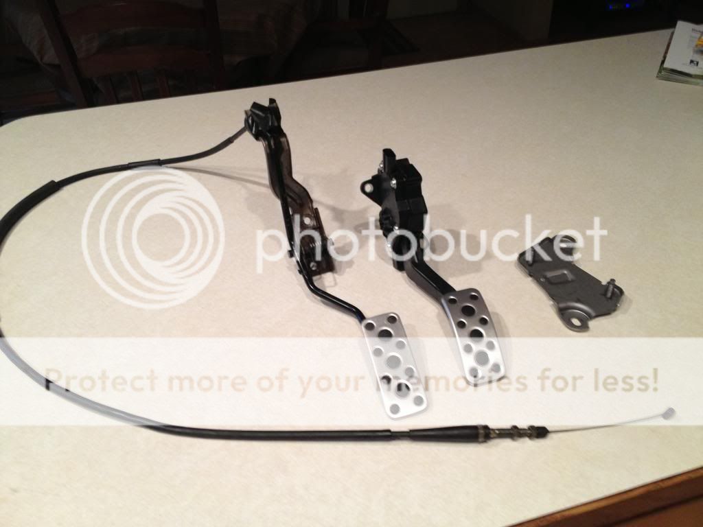

I'm switching from a drive by wire to drive by cable throttle body setup, so I swapped the gas pedal from 04 to the 12. The mounting hole locations were different, so I had to drill some new holes into the mounting plate, and drill a hole through the firewall for the cable to go through.

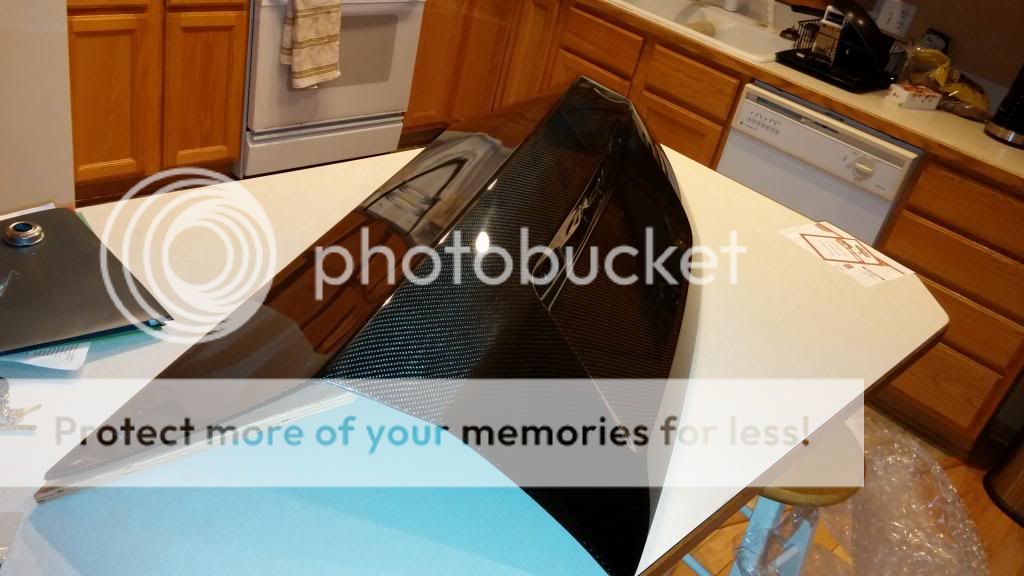

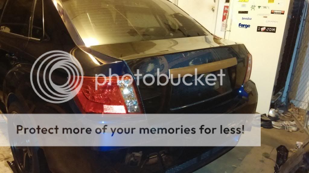

Some of the weight reduction stuff I've been working on. I really liked the quality and fitment of the Seibon carbon fiber hood I already had on the car, so I bought one of their trunk lids to go with it. I still have to shim it a bit to get everything lined up perfectly, but fitment was great. I don't really like the look of the silver trim with it, I'll probably plasti dip that, or have my buddy Vinnie wrap it in vinyl for me.

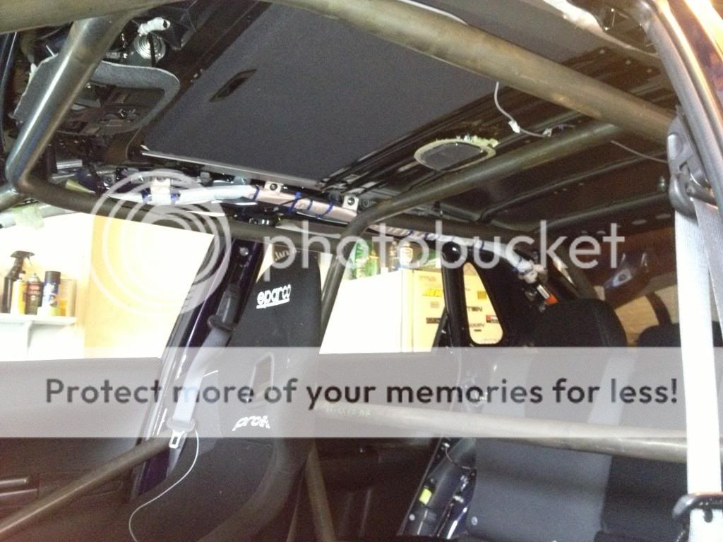

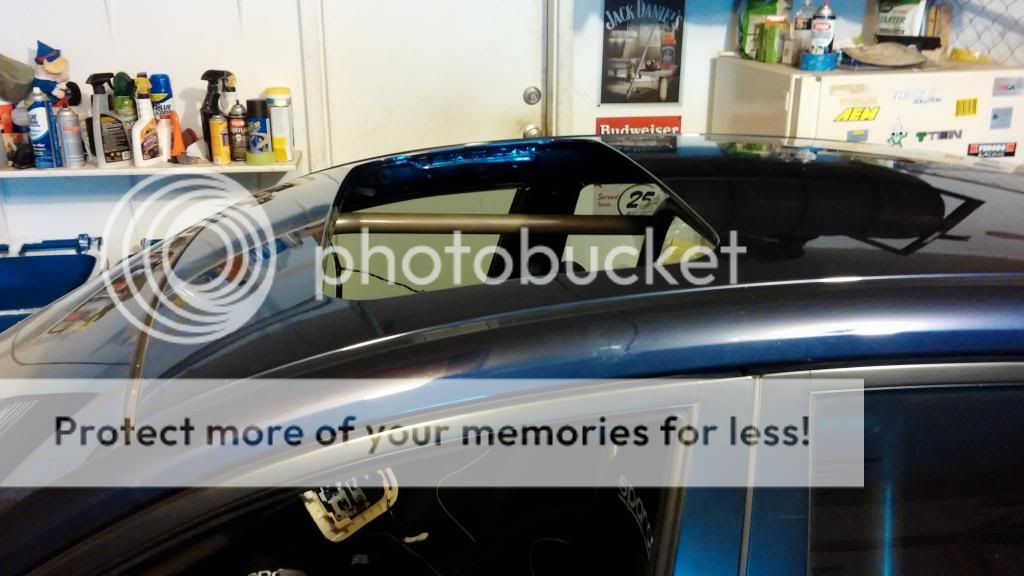

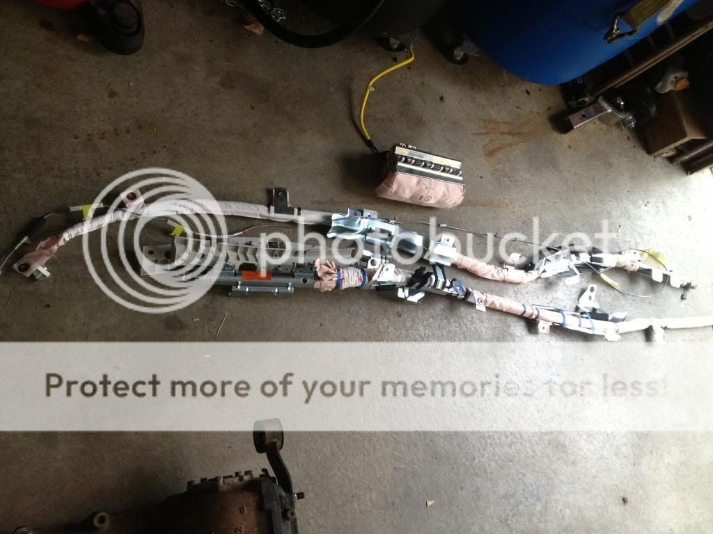

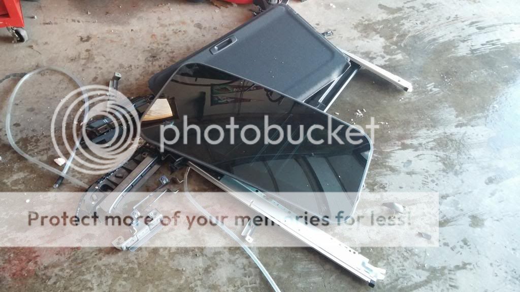

I wanted to get rid of the sunroof weight so I found a company called Ultra Carbon Fiber that makes custom sunroof delete plugs at www.lighterfaster.com. I had to remove the sunroof and trace a template of the hole and take measurements to send them before they could start making it. It'll probably be a month or two before I actually get it, but I'll post install pics when I do. Unfortunately with the roll cage in the way, a little bit of destruction was required to get it out but I was able to salvage the motor, if anyone needs a sunroof motor. The weight of all the sunroof stuff was around 29 lbs, not as much as I thought it would be, but it was still a good amount of weight up top. I also removed the side curtain airbags while I was at it, and the rest of the airbag system.

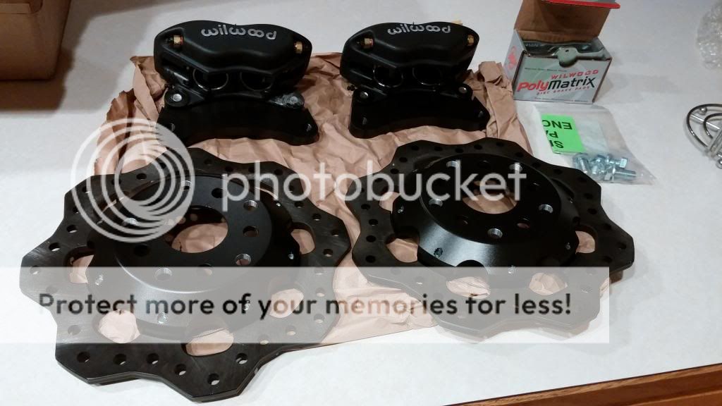

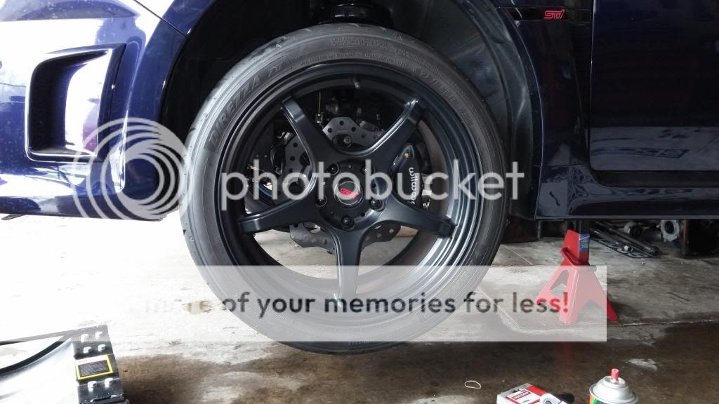

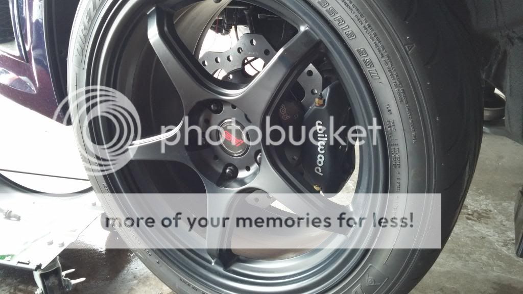

I sold the stock Brembo brake system and bought a P&L/Wilwood lightweight brake set. I have the fronts installed, but I'm waiting for them to make a mounting bracket for the rears. The kit includes rotors, calipers, pads and brake lines. Weight loss in the fronts alone was around 42lbs. By the way, the wheel setup in these pics will be for sale this Spring. Mach V 18x9.5 wicked awesome wheels with Direzza ZII 275/35r18 with only around 2-3k miles on them.

Thanks Josh! Brake Man makes something similar to that brake kit for our cars, but it's more expensive and I think the P&L/Wilwood one might actually be a little lighter

Thanks Ben! I was a little surprised about the weight difference in the front brakes. The rears require removing the e-brake, I'm curious what that stuff will weigh too. Lol it's all good man, my garage was colder than any sane human being should be working in anyway...
