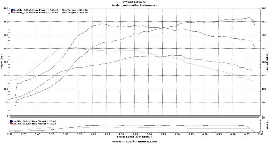

    Being a big contributor to the 68HTA thread posted by John@Cobb. I decided to actually see what we can get out of the 68hta on a stock 2.0L WRX. Now, when I say stock... I mean stock. No built bottom end, no porting, no crazy intake manifold, not even an AFTERMARKET intercooler. (Not yet )So, we got bored tonight. Changed the oil, tightened up some clamps, strapped her down on the dyno and went to town.
    Just a quick run through of the mods:
    -Grimmspeed Wastegate Bracket
    -Grimmspeed External Wastegate Up-pipe (TiAL 38MVS)
    -Grimmspeed High Flow Cross Pipe
    -Grimmspeed Electronic Boost Control Solenoid
    -DeatschWerks 800CC Injectors
    -Forced Performance 68HTA
    -Samco Intercooler Hose Kit
    -Greddy Ti-C Comp-C Turboback
    -Walbro 255lph Fuel Pump
    -TurboXS Intake
    -Custom Catch Can
    So here is the numbers:
    Stock VS 68HTA
    68HTA Current Numbers
    Just in case the typing is too small.

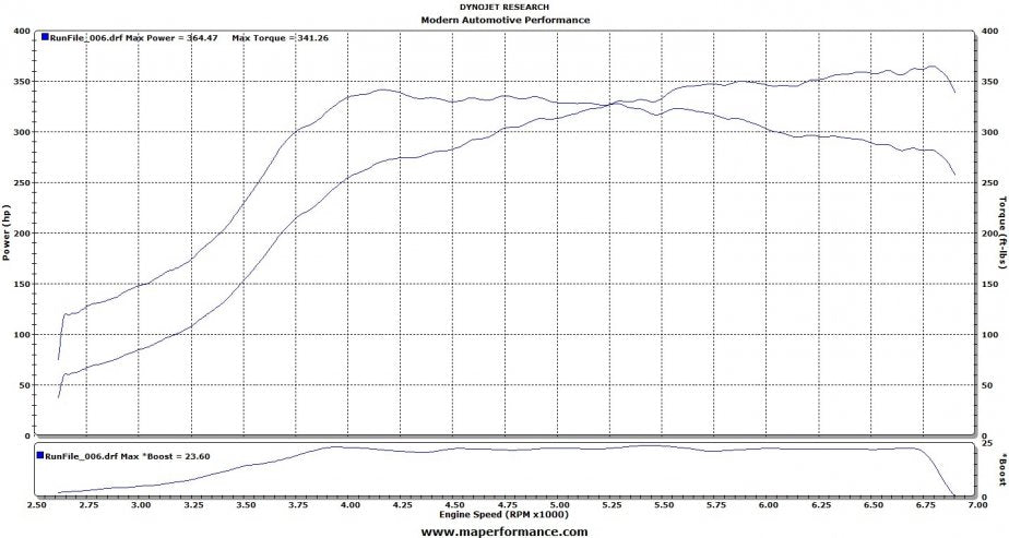

    Stock - 224.95 WHP / 254.80 WTQ
    68HTA - 364.47 WHP / 341.26 WTQ
    Now as you can see, the rumor of boost tapering off is all in the tune. We held a solid 22-24psi across the board and it had more in it! Not to mention the peak power was had at 6750RPMS! This is proof in itself that the turbo can hold its own when its put in the correct hands. It spools great, has power whenever I need it and has yet to fail me.

  4. Adam@MAP
    Adam@MAP New Member
    Nope. 224 was with a tune. Turboback. Drop in filter. Max boost with stock solenoid and wastegate. Agency power bov cranked all the way down.
