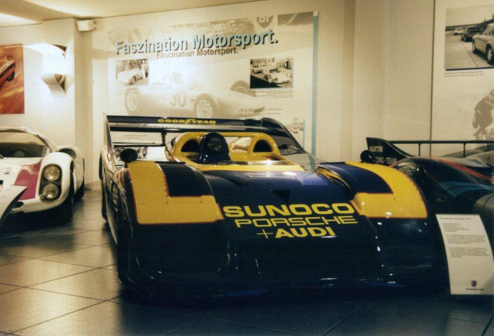

  6. w_o_t_boy
    w_o_t_boy Well-Known Member
    1,114
    Seattle
