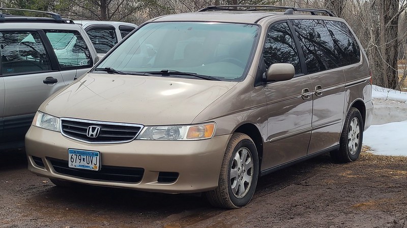

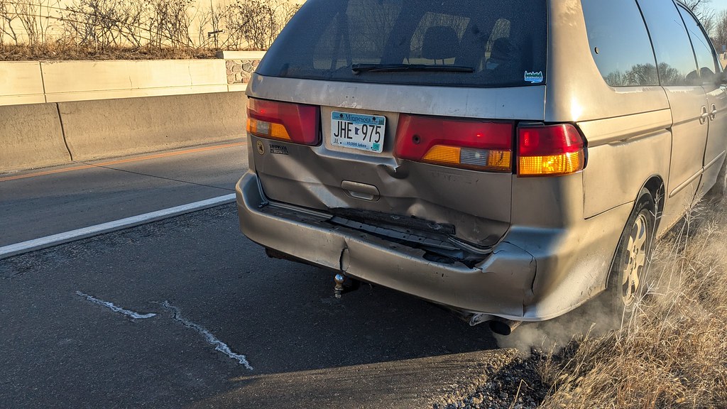

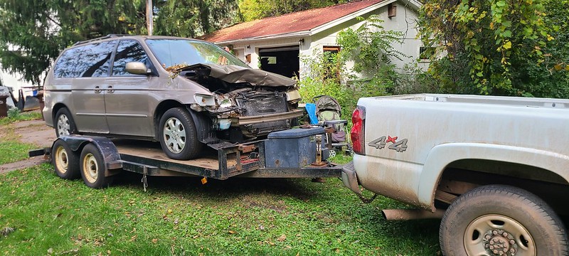

    My dad has had this van for more than 100k miles. But, he hit a deer on I-35 near Pine City this summer...
    He bought a "new" van, and was talking about selling this one for scrap. So, last weekend:
    20210926_095733 by Numbchux, on Flickr

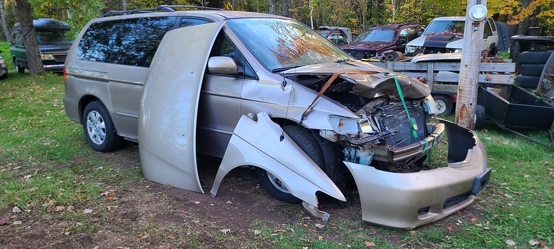

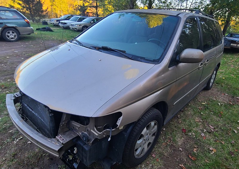

    I stopped at Upull on the way home, and got a bumper, hood and fender, in color:
    20210926_174424

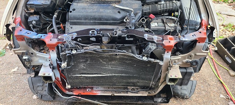

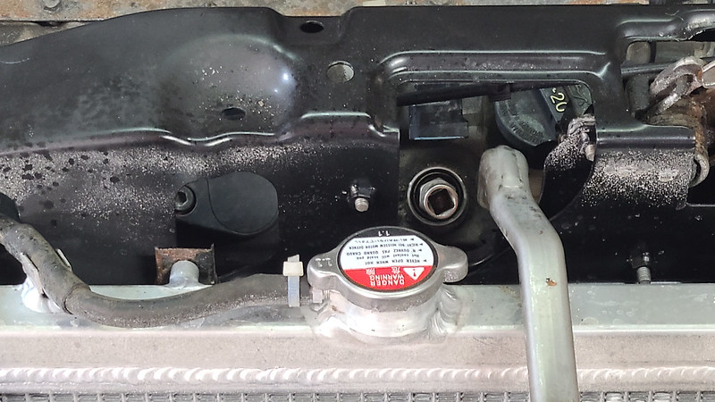

    On Tuesday, I spent some time cutting the damaged crap out so I could make a parts list and start sourcing what it needs. I bolted the good hood to the hinges:
    20210927_181532
    Core supports came in to Krenzen Honda today, I'll pick those up after work.

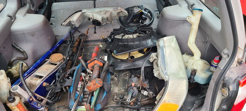

    UPull had their Pull-a-thon last weekend. Everything you can carry 20 feet for $75.
    I got a pair of headlights, both fans, all 3 reservoirs (coolant, PS and washer), radiator mounts, condenser mount, and OEM transmission cooler (used on dealer-installed trailer hitches). As well as a diff lock motor for my Tacoma, and steering wheel for my Celica.
    [​IMG]20211002_115339 by Numbchux, on Flickr

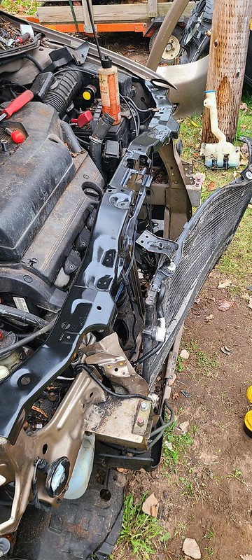

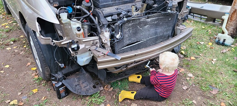

    My son "helping" me remove and/or straighten the damaged:
    url=https://flic.kr/p/2mzMUCD]20211007_181749[/URL] by Numbchux, on Flickr
    Test fit with the new upper support. If you look closely, you can see that the vertical support on the other side is pushed back an inch or so. But I was able to straighten this one out enough.
    20211008_173741
    And, welded in. The red spots are primer over the welds. I don't have a spot welder, so I did a bunch of stitch welding on the edges, and drilled through one layer for a plug weld in some places. Used weld-through primer on the sections that would not be accessible once assembled, then implement primer and black paint over the top.
    2021-10-18_10-03-05

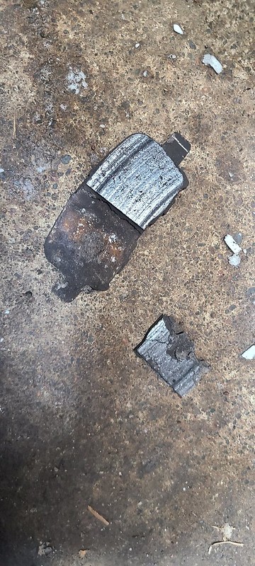

    Brake pedal feel was awful, and rear brakes made a horrible noise. But, I found a box of new pads in the van, apparently it needed those before. Thanks, Dad! I decided to slap those in and inspect the other components while I was at it. One of the LR pads had separated, and half the friction material was wedged between the rotor and caliper bracket. That would cause some strangeness!
    20220204_142014

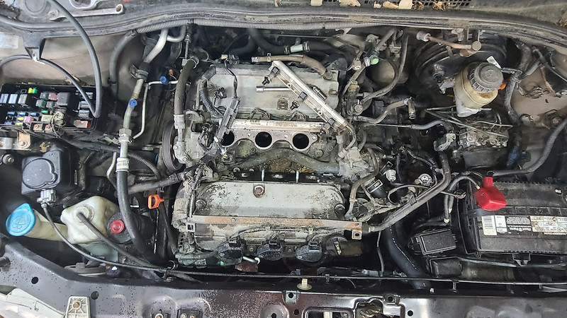

    One of the error codes is for a knock sensor. I was able to see that the wire was severed, but it's a much bigger job to get down in there to replace anything:
    20220208_131656
    I got the gaskets and such ordered up. The knock sensor itself is a sub harness, and the Honda replacement is cheap ($8 or so), and apparently comes with a rodent-repellent sleeve over it.
    There is a fair bit of oil in the intake, and the EGR passages look awful. So some deep cleaning and a new PCV valve will be happening.
    I replaced the spark plugs, too. Honda does a really good job of making maintenance items accessible. There's plenty of room to get the rear bank plugs out without removing anything. There are 2 front cylinders that are kind of close to the radiator support, but they put a hole in the support that you can pass a socket extension through.
    20220208_135658

    Spark plugs, knock sensor harness, knock sensor, gaskets, and cleaned EGR ports, and it runs fantastically, now.

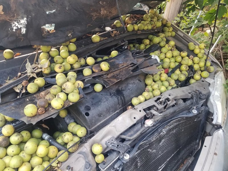

    It occurred to me that I never shared the picture from last summer. My parents have a butternut tree in their yard, and the squirrels filled the engine bay of this van with butternuts while it sat there:
    2022-02-16_07-34-36

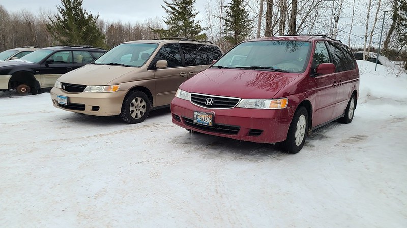

    Misfire came back. It was throwing P0300 and P1399 (multiple misfires) as well as 3-5 individual cylinder codes. After testing anything I could think of that would cause random multiple misfires (fuel pressure, cleaned EGR ports, blocked off the EGR valve, etc.), I read a post saying that these ECUs cannot accurately tell which/how many cylinders are misfiring. So I started unplugging coils and testing. Sure enough, only one cylinder was dead. Swapped the coil with the adjacent, and the symptom followed. New coil, and it's been running great for more than a week.

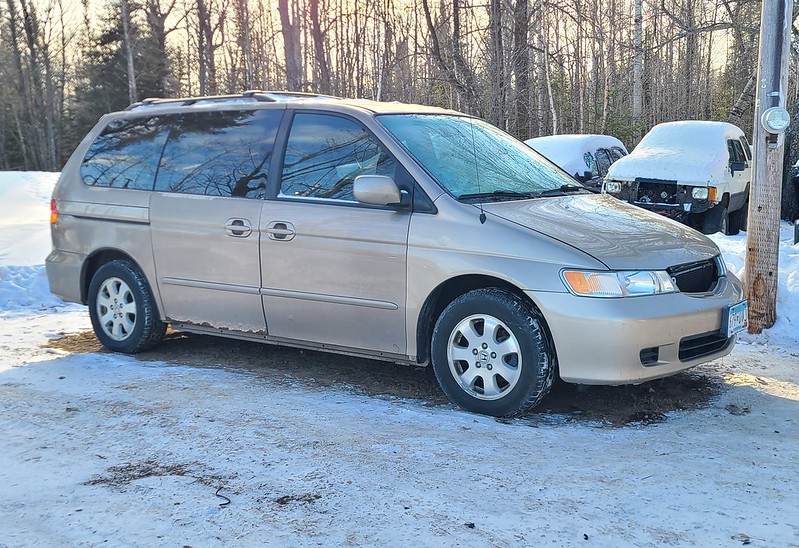

    My dad was up last weekend in his "new" van. I couldn't help but take a picture of them side-by-side.
    2022-03-07_12-55-29

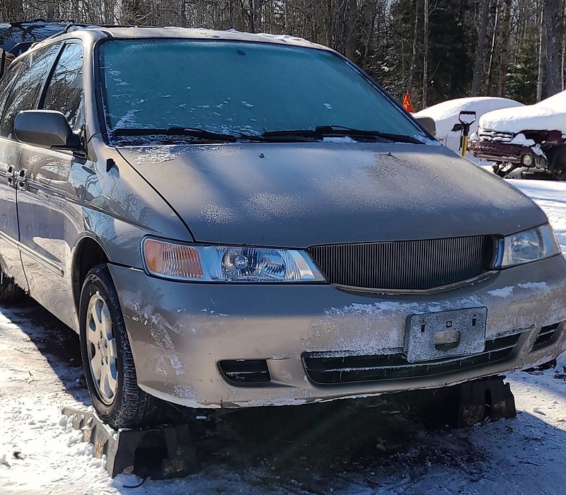

    But, I finally put the finishing cosmetic touch on it. the grill:
    2022-04-10_06-31-16
    Looks so good!
