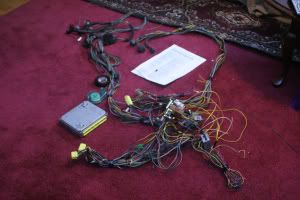

neat! If you haven't heard.....I just recently got another EJ22T....with harness/ECU.......stuff....crossmember....stuff.... from our local U-pull-R-parts. Complete swap for under $200.....hahah ...progress...
