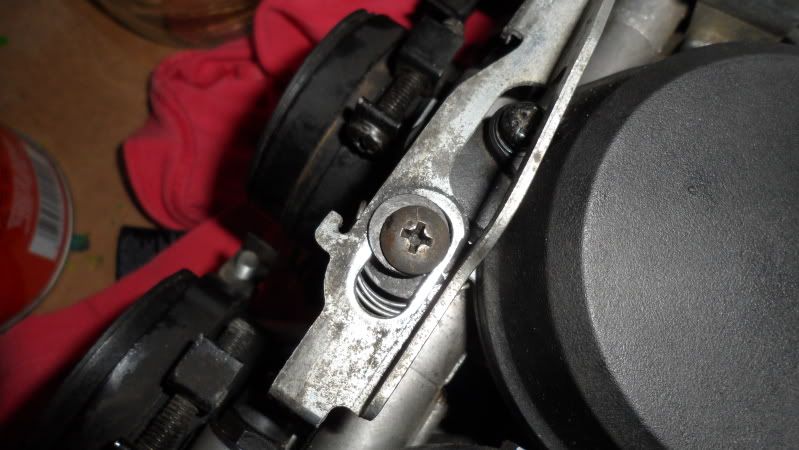

    Does anyone know how to put this spring back on for the choke plate?

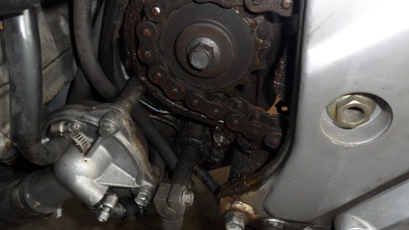

    Also I took the chain cover off from the front bracket and saw this mess.
    Can I clean this with engine degrease or should I just leave it alone?
    Any help would be appreciated!

    Wow, how long have you had this bike?
    The spring I have no idea about, I cant tell what is supposed to be what there.
    On the sprocket, lot of rust there, that chain isn't doing you any favors.
    Yes clean the snot out of that area, you're going to have to use something pretty strong like gasoline. That chain lube is sticky stuff.
    It looks like there is an oil leak and you can only find that once the area is really clean, oil creeps and blows around on bikes.
    I would also check your chain, the real way to check it is to try and pull it away from the rear sprocket.
    If you're facing the sprocket try to pull the chain away at the 3 o'clock position. If it pull off more than a half way your chain is toast.

    Thanks for the help Black_Peter! I'll go grab some engine foam cleaner and try that later on after work. Has anyone tried the pickle chain cleaner? I remember reading it somewhere.

    You probably want to get a new chain, and since you do, spray the HELL out of that area with brake or throttle body cleaner. as for the spring, I dont know what it used to look like so I cant help you much in that area.

    Looks good! glad to hear its running smooth. AWD is right about the chain. Chain's are really expensive, and its better to replace it than to spend time trying to nurse a bad one. Links that rusted on a chain that is probably past due on replacement...get a new one. HORROR stories of guys waiting too long and links busting under strain. Old CBR chains should be a dime a dozen anyhow
