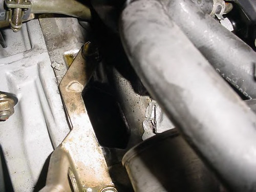

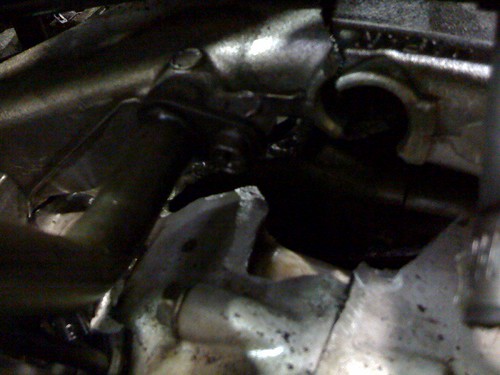

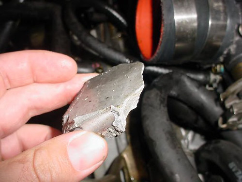

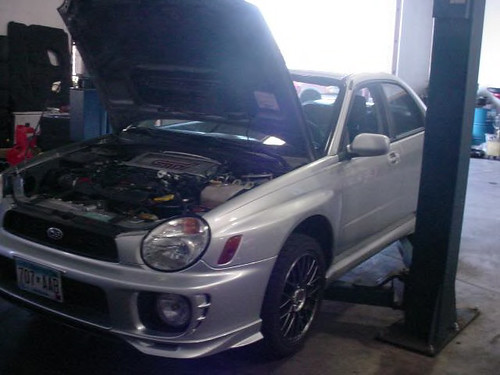

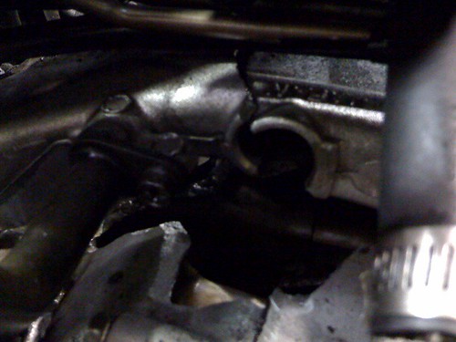

    Well it looks like the engine seized, then a rod blew and went out the of the short block. Not sure which one, Danny just said I'm missing a rod on the crank.
    at DB
    apparently my oil air separator isn't working very well.
    the damage
    The good news is even though Progressive isn't paying for anything, their not leaving me dry either, they are paying for the long tow up to DB, which is nice, and they took care of the rental up to today.

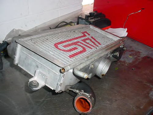

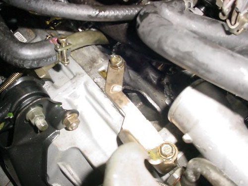

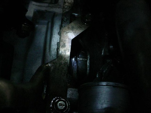

    I finally had a chance to drive up and look under the hood. The hole is right underneath the throttle body, had to take the intercooler off to actually see it. It's huge! Very impressive in person, at least to me anyway. This should give me a chance to tear into the whole blown engine, which should be fun. Good learning experience and all.
    Still not sure what's going to happen with the turbo, I have no money to get the one I want plus change my whole fuel system again. However, I need to make sure the one I have is good to go,so at least have it checked out, if it's good it's good, if not, FP says they can rebuild it into a 68hta. Still probably max out my injectors on e85, but it would be nice to have a solid 300whp.
  25. blake
    blake Well-Known Member
    Engines out, better pics.
