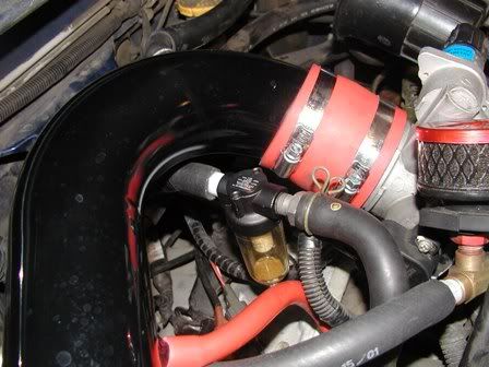

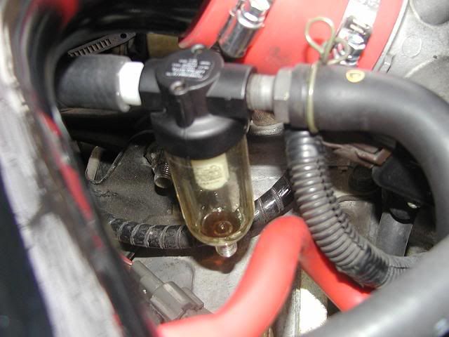

    <u>Update:</u> I took this picture after a ~60 mile round trip to the Speedlab meet today. I only went WOT once in third gear; the rest of the drive was no more than 50% WOT. It seems that I may have to empty this jar once every oil change. :eek:

    is that made of glass?
  8. kickin_81
    kickin_81 Well-Known Member
    4,465
    32
    St. Paul
    No, thick plastic. On the plus side, it's designed to hold over 90 psi for air tools like an impact wrench. On the negative side, it is only tested to handle 150 degrees. I'll keep my hood vent open to keep the engine bay temps down.

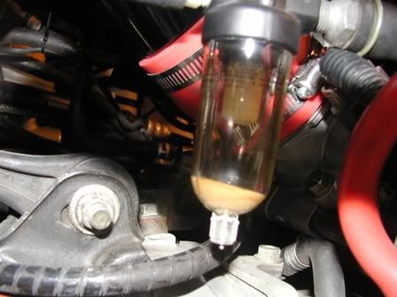

    Update:
    Ewwwww! It's been only 4 days and look at the crap I saved from going into my combustion chambers. :eek:
    What the h*ll is this cappuccino-like liquid in my oil catch jar? }:)

    <blockquote id="quote"><font size="1" face="Verdana, Arial, Helvetica" id="quote">quote:<hr height="1" noshade id="quote">Originally posted by kickin_81
    Update:
    <hr height="1" noshade id="quote"></blockquote id="quote"></font id="quote">
    Ignorance WAS bliss; but now you know the truth... the truth of whats really going on in your PCV system! Most ppl driving their Subarus this winter has that same crap in ther PCV hoses; they just don't know it :p
    That is oil and water mixing. Condensation from the temperature changes forms, then that water mixes with oil, and now you get a nice mayonaise solution in your oil and PCV system.
    Thankfully now your catch can is gathering up most of it before it makes its way back into your oil or down your intake. An oil change over to Mobile 1 will help also.
    This is why I suggested this mod to everyone :)

    Herc, although it looks like cappuchinno, I don't think any liquids from my car contains caffeine. LOL! Hey, where does sulfer come from? The engine oil?
    Morgan, thanks for the tip. That's what I figured it was but was unsure. I use Amsoil and I'm a believer of its use as my engine oil. Do you figure this stuff is a byproduct of Amsoil? Maybe this thread can help others decide on what to buy/do with their tax returns. :)
    It is not a byproduct of Amsoil. If anything that's prolly helping you more than you know :) In 4 days I prolly would have almost filled that little bottle up [xx(] I only use Castrol GTX and just vent my PCV system to one of those breather filters; I then pulled out the PCV valve and replaced it with an extra bolt I had.
    This is why I said yours was a very clean install! LOL Mine just squirts that junk out the breather filter and down onto the main crossmember :p Think I'll have to upgrade to this soon! :mrgreen:

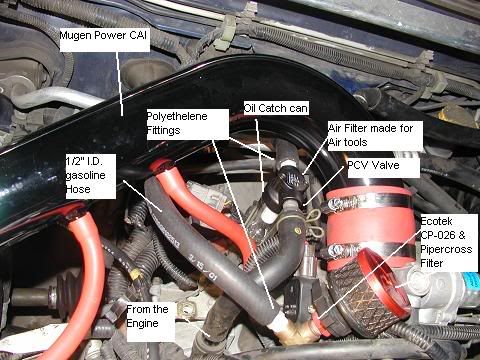

    Ok, there has been some interest in this modification. I'll post what is needed to make this for yourself. There are many approaches that can be taken to safely and cleanly install this oil catch can.
    <u>Notes</u>
    *The PCV hose inner-diameter size is either 5/8" or 3/4" (I found out 1/2" didn't fit until I was in the middle of the install)
    *The PCV valve has a flared end that fits into the PCV hose and the other end is a threaded 3/8" male
    *The PCV valve's air flow is directional, so use the arrow on it to direct your install before you tighten anything down
    *The PCV hose (after unplugged only from PCV valve) can be rotated for adjustment
    *The air/water seperator comes with two female threaded holes and can have the PCV valve's male screwed into it
    *I recommend you get everything in place and tightened before you slip the hose over the fittings for ease of tightening.
    Below is the instructions on my install (remember, you can use your own method and parts to acheive the same result)
    This what you'll need based on the picture:
    1 each - air filter/water seperator [Menard's or equivalent]
    2 each - brass or polyethelene fittings (1/2" barbed; 3/8" threaded) [Hank's Hardware; maybe Menard's or Home Depot; not Ace Hardware]
    1 roll - thread seal tape (optional) [Any hardware store]
    2 feet - 1/2" gasoline/air hose (you can cut any extra length off that you don't need) [Checkers or equivalent]
    Connection Procedure: motor-->OEM 2" hose-->OEM splitter for PCV hose and air line-->PCV hose-->PCV valve-->air/water seperator-->fitting-->your length of 1/2" hose-->barbed end of fitting-->threaded male into intake manifold...
    ...Wash your hands. Pop open a can of ice cold beer and drink. (minors: drink juice or pop instead) ;)

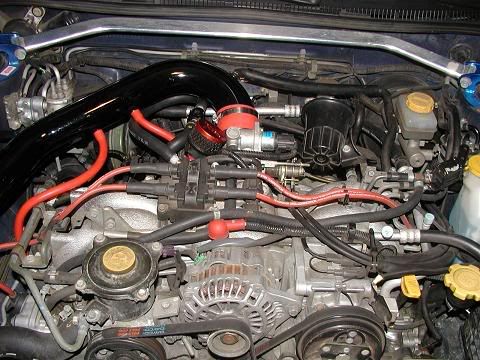

    That's great! I would like to see it installed and how well it works on your Subaru, Morgan. You sure you can find room to install this in your engine bay? ;)
    I took the spare tire out from under the hood.... PLENTY of room LOL :cool:

    so the subaru hoses are 1/2" or 3/8"?
  26. kickin_81
    4,465
    32
    St. Paul
    The 1/2" barbed end of the fittings is too small for the (OEM) PCV hose. If you want to have the air line to be the same inner diameter as the (OEM) PCV hose, instead, you will have to get two fittings that are 3/8" threaded male and 5/8" [or 3/4" because I don't know the exact size] barbed male and a hose that the bigger sized barbed male ends will fit into.
    These sizes are for the RS motor, but I assume all EJ series motors uses the same PCV hose size.
