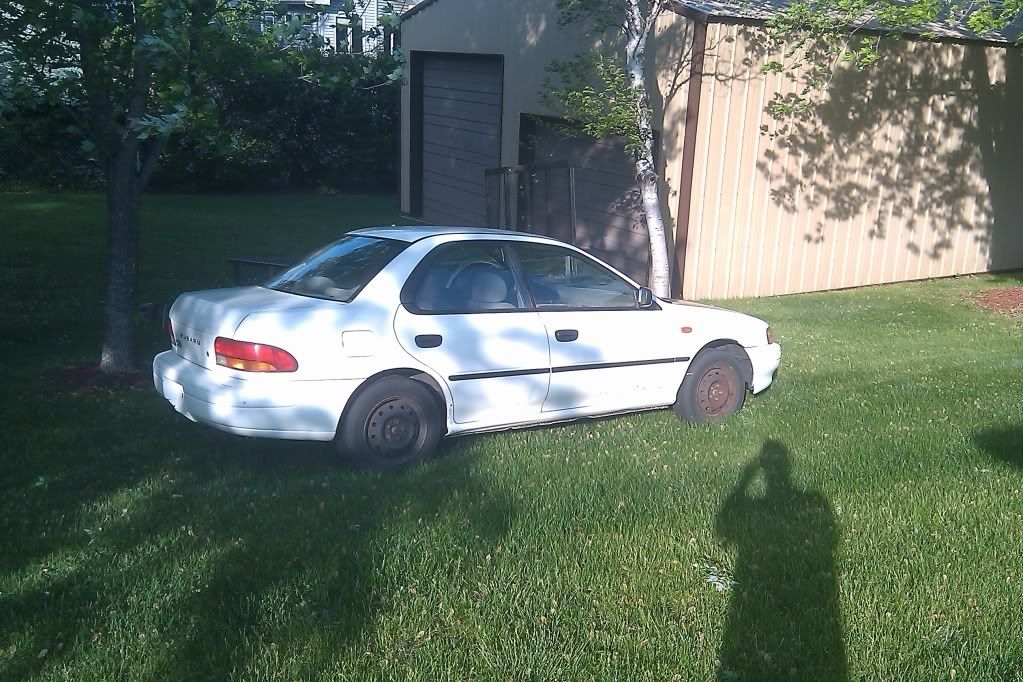

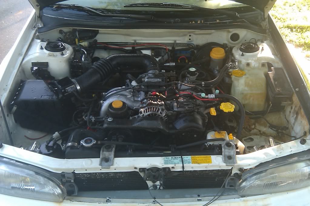

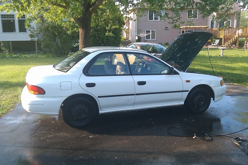

    I found a great old friend I'd lost contact with and after talking about cars for a while he said he had an Impreza I could have for free. Being that I'm a huge Subaru fan but never even owned one, I had to take him up on the offer. It's ugly but it's mine and it's a Subaru!
    Needs: EJ22 rebuilt or replaced (crank bearings burned up, I think), bumper, hood, front left fender, grill, core support, front left turn signal, a lot of body work, and a manual transmission conversion.

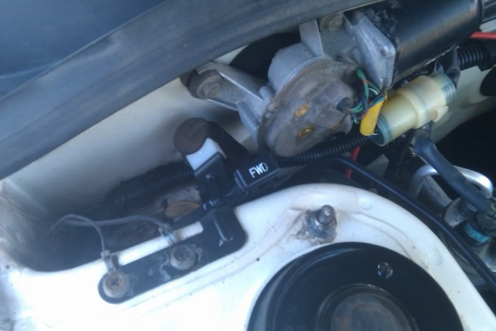

    I noticed the "FWD" fuse block up on the top left corner of the engine bay, I've been reading that will make the auto run in just FWD mode. That's pretty interesting, I'll be doing a lot of research, and maybe this will be a nice car for the track someday when I've got some more money!!:biggrin:

    You are correct to a point that the FWD use will make the car FWD. That fuse is supposed to be used in the event that you get a flat tire or other event where you do not want the rear wheels connected to the driveline. By putting the fuse in the holder it will supply power (or is it disconnect power, I forget which) to the center clutch pack essentially making the car front wheel drive. The manual says to go only a very short distance like this. There is speculation whether the clutch pack is fully disengaged or is just "slipping" if it is just slipping it would result in increased where on the clutch plates. enough talk about techy stuff though.

  17. AWDimprezaL
    Did you check to see what style heads are on your donor motor? You may be looking for a different exhaust manifold if the new motor has dual port, as the 2.2 in your car is a single port engine.

    Yeah the replacement motor is from a 96 as well, and it has single exhaust ports. (I didn't think of that but it would have been a good idea before I went and picked the engine up LOL :))
