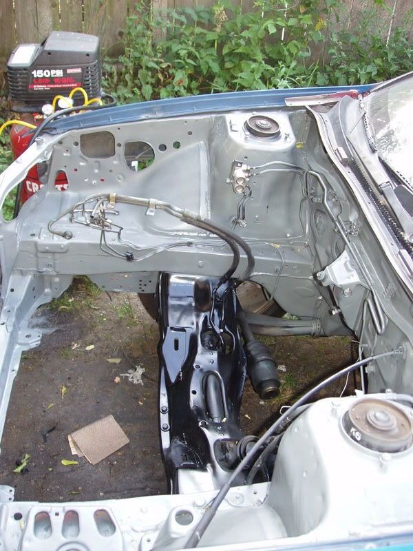

    ^ i was going to paint it but i did half of the engine bay by using fine sandpaper and wetsanding, and it turned out pretty damn good, so i'm gonna finish the rest and throw up some pics :biggrin:
  14. 95lwrx
    95lwrx Well-Known Member
    well not as good as painting but it's plenty good for me since my car is far from a show car, lol :biggrin: and all of the sound deadening inside the car is removed

    well now i'm done with my piddly stuff before my car gets here, got the sound deadening gone and just decided to throw on some paint just to seal things up( yes i lol'd at the two tone but i didn't have enough paint of one color) :biggrin:
