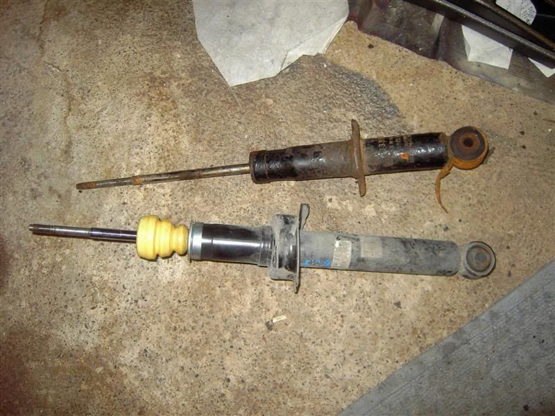

    well, a couple weeks ago, I bought these '99 miata fronts.... and today I finally started taking them apart.....here's what I found.
    comparable length to the EA82, and substantially longer shock body (substantially less travel). so these aren't a very good option if lowering is high on your list of priorities.....but should work fine from a performance standpoint. I also just saw a post mentioning flipping the upper bracket upside-down for a small drop....

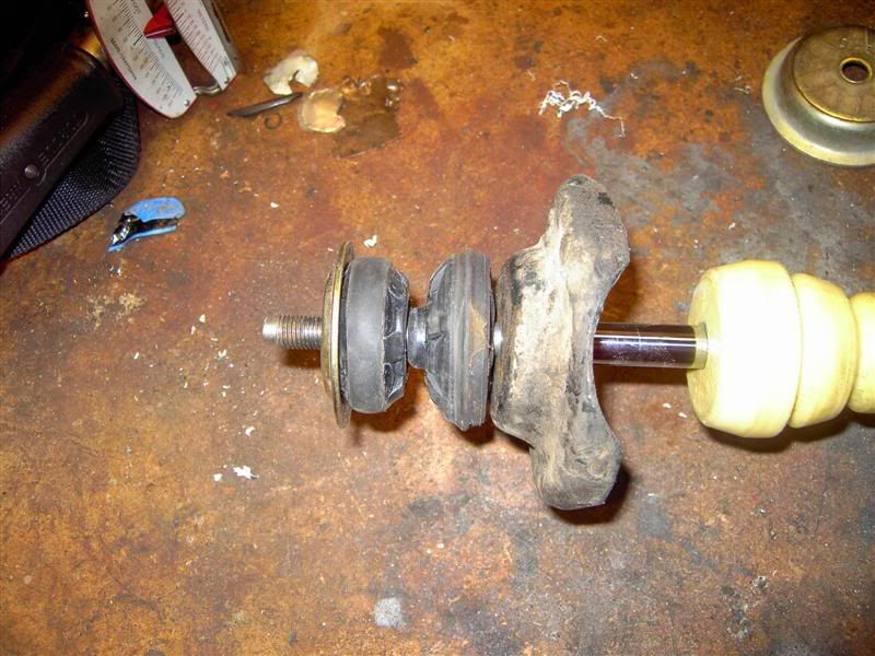

    the NB miatas ('98?-'05 I believe) have a bushing in the upper mount much like the EA82s:
    so I think these will work a bit better with the EA82 upper mounts then the NA ones.

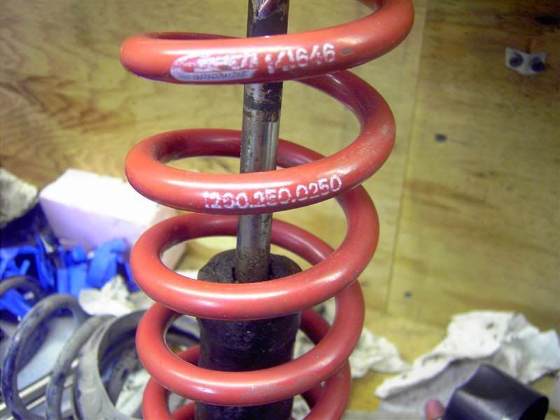

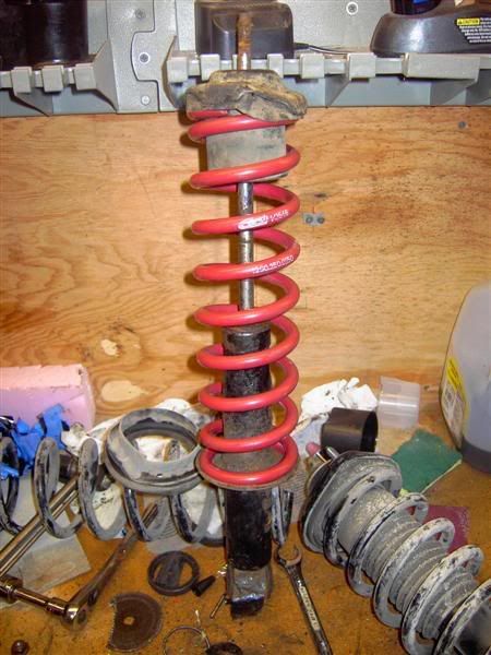

    I got a nice deal on a pair of 1200.250.0250 Eibach/Ground-Control springs (12" long, 2.5" ID, 250 lb/in) on ebay:

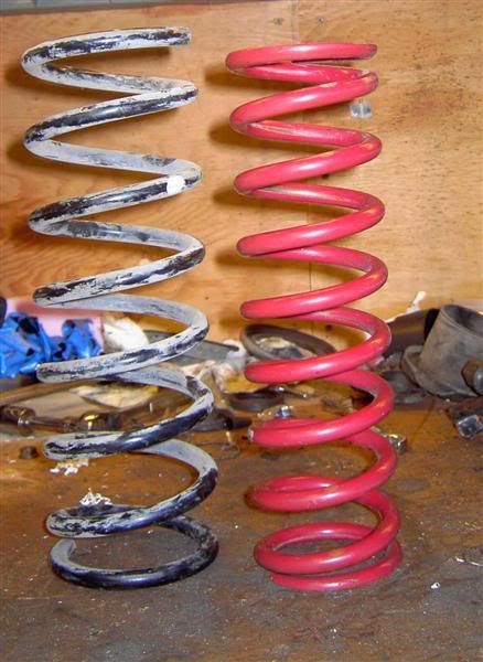

    these are very close to stock EA82 springs in dimensions (in fact....could make for a decent upgrade for EA82s....). Here on the EA82 shock):
    and similar height to the stock miata ones:

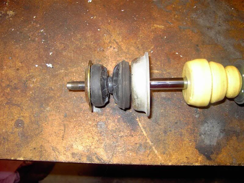

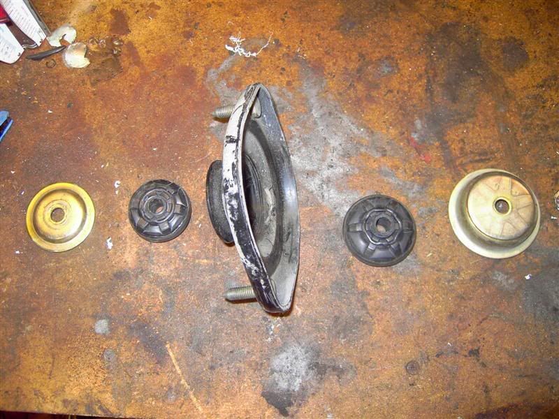

    the miata upper bushings go on like this:
    replace the lower washer (won't fit inside the 2.5" spring) with the EA82 spring perch:
    and stick the upper bracket (only ones I have are currently mounted on my car :-\ so not test-fitting) in that bushing, and I'll be hot to go.
    stock spring rates are 143 front and 196 rear. new setup will use stock WRX fronts (163) and these 250 rears. should make for a nice step up without sacrificing ride quality (can't say the same about these 400/450 lb/in sleeves!)
